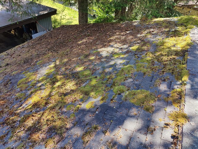

Ended up doing a car port, garage, and house roof. Had so many bags of debris I couldn’t fit them all and had to bring my pickup to take away the rest.
4.5 hours and collected my check.

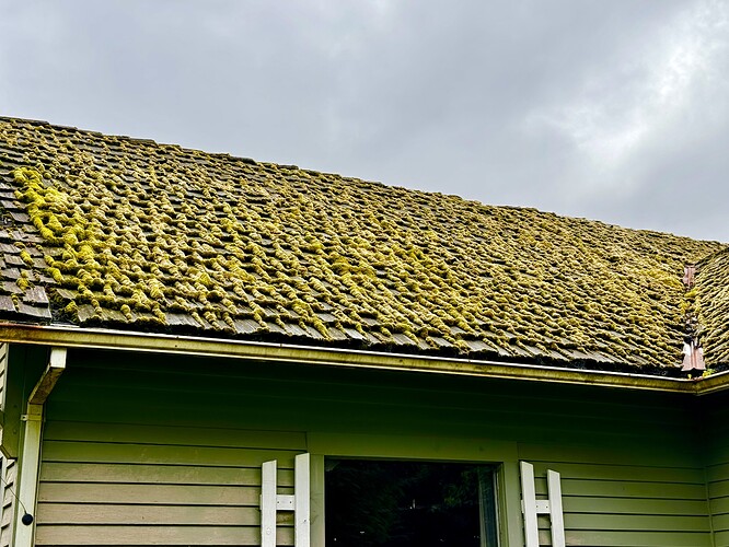

Some work in progress. Came back to check on this one and she seems to be coming along nicely. I was in a bit of a hurry so will take some after pics later on in the year. Blew everything off for the customer and re applied so will have a good collage of green to clean soon!
As usual I probably underbid for this. The guy wanted his back half of the roof treated, and the front just blown off and rinsed. I explained to him he would probably want the front to be done as well to make it uniformly clean but he didn’t want to pay for that. He was a bit grumbly about the front not looking as good but everything was discussed beforehand and he wanted to save cash.

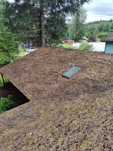

New roof time- if I cleaned this one I would be into the trusses in no time.
