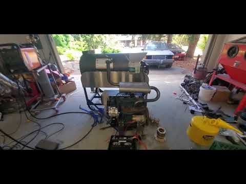

Changed plans a little, leaving the truck out of the equation, throwing a 40-50 aux tank in between the cab and buffer tank to run the burner and engine. Can’t wait!!! Just need to get this little beast off the milk crate and up in a truck now.

Got the exhaust and engine mounts fabbed today. Still waiting on the radiator to come and my truck to get out of the shop with the new turbo before I can build the frame and start mounting things.
I’m going to fab up 4 jacks like a travel trailer to get it in and out when needed. I’ll post pics of that later.
Burner is in, the thing’s a beast, seems like largo did a great job so far.
Overall, I’m extremely happy with the noise level and simplicity of this thing. It’s required a ton of fab, but that’s what I like. ![]()
Hope to see some more diesel setups out there someday, I’m definitely doing every build with one from now on when I expand.

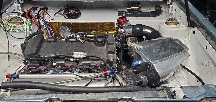

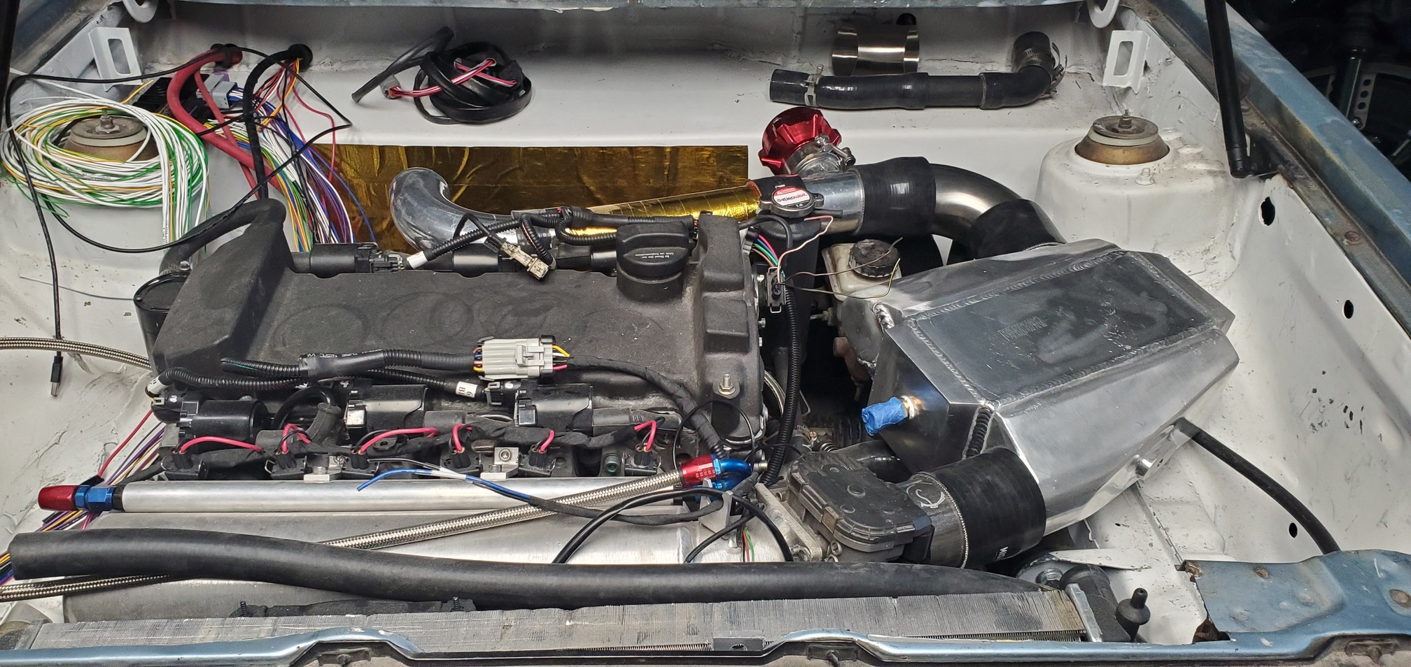

Yup! 84, 3L VR6 turbo going in the back as a mid engine.
Here’s a kinda recent shot of what in the front, decided to change directions and use that red Jetta in the back for the subframe and stick all of that in the back.
Nice! I figured you were a water cooled VW guy with the other ones parked in the driveway
Ya, die hard VW guy, have air cooled too, but mostly water.

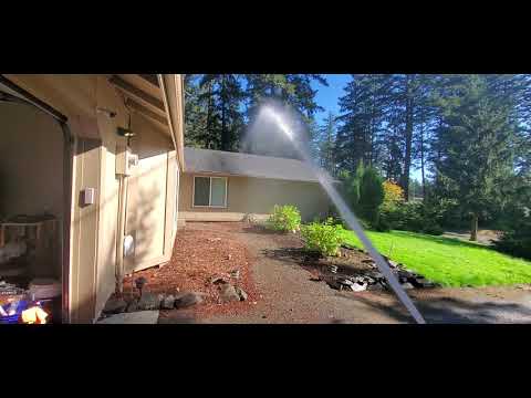

FINALLY got the trailer and truck back, got some stuff bolted down, etc… first shakedown run! Still need to wrap up the wiring, the 12v system, downstream stuff, etc… but she’s spraying water!
You guys were invaluable, this site was my main source of info… can’t offer enough thanks. ![]()
Your getting some good distance, neat build
