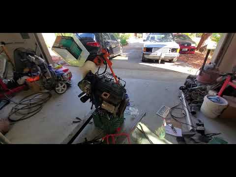

She's alive!
Started the build officially, I know it’s not typical, but nothing I do usually is. :joy:
Please ignore that nasty old Costco “pressure washer” in the corner.
Kubota v1405, strong runner, going in the back of my truck. Gotta fab the frame next when the hotbox gets here. Anyone else running all diesel? Planning to share tanks between the truck, Kubota, and burner.
