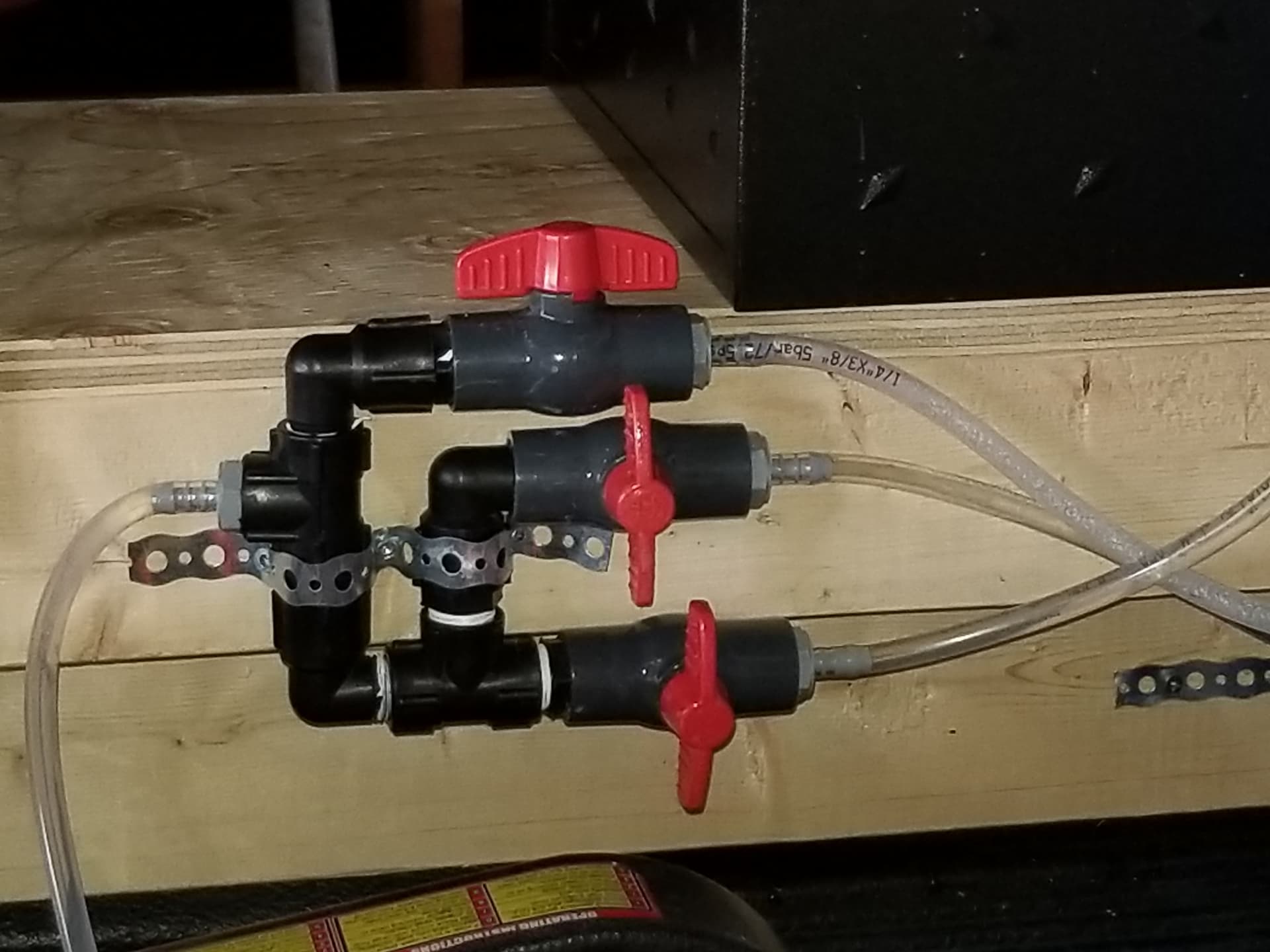

Avert your eyes if wooden skids offend you…
I was limited by what was locally available - couldn’t even get my hands on a 1/2" cross. The only place I’ve found the 1/4 3 ways available in Canada is through Grainger and they want $50 + shipping per. Top line goes to water, middle to soap/whatever I want, bottom to SH. Waiting a bag of 1/4 check valves so I can have water and SH open at the same time.
Haven’t done a draw test, except that it pulls enough SH and soap to wash dirty siding :slight_smile: .
We’ll see how long these ball valves last since they’re not really getting flushed.
