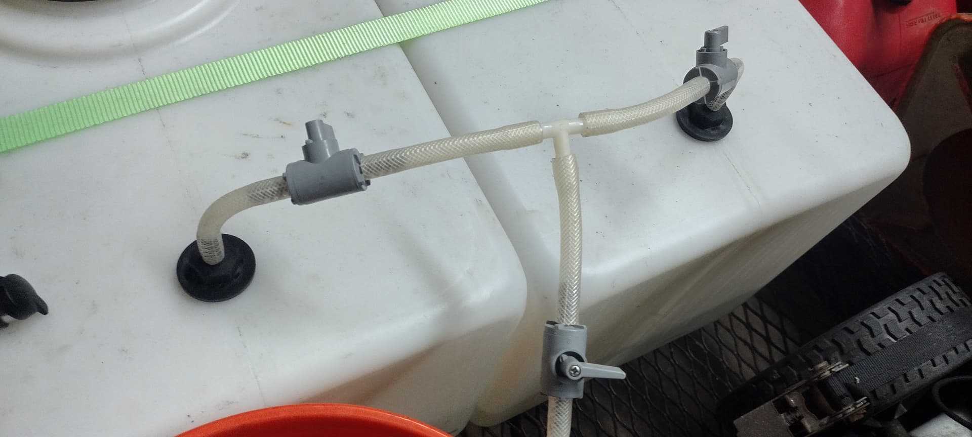

Ok now I need a pic of that setup lol
me too
I’m using the same 2 way on / off poly ball valves from 2 years ago. It can pull straight water, straight SH or anything in between. I’ve eliminated the bottom ball valve as it isn’t needed. Both valves wide open will pull 2 parts water & one part SH. Add in a little dwell time & a milder solution will go a long way. I used 5 gallons total today, 2 2 story vinyl houses & a composite deck. Injectors last a lot longer when you’re downstreaming water during the rinse cycle. It’s changed up a bit since this old photo but same basic configuration.
Good stuff! I always wondered, are the 3 way valves both on or both off when in the middle?
Almost. Them still pull a little bit from both sides sometimes though. I have it on soap or water though.
Good to know! I ended up moving the Tee so the 90 was on the water side to have the shortest, straightest flow to the injector from the SH side. The inline check valve was necessary to keep SH from back siphoning into the buffer tank. It works well & I’m a huge fan of simplicity.
