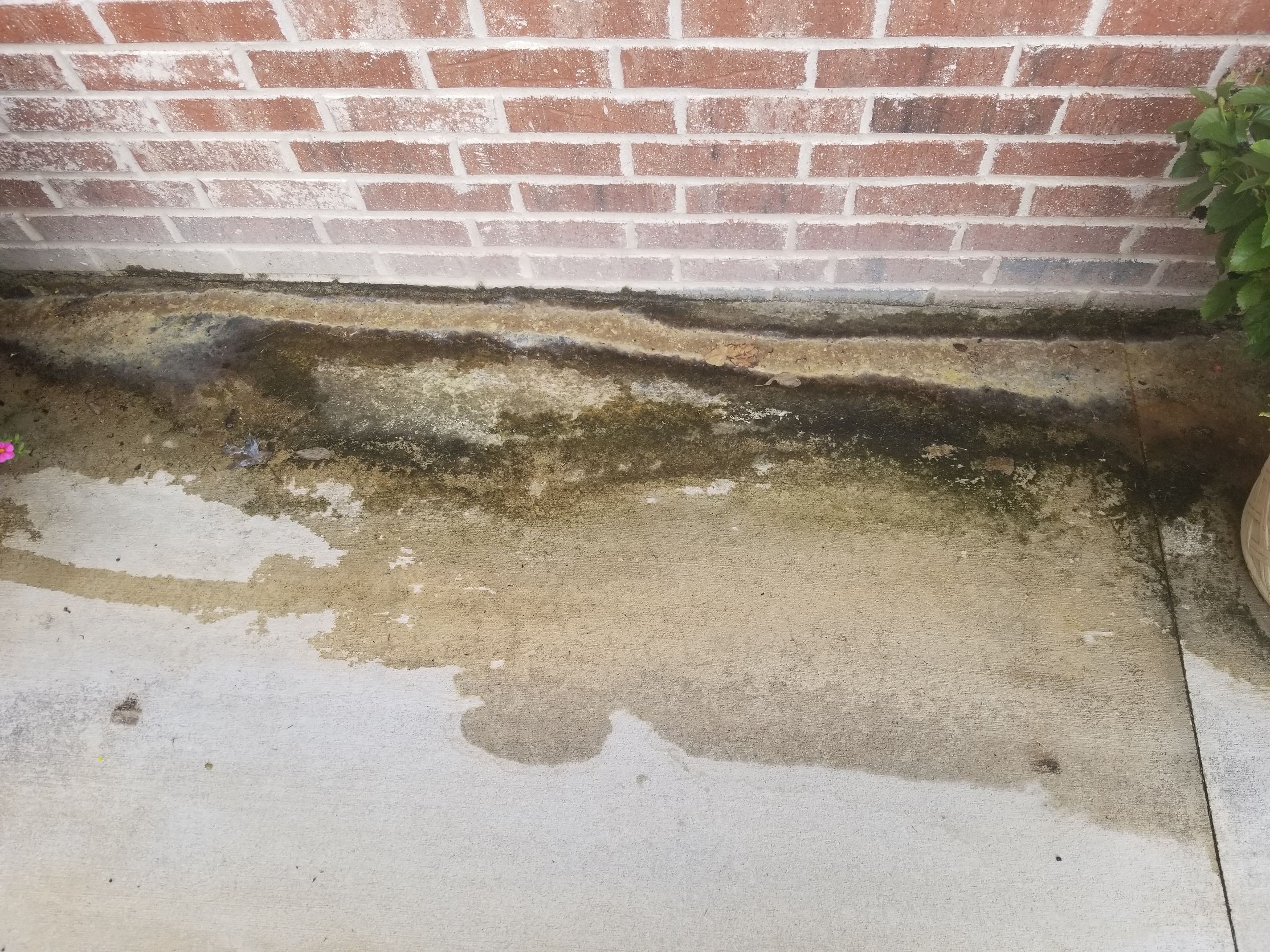

Hmm. Pricing is finicky and I’ve never done rust removal to that scale. I know @squidskc has and I think @SchertzServicesLLC did something big like that too. I could be wrong though. Here’s one I have to do on Saturday. It’s not so much rust but along the same lines.
