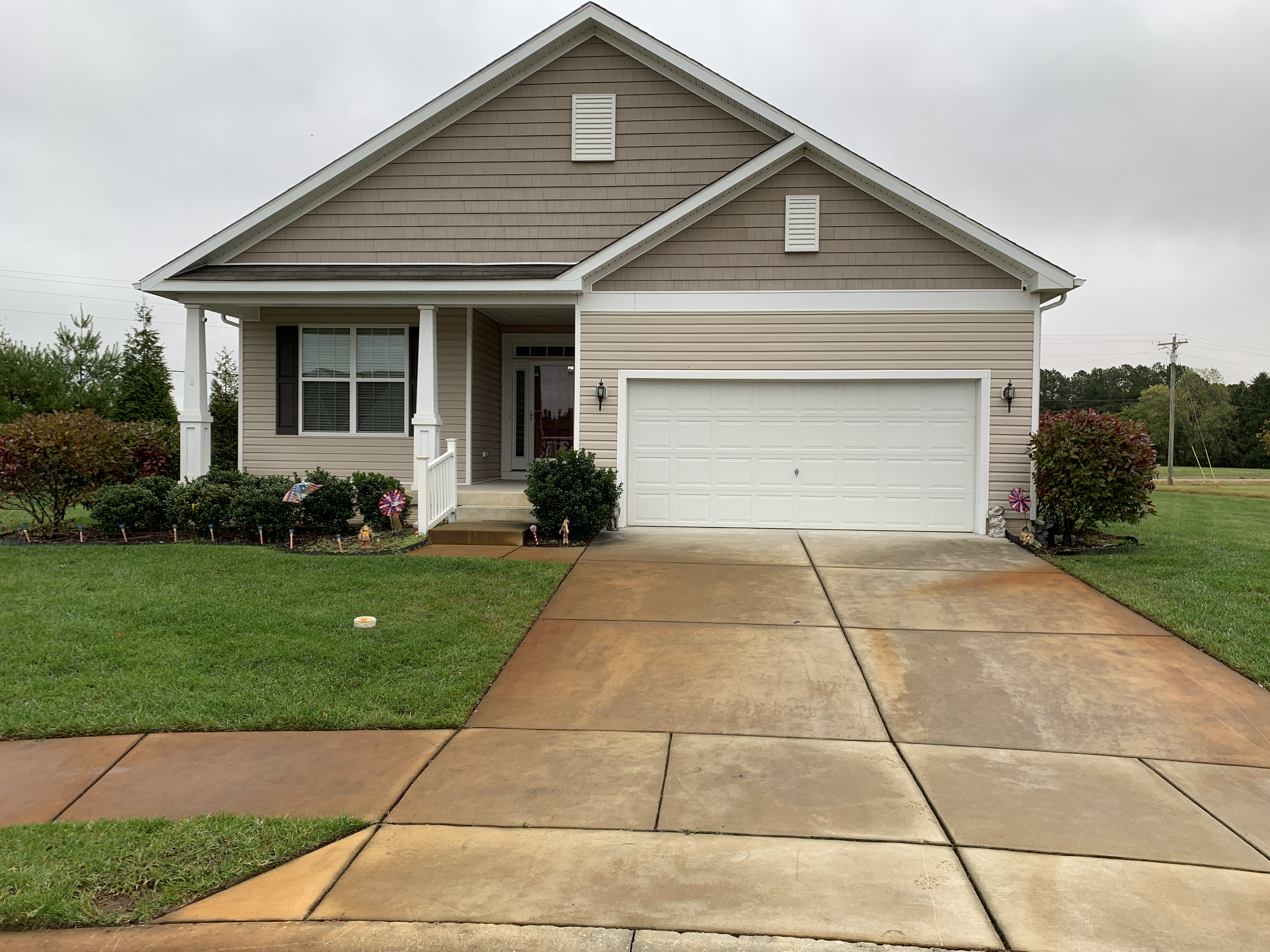

Where’s it coming from? There’s a neighborhood that we do a lot of work in that is plagued with rust at 90% of the homes driveway. Something in the soil caused it and removing it is only temporary. At least in this situation it comes back rather quickly as it’s from bottom up. Looks similar
It’s fertilizer most likely and running off
It’s irrigation rust 5 years worth

Have a lot of concrete like that here in Central Florida, all from irrigation.
It’s all over the siding Also.

It comes from the hard pan fill that is loaded full of iron, homeowners watering daily saturates the topsoil & runs on top of hard pan & leaches the iron out of it. Or it could be from the irrigation water looking at the pic you can see the spray patterns
