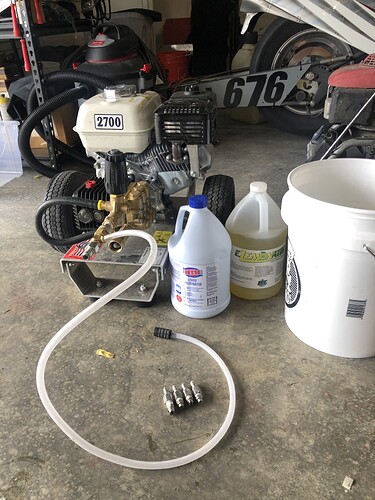

I recently purchased my new pressure washer. 2700 psi and 3 gpm! It came with a chemical injector, I have a 5 gallon bucket, 10% SH, elemonator, and a Jrod. I’m curious to know if it’s safe to run SH through the chemical injector. Only asking since I’ve heard a lot of people saying to not run bleach or SH through your pressure washer! I attached a few pictures
You’re good to go.
Just use your DS chemical injector line that’s laying on the floor and you’re fine.

You should not run SH ‘through’ your machine. In other words, you should NOT have a supply tank or SH injector BEFORE the pump. There’s just lots of parts inside the machine that don’t do well with SH and it will increase the likelihood of pump failure.
The alternative is to run the SH ‘after’ your machine, instead of through it. That little “T-shaped doohickey with the clear-ish hose” that you’ve connected after your pump is a Hi-draw Downstream Injector, and is the perfect way to add chemicals to your mix.
At lower PSI and flow, the injector will inject 1 part of whatever is in the bucket it is connected to, into about 5-10 parts of water flowing through your pump. As mentioned above, you can do an injector test to see how much your injector is drawing.

Hot Tip #1: to keep the injector intake at the bottom of your supply bucket put some weight on it, or route it through a section of PVC pipe so that it stays straight in the bucket.
Hot tip #2: Once you are done using the downstream injector, put the intake in a bucket of clean water to rinse out the inside, which will make it last longer.
Hot tip #3: Buy a spare injector… that one will break in the middle of your most important job. (You don’t have to buy the whole kit. Just the brass injector part.)
Hot tip #4: the injector reduces flow. When you aren’t actively using it, remove it from your setup to maximize flow.
