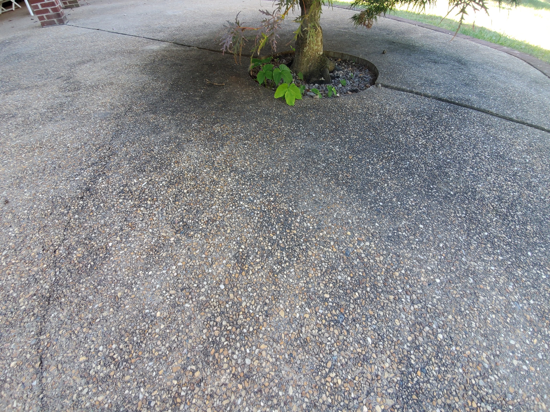

The house is 40 years old, this concrete has not been cleaned in forever I am sure. I have a surface cleaner, but what would be recommendations here? I have not seen this in any discussions I have read, it is really textured. I can go back anytime and do test spots if needed. Thanks!
Just clean it. Take before and afters. They’re going to be awesome.
Pre and Post treat the surface and collect the check easy money there!
Watch your treatment around that tree though keep the mulch soaked with water.
It’s exposed aggregate. There should be lots of info on here about it.
There is. Lots. My favorite before and after photos are usually exposed aggregate. They just look so nice when they’re clean.
As @sgb said, just clean it. Might help to do a good pretreat, but that should clean up nice.
Thats going to turn out great. I would go slower than normal or just go over each line twice. I love doing patios like that your going to blow the customers mind.
Those are the best, my favorite.
Exposed aggregate is a pain to rinse so plan on doing smaller than usual sections and then rinse and go to the next section. If you do too large an area at a time it is bad for the dirt settling back in to it.
You might want to try rinsing with a white green or yellow nozzle, at least for me it’s much faster than the ball valve.
Agreed, I seldom use the ball valve. It’s quick but not my style from a safety standpoint.
Nothing to it. If you pre and post treat just make sure when you rinse you push soap away from the tree you dont want it going in the tree well
