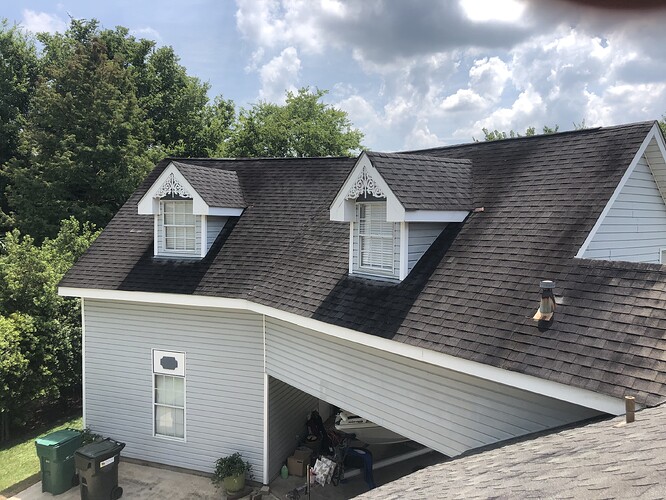

I’m in the process of cleaning g this roof and have some stubborn stains. I’ve treated it with 6% three times and it’s not even turning a lighter color. My first thought was that it’s sap but there are no trees near enough to cause this pattern. I scraped some up with my finger nail and it is not sticky. It’s mushy. The roof was black as seen in the first picture. If you look closely you can see the darker areas are the ones that will not come off. The second picture is a separate area of the roof that came out perfect today with the same mix. So I know it’s not my mix. Any suggestions? It looked better dirty tbh and that’s not good business. I’ve clean a lot of roofs and never ran into this.

Other sections did not have this goo. It almost looks like soot or fall out.

i understand that it looks like that in the pics but that’s not the case. I can scrap it with my finger nail and expose the granules underneath. I also used the m5ds to rinse it in one spot and it removed a good bit of whatever this is to expose the granule. It almost looks like some type of fallout or soot. I just used straight SH and it didn’t budge.

Thanks everyone for the suggestions. Upon looking closer to the surrounds houses, sheds, car covers and dormers it seems to be an environmental factor specific to the area. Probably some refinery or chemical plant near by. Beat me but the stuff is all over. It’s strange how it clumps together like this. Trusty curious. I explained it to the customer and fortunately he’s very understanding. Gave him a 40% discount. I’m over it. Been on a 3hr job all day. It’s hot as hell here today on top that black roof with a head cold. Need theraflu and rest.

If I remove the black substance(I did so in a small area with a m5ds) it reveals grey granules.

I explained it to the customer. Took off 40%. Collected payment. Luckily he was understanding. I asked him to keep me posted if he finds out any further info on the substance as I would like to identify it prior next time(hopefully no next time). I’d be hesitant to clean any roofs in this are as it’s on the neighbors homes with older roofs. It’s just a bit blacker then normal algae. You can identify it in the before pictures. I plan follow up with him in a few weeks.
