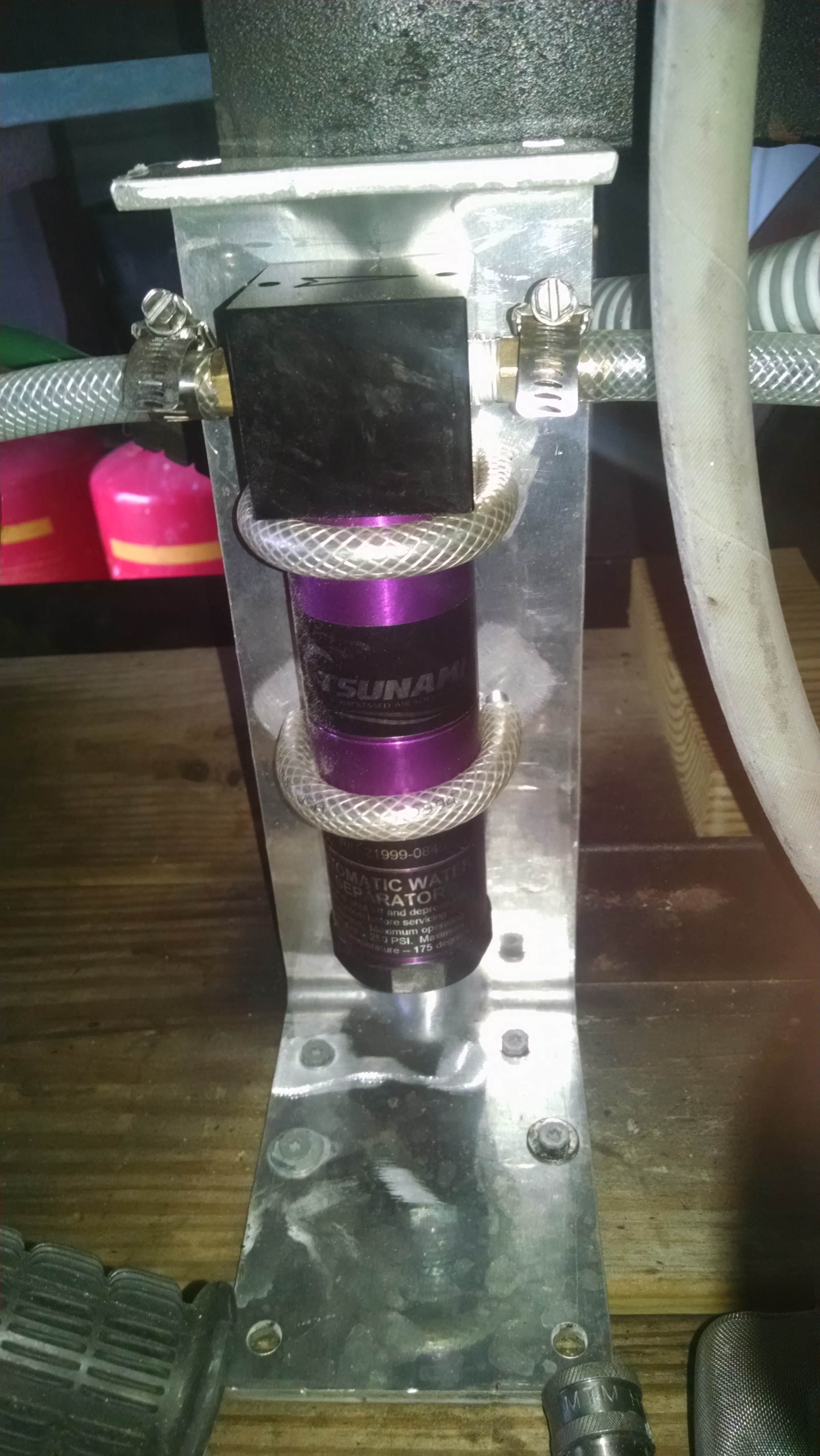

All you need is an air compressor and a aodd pump. Also a good water separator, the pumps don’t like moisture in the air line.

I use a water separator and a toilet paper filter. Go with 1/2 in when u get it going u will love it!!!
Hey man I got a quick question and I know you’re super knowledgeable with this air stuff! So these past couple days(central Florida, but it’s been cooler as you know) I’ve been having issues with my 1/2in all flo. It keeps stalling on me and then when I let off the gun for a bit, it starts going again. I was curious what type of water separator you use and where you put it on the air line? Right after compressor, middle of line, or right before pump?
My first thoughts are that I am having issues with too much moisture in the line. I am just hoping it isn’t something worse. Wanted your thoughts and input as maybe you have encountered this issue.

Moisture really is only an issue for corrosion. There is a metal shaft inside the pump.

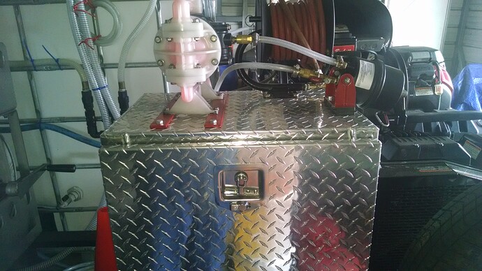

Spray some wd40 into the pumps air inlet will stop the stalling. I actually run oilers or foggers on my pumps use air tool oil. This stops all stalling. I’ll send you a picture if it
Thanks man! I called a place today and they told me my pump might be icing up and the ice crystals inside are stalling it. Told me I needed to buy a new water separator thing for like $100. This didn’t make sense to me though because when it stalled, I felt the pump and it wasn’t cold in the slightest way… some of these suppliers make me wonder sometimes…is it about helping us contractors or selling more product…

Would you mind posting that picture?
