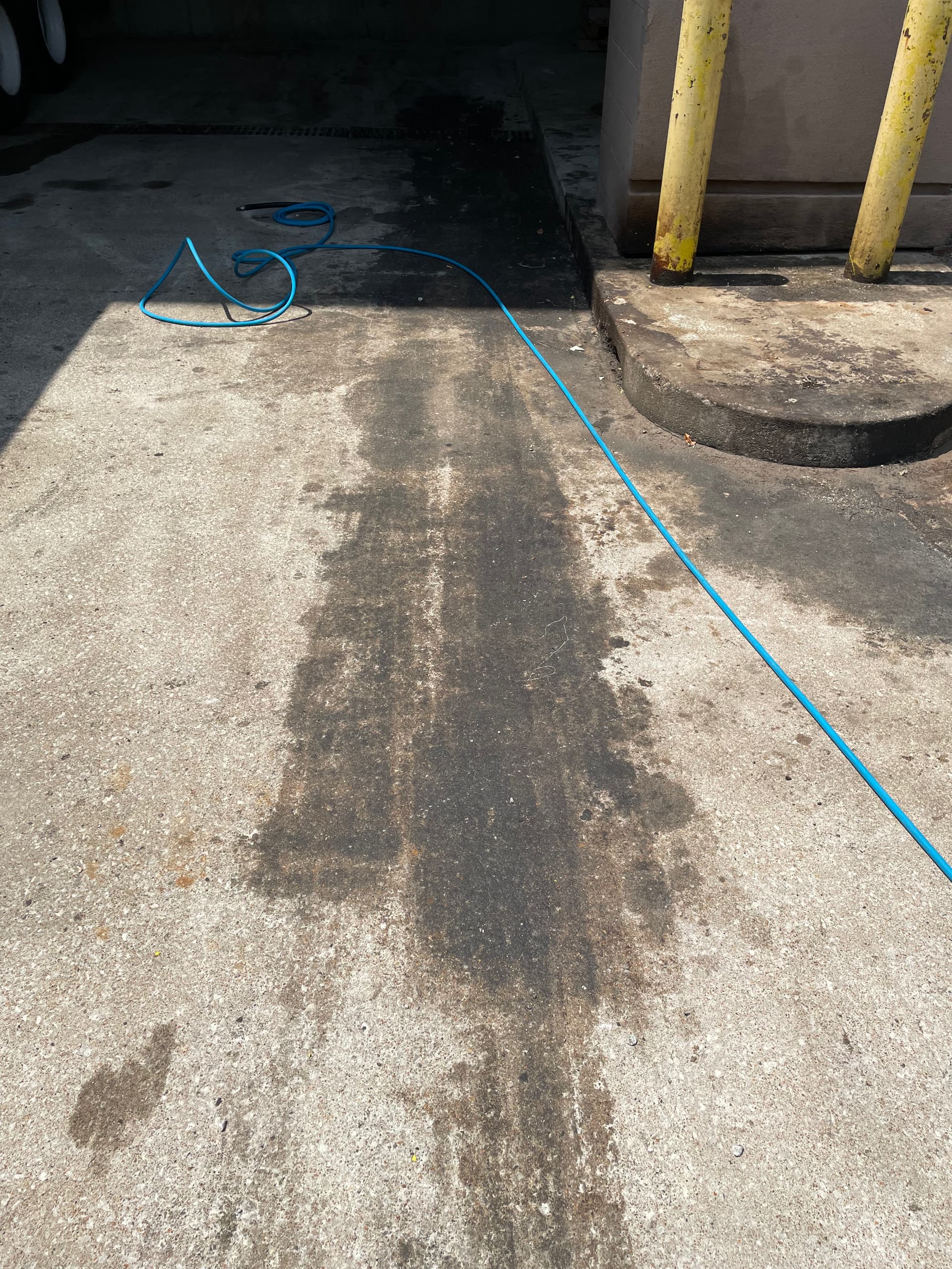

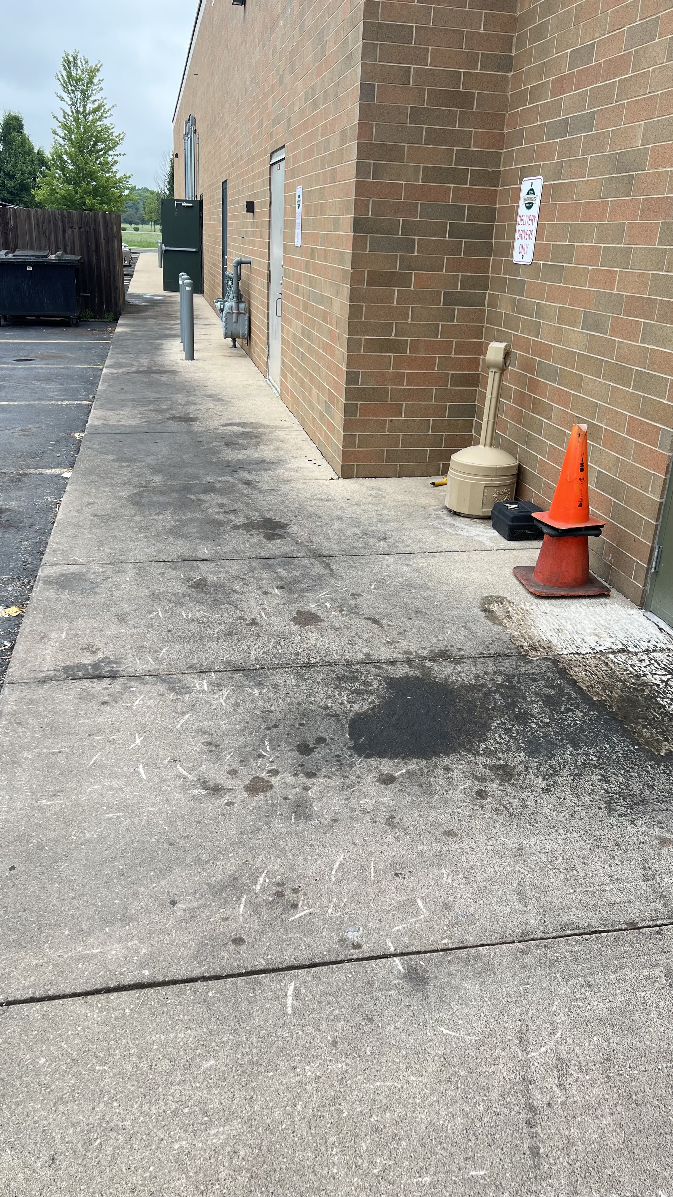

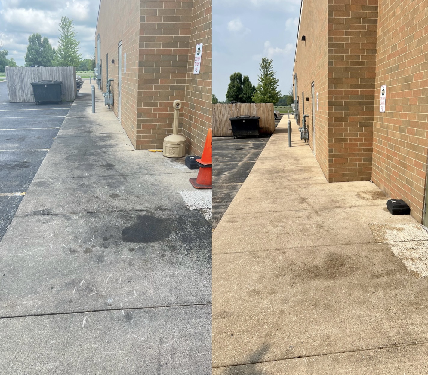

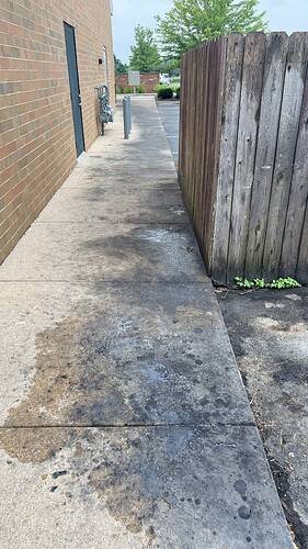

This is the back sidewalk of a restaurant. What do you think I should quote it at?

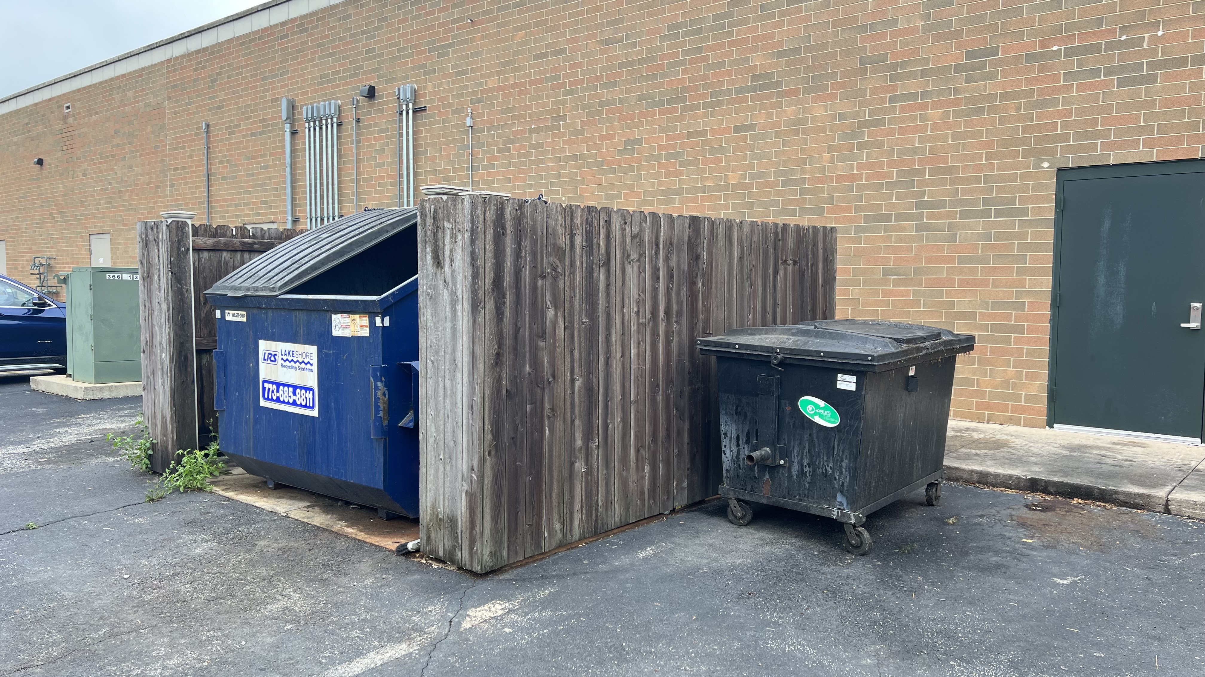

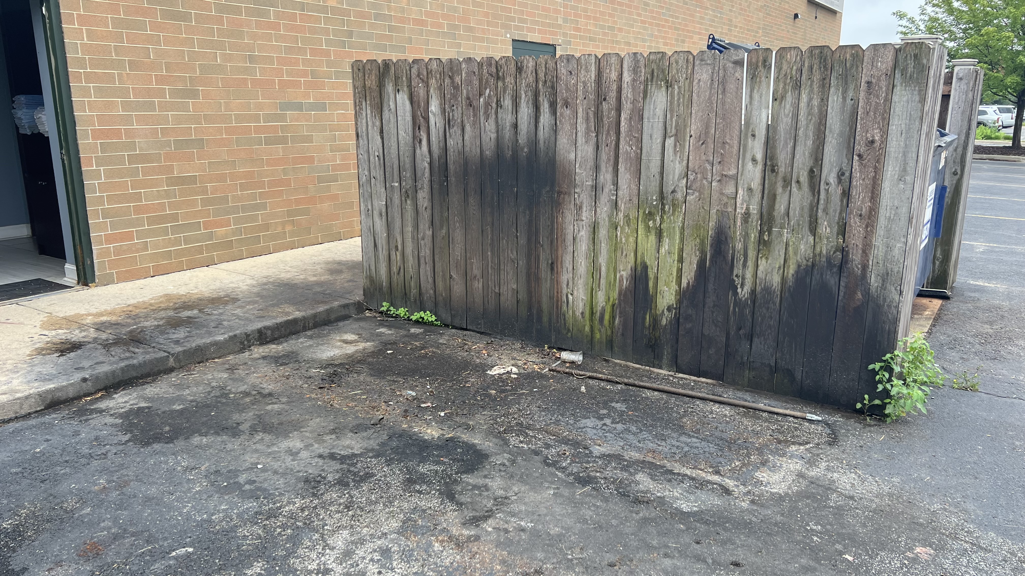

They want fence cleaned too. Around the dumpster pad but dumpster will not be removed.
I have only done a few grease removal jobs. I’m thinking about hitting it with EBC 2:1 and 1/2 cup sodium hydroxide in a 2 gallon pump up. 20 min dwell and Surface clean with cold water.

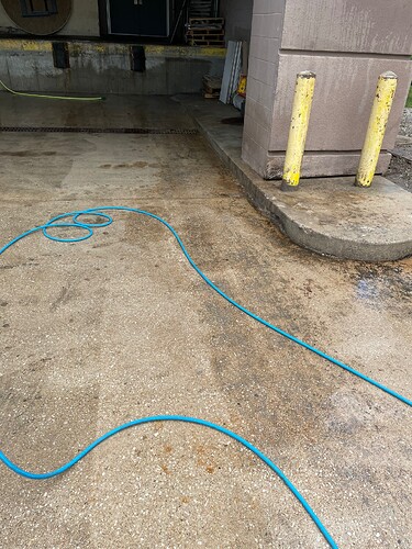

This job took about 2 hours from set up to pull away.
Is that last pic the after pic?
If it is, that not done to me. I would keep working on it. It would drive me crazy!
Was kind of my thinking, blistering hot day, stain had been there for awhile. The manager comes out and says “wow, looks great”. Figured it was ok to stop, think you could work on that for a lonnnng time.
Yes you definitely could! But if customer is good with it than I can live with it.
Get ready to be crazy then. Going to be tougher with cold water. Just fyi, potassium hydroxide works better on food grease than sodium hydroxide. Sodium for the fence will be fine. On the concrete, hit it with 3or 4 -1 with the EBC. You’re going to need to hand scrub, especially the worse spots some before you surface clean. Then I’d come back over with the potassium hydroxide and hit it again since you’re using cold water or you can reverse order. That would be about an hour job for me including fence and chasing dirty water away from curb, but that’s with the right equipment and I do a lot of it. Don’t expect miracles
Post some after pics. Good luck.

Here we go…

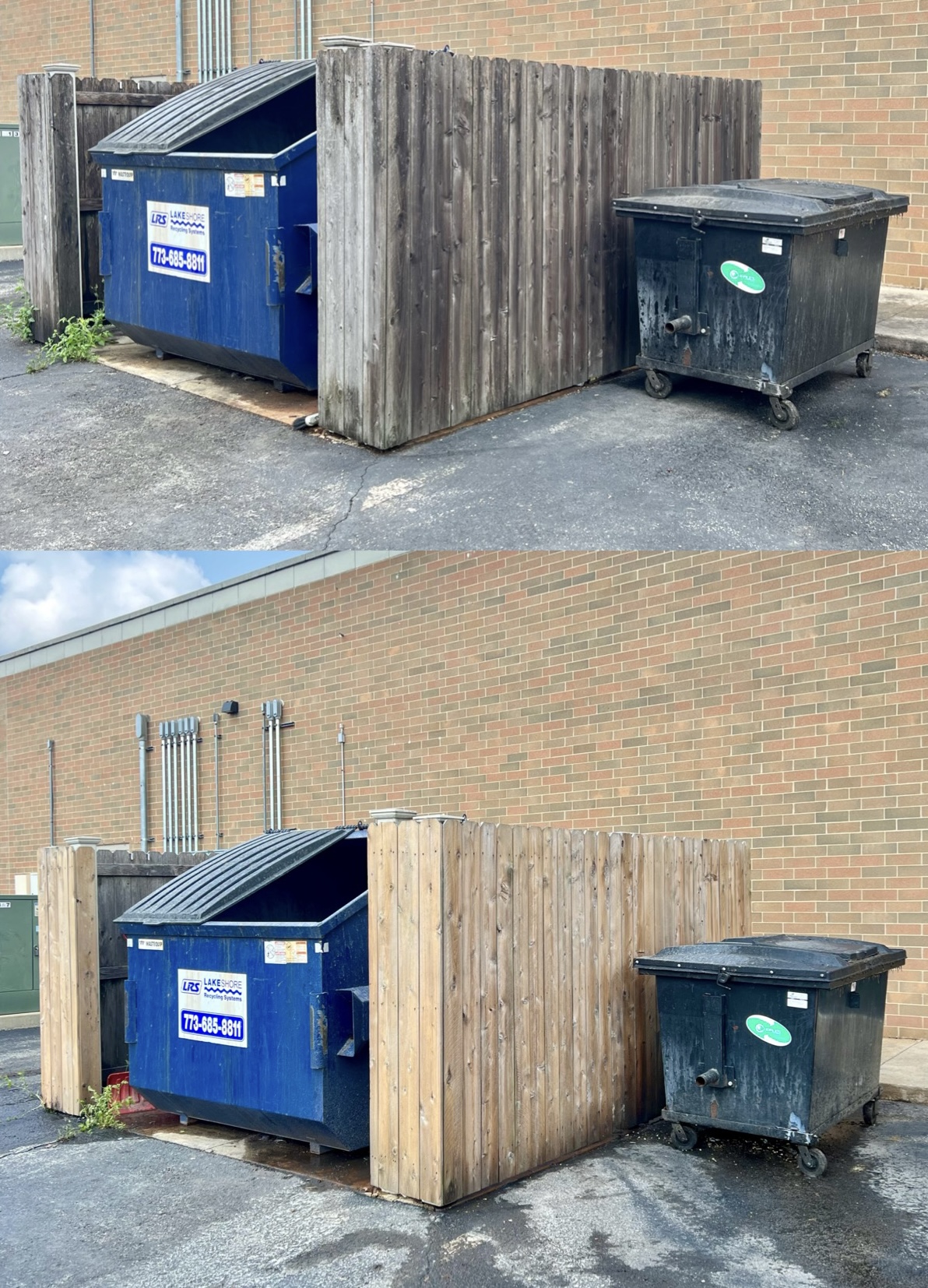

Not satisfied here but customer was happy. The majority of the grease cleaned up pretty good I think.
I told the customer that he should probably consider a monthly maintenance plan for this restaurant. He agreed and is going to think about it. I explained to him that it may take 1-2 more treatments to get the concrete back. From there it’s basic maintenance.

Fence looks good. Seriously, not too bad at all. Couple of things, after you applied and scrubbed, let it dwell some and then DS a mix over it again, that’s where the warm water from restaurant will help, right before you start cleaning. 2) You left your dirty water right off curb. Can see the line in pic 2. Got to chase that stuff further away, typically at least out to end of space.
Did going back over spots with the F9 help much?
How long were you there?
What did you learn and what would you do different next time?

Yes your right. I should have pushed that dirty water out of there. Will do next time. Good point on down streaming after the scrub. I didn’t even think of that! I feel like the F9 did help a little bit, but really no different than the gold assassin.
I was there almost 5 hours. I definitely learned that a hot water unit is in my near future and that I should’ve only been there a couple hours!
Y, after you scrub it in, don’t want it to dry. Just embeds in there more. So spray, and realistically could have probably gone at least 2or 3 - 1 with either, let it sit while you finish scrubbing ( don’t need to scrub hard, it’s really just working the mix into the concrete a little, so light scrub - should have not spent more than about 5 min on scrubbing for all of that.) If it starts to dry while scrubbing, just hit it with a little more of your concentrated mix, and then ds your mix after it sits for a few more min. Then that will keep it wet enough until you get to it with SC.
With heat, that would have been about 1 - 1:15 max, not counting fence.
But as I said, pretty darn good for your first time doing it. As you probably saw, the specialty soaps can be expensive and that’s just a small area. Figure out how much you spent on chems on that job. Most the time, even if real bad will only go 3 or 4 -1. But you need to put on pretty liberally because you are going to work it in. If not it’ll dry almost before you finish scrubbing if hot.
Thanks for the info! It definitely dried up pretty good while I was scrubbing. I didn’t realize the scrub was just to work the chem in. I figured I was trying to break some of it loose. That’s huge info!
I spent about $70 on chem. 2 gallons of Gold A. & and 1/2 gallon of Double Eagle.
