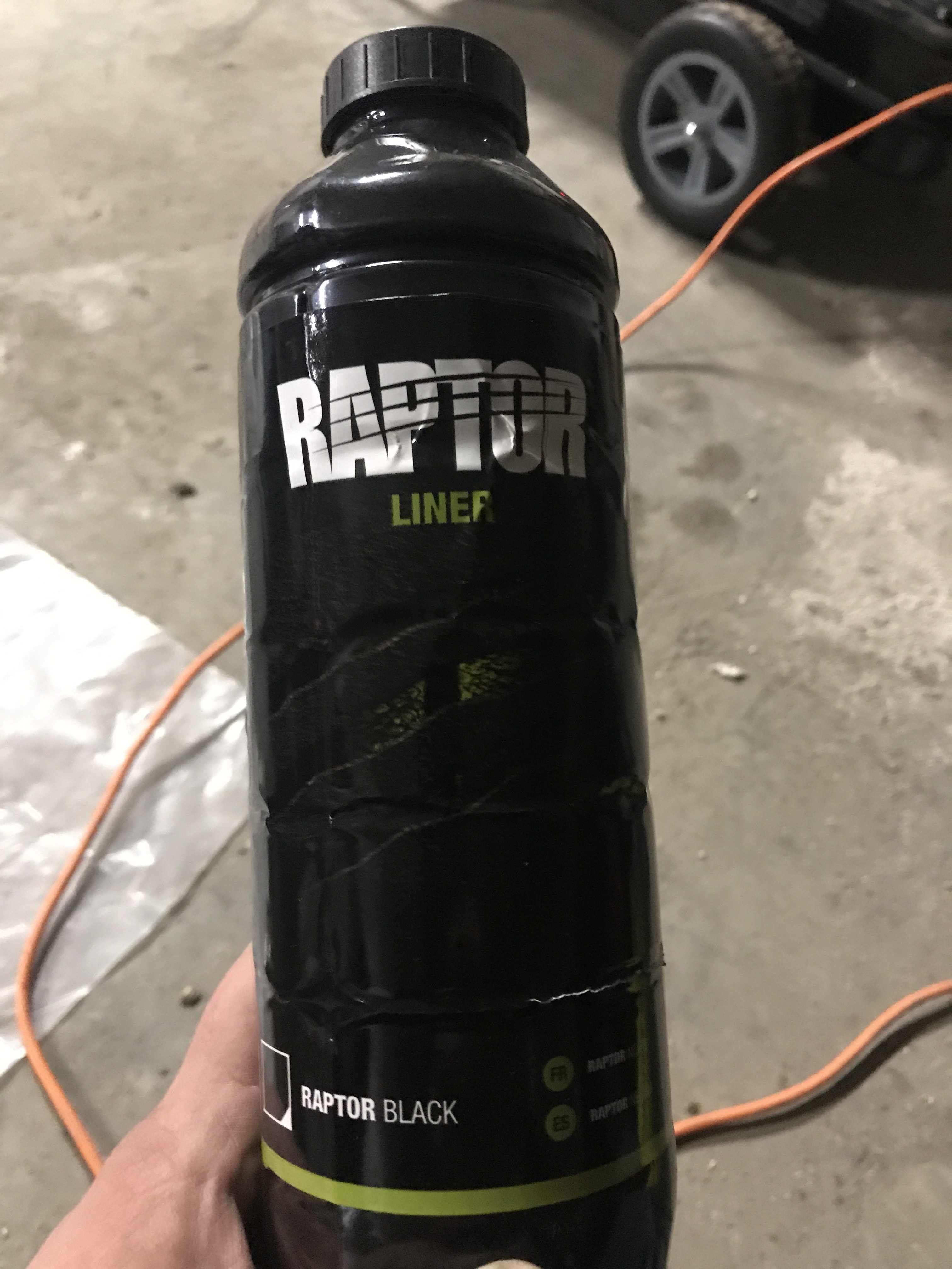

I wanted to share my experience with raptor liner.
This stuff is GOLD!
My truck bed was starting to get some bad spots from SH.
I am building a new skid right now so I decided to order this stuff and coat everything! My headache rack, bed, tailgate, and skid. The bed is done and the rest is primed in the shop ready to spray when I get off work tomorrow! Here are some pics. This stuff is a great tool for our industry to protect our equipment.

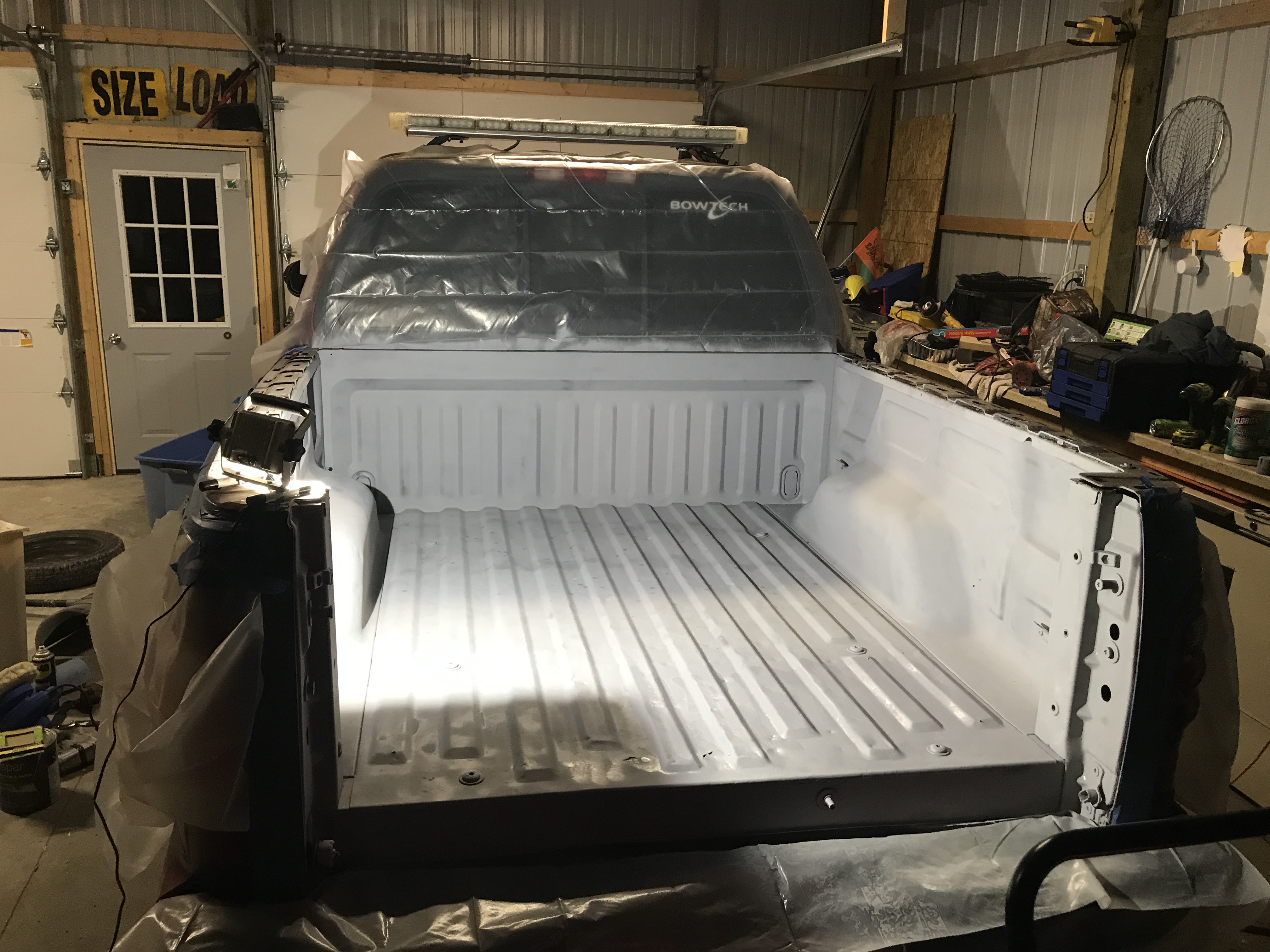

How was the over spray dust? My garage is finished and its more of a family garage then work shop as its finished and I have things in there that cant get over sprayed haha.

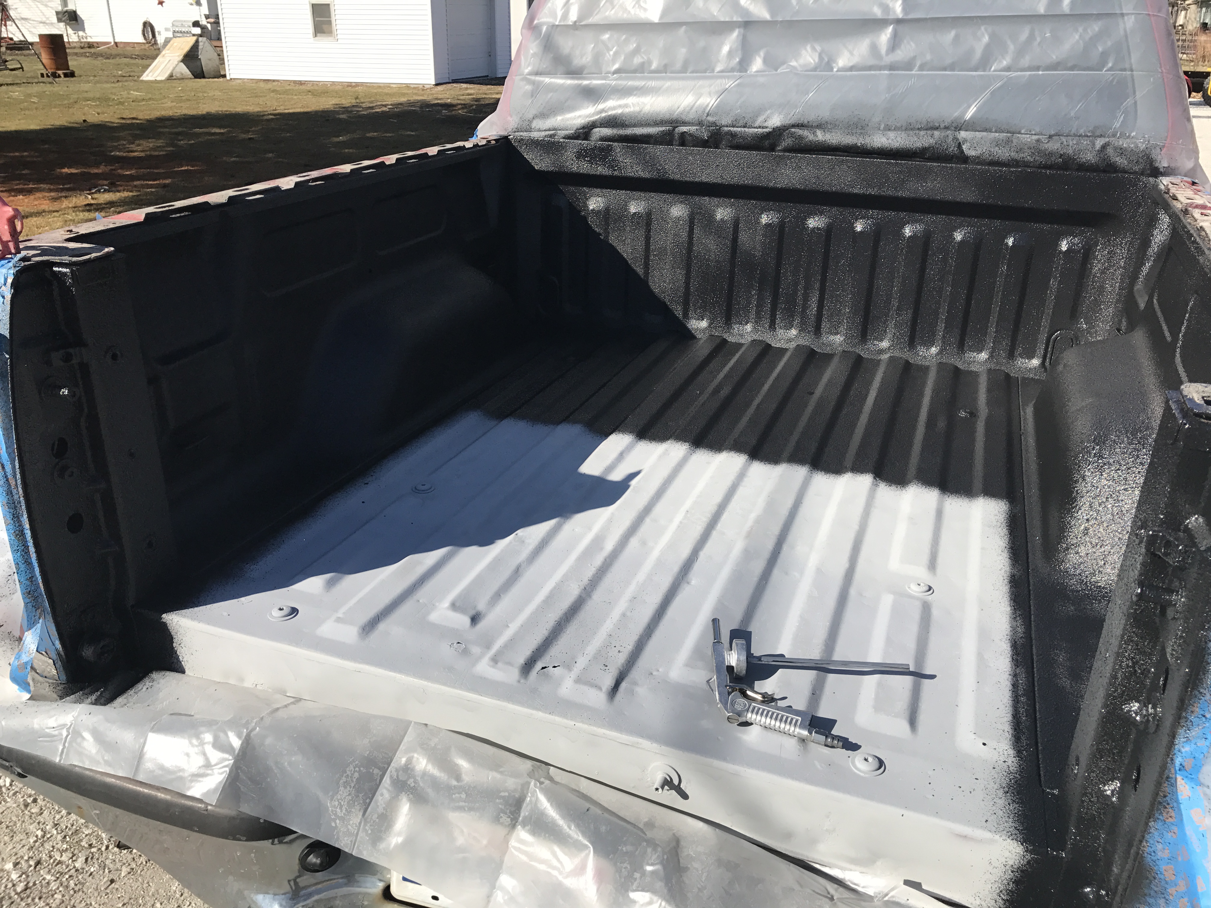

I see you stopped in the same spot every time on your spray pattern did that show heavy when it dried?
Not at all! Its really thick stuff so over spray was minimal. I was outside when I sprayed it though and there was a breeze. I sprayed it outside and it was about 50-55 then backed into the shop, put the torpedo heater on saw horses aimed right into the bed. Once it dried out you couldn’t tell where I stopped and started. I would be careful doing it in a garage with other vehicles. Get some cheap plastic to hang around if you have too. Or wait for a nice day and spray it outside.

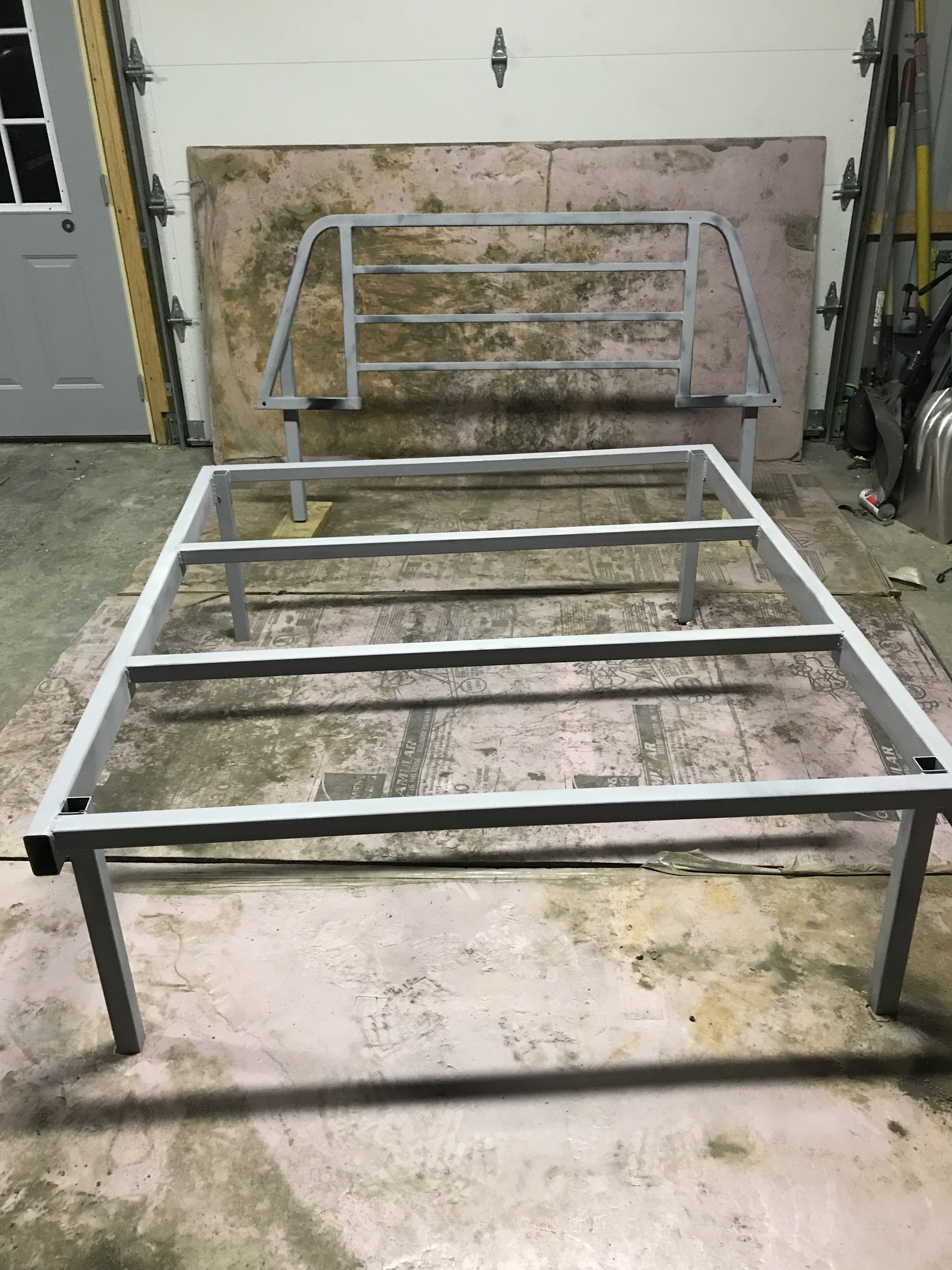

Getting closer! Didn’t have enough raptor to do the skid after I did the headache rack and tailgate. Ended up at the store buying hardy paint.
I have a 200 gallon low pro tank that will sit under this frame. Top of frame will be covered in 3/4 inch teated that’s painted with texture paint. Motor and hose reels will mount on top. 30 gallon SH TANK and 8 gallon soap tank will mount against headache rack.
