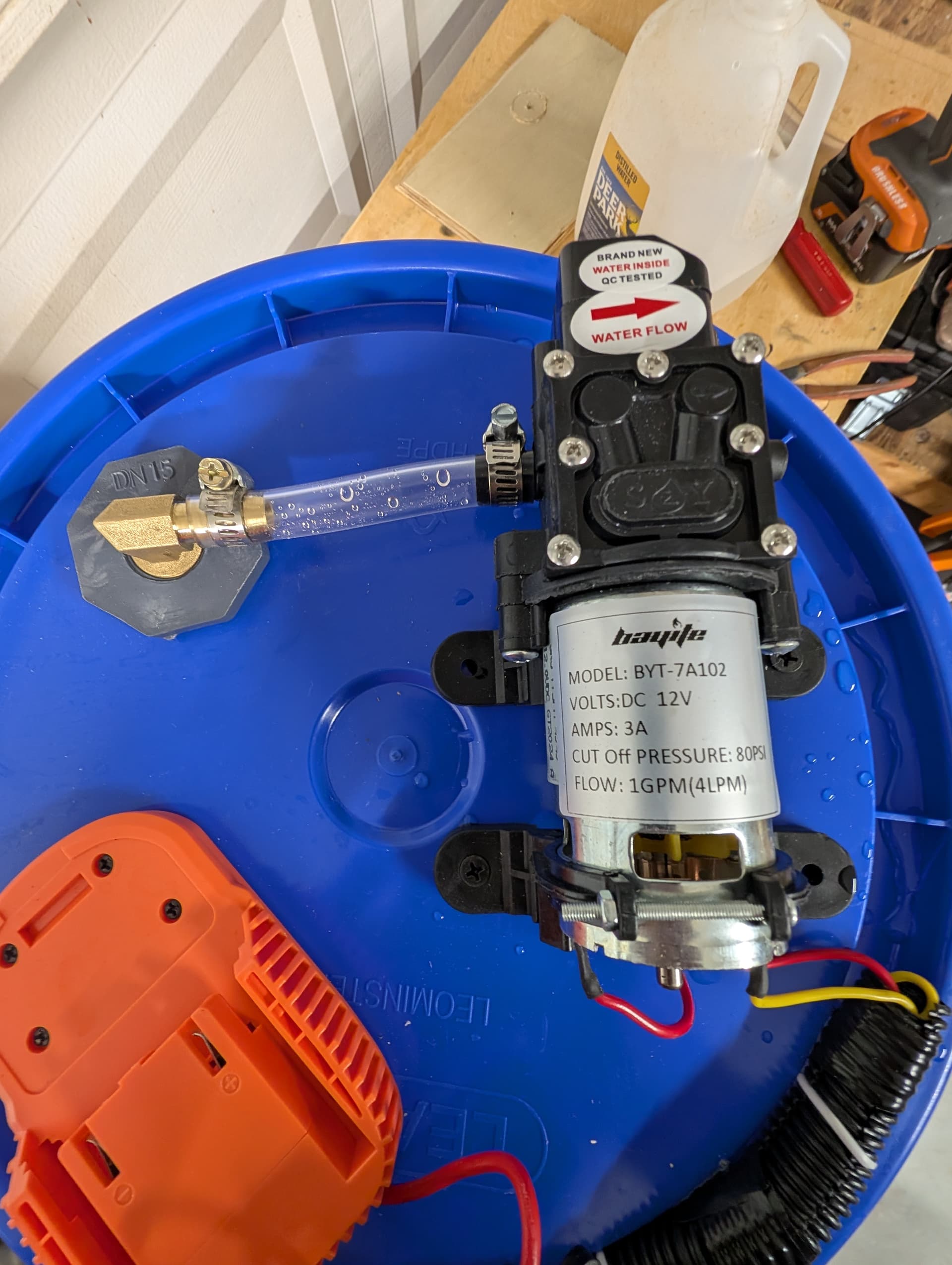

It’s a 12v 1gmp pump off Amazon. I have made sure everything is tight. I have rechecked everything triple-checked everything and like I said water shoots out the outflow during my test but as soon as I connect my hose with spray wand, it will stop pulling water completely.

What pump specifically?

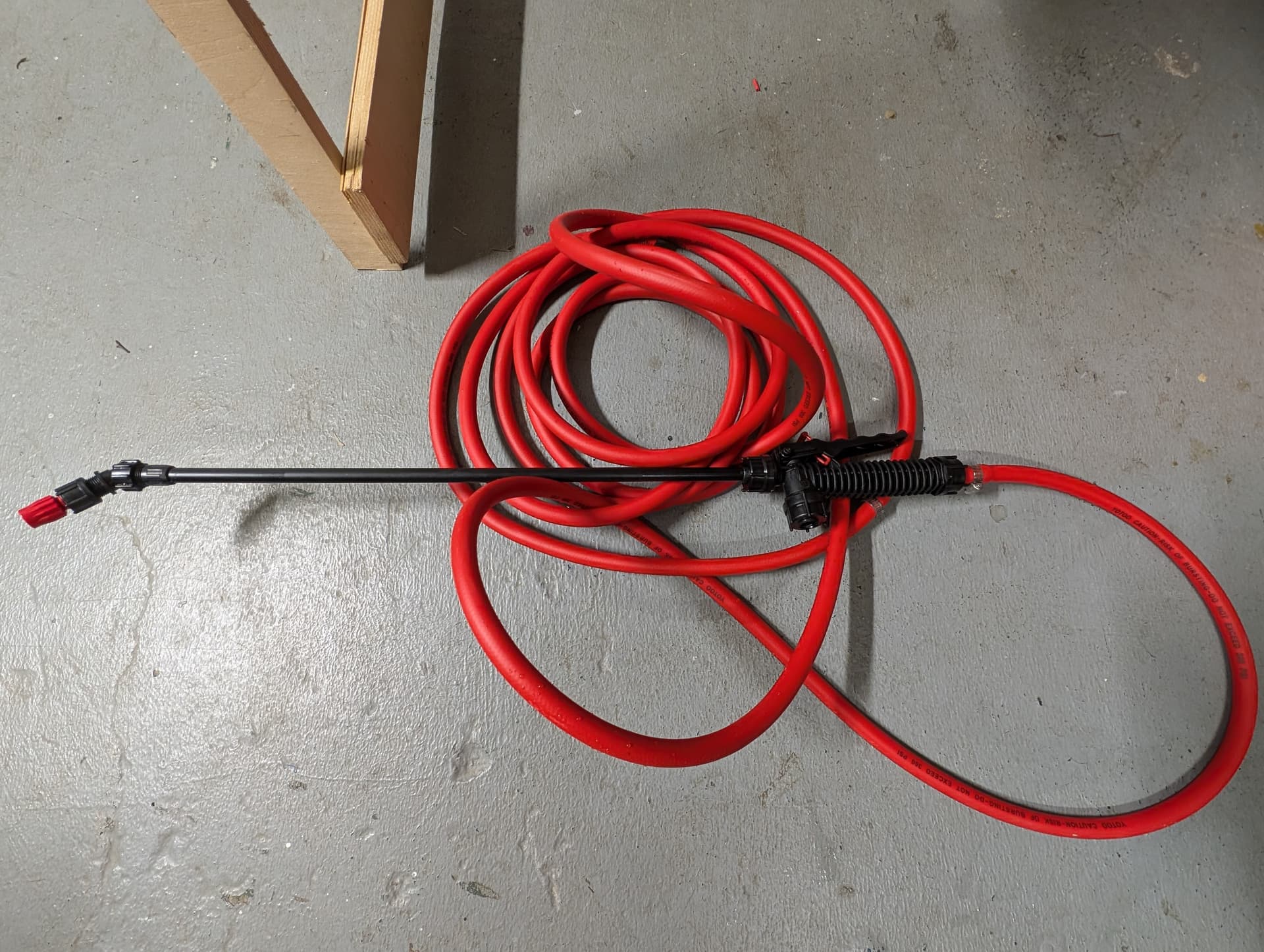

Some pics below. 25 ft. of air hose with a brand new Solo 28" wand with shut off valve (4900170N). And yes, even with my worn out lungs, if I hold the wand trigger down and blow through the end of the hose, I can blow water through it.
Does the clear tubing collapse when the hose/wand is attached? Could be restricting flow. Not sure about that pump, but it might have an adjustment screw on the top (where the q.c. Sticker is) that you can fiddle with to get more pressure.

Just for S&G’s did you reverse the hoses? Not going to say that it is a cheap pump, but maybe the flow indicator is wrong?
I didn’t because when I removed the hose from the outflow, water pumps out like it is supposed to.
Only one way to know, go to rural king or tractor supply and get another 1gpm pump. I’d do it before the return on the amazon purchase runs out.
I know those pumps well and can tell you they don’t pull water very well and won’t put out 1 gpm pulling water. Brand new I’ve had them work, but I’ve tried slightly used ones for other projects and can’t get them to pull anything. I use 5 of them in parallel for my house washing rig to get the flow I want and I’m forcing water into them from the spigot. They are great pumps for how I use them, but not right for what you’re wanting to do. Also, Amazon is expensive, I don’t know what you paid, but I buy them in small lots for $10-12 each.

@TGKPressureWashing Since the flow stops when you attach the hose or wand, I would have thought it’s probably something to do with that. But if you can blow through it with the trigger pressed, that makes it a bit confusing.

They are cheap pumps that were targeted for applications like this bucket build, but they just don’t work well. You get what you pay for. Trust me, I’ve been buying and playing with these pumps for years now. I’ve built a setup like his bucket with them in the past and when the pump is brand new, it worked ok. Get any use out of the pumps, they just stop pulling water. My bucket setup only had about 6’ of hose and it didn’t work well, no wonder why his isn’t working with 25’.
If you want a setup like this you can use often and trust it to work when you need it, buy a better pump.

Seems like a lot of air being sucked in when the wand isn’t attached… what does the drop stick look like? Do you typically run without hose clamps or was that just for this video?
When I turn on my pump, it’ll take a minute or two to “build pressure”… if I hold down the trigger it’ll sputter like that, but doesn’t build as quickly. Have you tried filling the bucket, turning on the pump, and not holding down the trigger? I’ve found once it’s “primed/built pressure/whatever” the pump will turn off, once I hear that audible cue, I know it’s ready to spray. I can also see the hose expand/move a bit right before that happens… hard to describe in text, once it’s warmer out I’ll try to get a video.
I had clamps on the drop stick and everything else except the outlet hose because yes I had been removing it several times for testing. I made sure everything was tight from the drop stick to the inlet so there’s no air getting pulled in.

So you changed the pump and you took off the wand, so if there are issues, it is either in the hoses or in the power. Your video showed it pumping, albeit with a ton of air. That air is coming from somewhere. Look for tight seals on the pull side. Don’t think, yeah I checked that, redo it. Second, remove the 90 from the bucket. There is a grumpy guy on here that swears you should always eliminate the 90’s. My guess, and it is just a guess, is that the connection between the suction side of the pump and the 90, or the 90 itself is the issue. You should use nylon braided hose, and just make it curve a bit and go directly down. My mini tank doesn’t have a hard 90, just hose going down with a filter on the end.
So to trouble shoot it without completely removing everything, take off the suction hose off the pump. Put on any length of hose and put it in a different bucket of water. start it up without the wand on the discharge side. If it sucks/pumps, it is the connections on your bucket.
