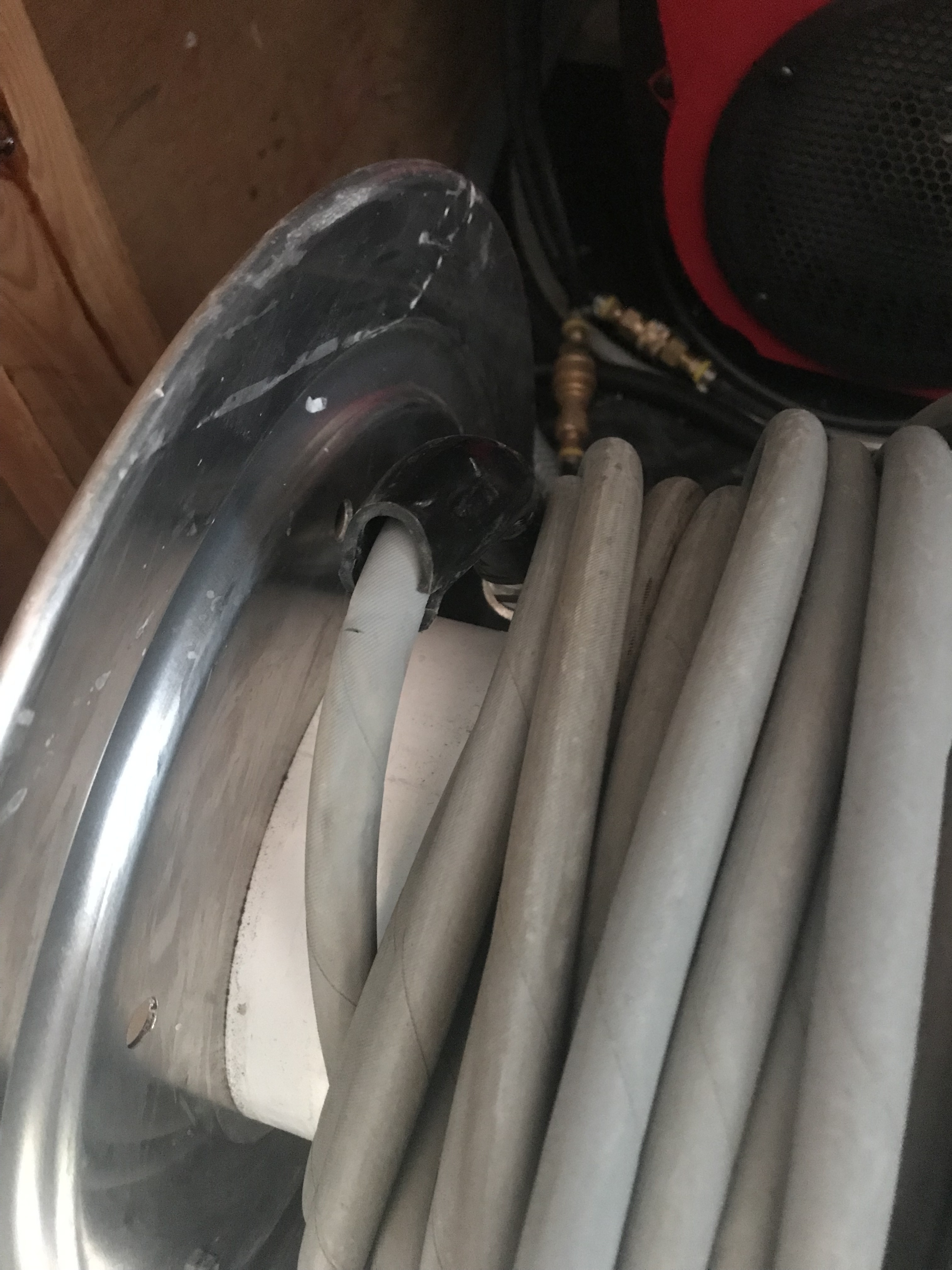

Post pictures of your reel. Does your reel have a tension bar on it. Do you have rollers

It’s just a standard Titan SS reel with 1 wire grey hose. I don’t think there’s room for rollers unfortunately. I have the brake set fairly good, should it be a lot firmer?

If its rat nesting then yes apply more tension. I pull all 200 foot off if I need it or not. That’s how i was taught to do it. The long and short is that it’s a friction loss thing i run electric reels so it’s no big deal to put it back at the end of the job. I also run rollers on all my reels
Do they make something to fix this?
Maybe a 45 degree elbow or something? That hose is at a fairly severe bend.
Yes put a 45 nipple then another 45
Put a whip hose on it
I’ll get with the guys at Southside next time I’m out that way, thanks.
