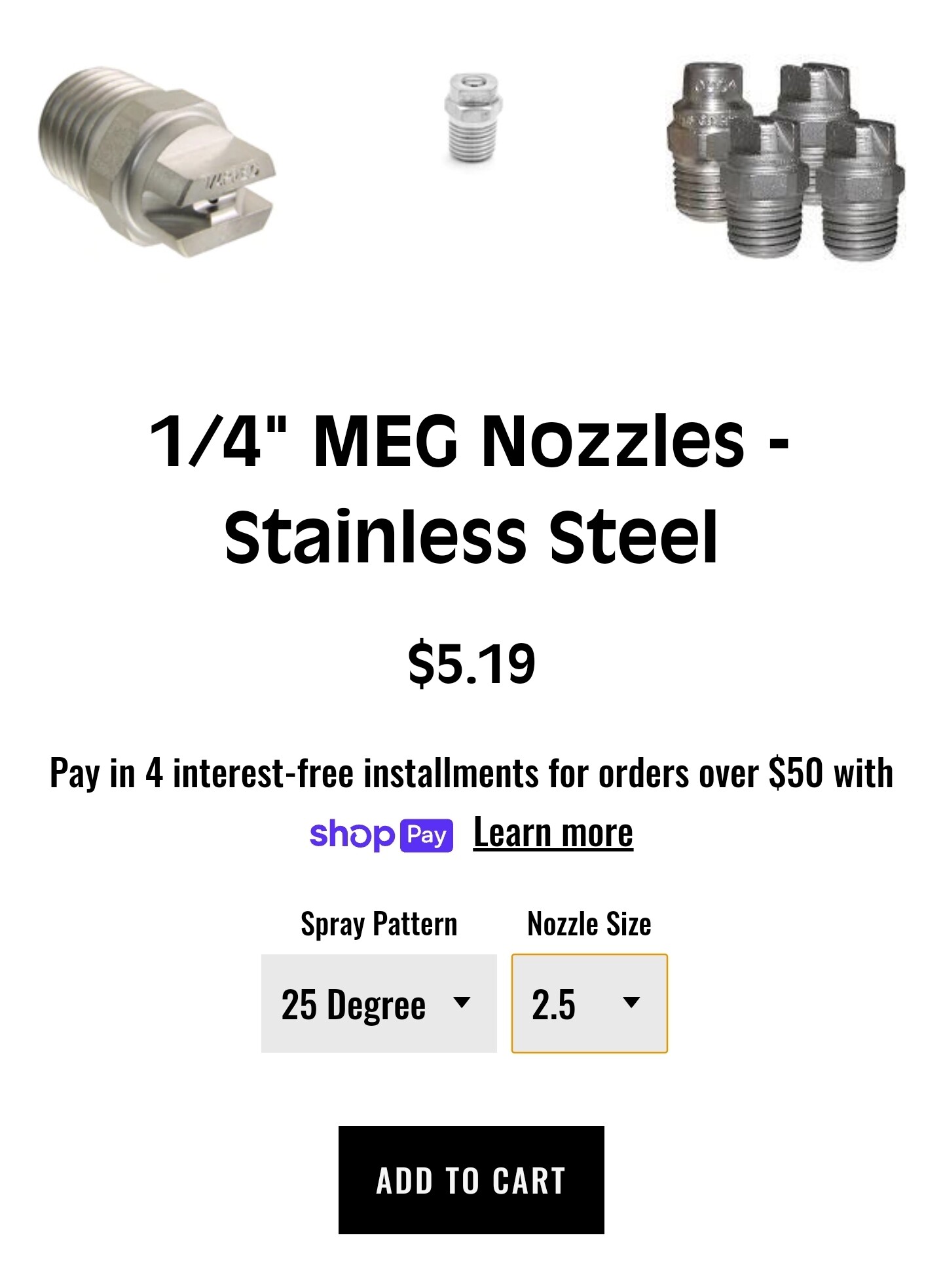

After reading some of these comments, I most certainly do plan on upgrading to a higher gpm machine later. I think one of mistakes i definitely made was not knowing this fourm existed prior to beginning all this. If you dont mind, i do have a follow up question. I was searching around for places to purchase nozzles and i came across the term MEG nozzles a couple of times. Is that the type of nozzle that i should be looking for? Ive attached a screenshot of the ones i think i need according to what you suggested. What do you think?

Several places you can buy in TX. Yes you want the MEG nozzles preferably with the vanes, if anyone has them.
