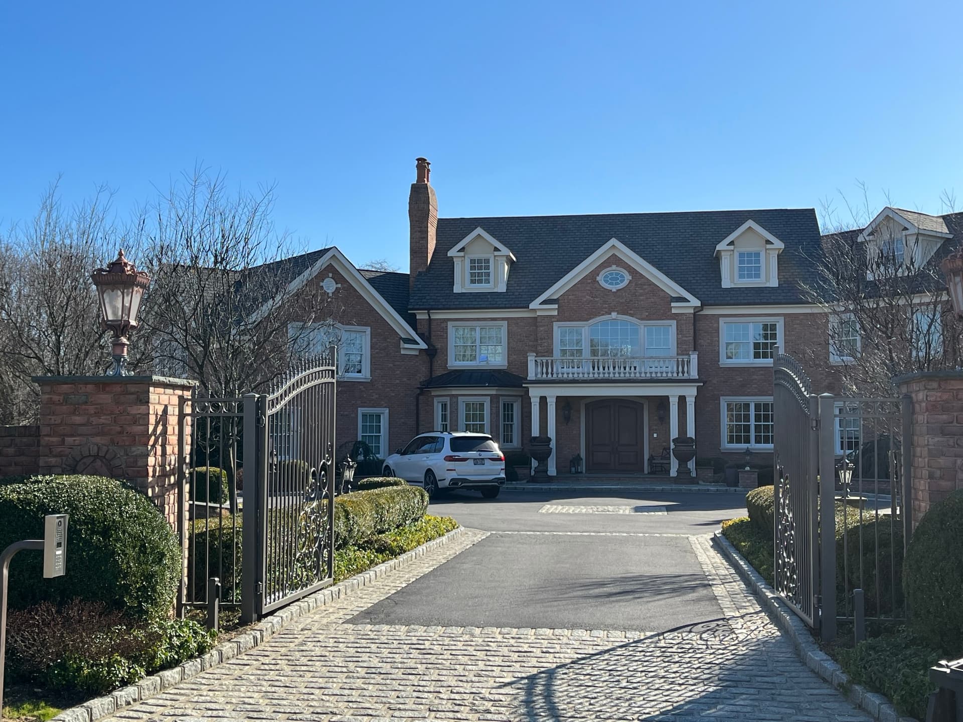

How do I wash this house without affecting the copper. The house isn’t very dirty. I haven’t cleaned a full brick home yet. This brick has peach tinted mortar joints. Not sure if that’s a issue? He just wants the sand dust cleaned off ( no algae) and soffits and window casings cleaned (stucco). Copper gutters and downspouts are a dark brown and customer doesn’t want the patina ruined. Is this as simple as prewetting, rinsing and post rinsing the copper? I am definitely going to get overspray on copper. Also, would you prewet the brick? Only really dirty spots is a few of window casings and a stone veranda railing on top of entrance which has copper right below.
Any help on a plan of attack besides run away.

There are plenty of non bleach cleaners out there. Nothing as effective as sh but your only dealing with mild growth. Just be sure to check any active ingredients in an alternative cleaner against copper. With that being said, I would downstream SH without a second thought. Work in small sections to prevent drying and minimize dwell of overspray. Prewet the copper really well, make sure you cool it down, and rinse the copper quickly. If any copper is in direct sunlight it is even more critical to really wet heavily to cool it down and rinse immediately. I know what the experts say about sh and copper but I downstream casings, fascia, soffit surrounded by copper gutters all the time with perfect results. I just picked up a check today from a customer I did their lake house the other day and his primary residence has copper gutters (brown patina) I have been washing for 7 years and today still looked fabulous. I also just downstreamed trim on another customer that they had bay windows with copper roofs perfect results. Follow those steps with a test section on the back side somewhere. Work on something else let your test section dry really well to be sure. If test section is fine (which ur gonna apply your mix directly to the copper), then you know your good on the rest where you are purposely keeping the mix off and only dealing with a little over spray and run off. Best of strategy to you. Luck is not a method
Thank you for the sound advice. Rick too as always. I’m new to washing gig so I just needed some reassurance on that my plan was spot on. I will never run from a job like this. Do your testing and take your time. Nothing ventured nothing gained! Anyhow, I tested the downspout in back with a real hot mix + 4%. Wet and dry with a dwell to match a normal rinse time to see any effects. Had zero effects. We took our time. Washed the house with a 1% downstream, wet gutters before, after soaping and rinsed. Perfect results. Had to wash the veranda pillars and used a 3-4%. Had my guy rinsing as I went. No issues at all. I’ll finish up the hardscapes and pool deck and bar tomorrow. Client came back and was happy with the results so far and that we took time and care and he gave me the driveway Sealcoating work. His neighbor was also watching us so he’s probably next. Any advice on how to clean a castle. Lmao.

That stone work above the porch roof is going to pop on that house once it is cleaned. A nice before and after pic in sunlight.

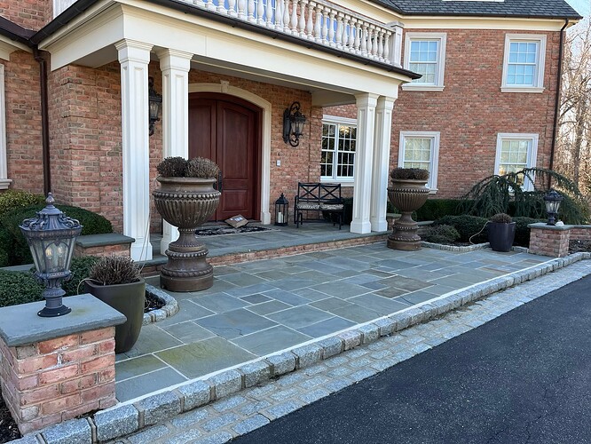

Is that oil rubbed bronze coloring/paint or copper? I see a little green up top, but it looks more oil rubbed bronze color to me. I am not there, just looking at the pics. Very hard to tell.
Are you moving those flower pots? They look to be the 2-3 piece concrete ones that are super heavy. Maybe they are the fake foam/plastic ones, can’t tell from the pics. I haven’t run into anything I couldn’t move on my own with a dolly yet.
Are you cleaning the drive too? I’ve never tackled a mixed drive like that, with cobble and asphalt,so I am curious. Looks like it might have a drain in the middle too.

I cleaned the cobbles on the driveway. There was a drain in middle and a bunch of longer drains here and there. I am going back to sealcoat it later this month. The top rail popped pretty good. I would have like to hit with a hotter mix but erred in cautious side with the copper. We did not move the flower pots. He said to leave them. The limestone had a bunch of water stains(black) from puddling and the from the cedar roof pool bar that I couldn’t budge. We were not treating this area with chems. Just cleaning with pressure. There were a few areas that had some green stained into the stone. I thought it was algae at first but I tested a hidden corner with 4 then 6 the 10% and it didn’t budge. Looked like a light blue green. Some was right in middle of the sunniest area so I assume it may have been caused by something reacting with stone like furniture. I would love to get that limestone cleaned up better in future. I have to do some research how to treat it. I didn’t end up doing the pool bar cedar roof as I could barely stand on the ground with the wind we had.

Did you use SH or sodium percarbonate on those cobbles or just hit it with soap and water. I was curious to see if the runoff from the cobble - across the asphalt and back onto cobble before hitting the drain, would cause any issues if you used SH.
Was that a slate/shale patio? If so, was it sealed? I would imagine SH runoff could have caused issues. That slate/shale likes to sheer if hit with any pressure at all.
