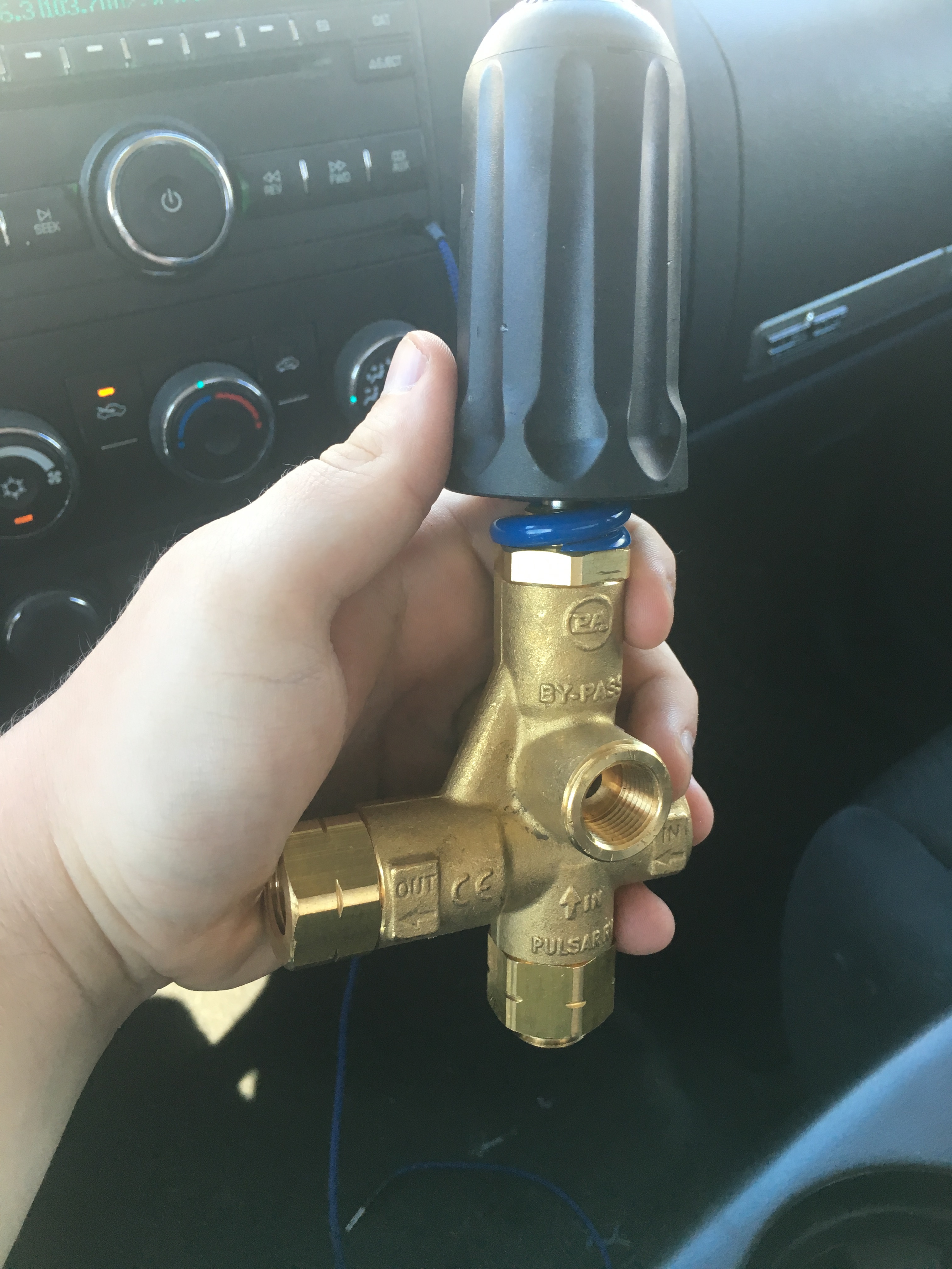

@roofer @florida_condo_cleani @Innocentbystander well after hooking the unloader back up. Same issue. Runs fine, but as soon as I engage the ball valve it shuts off. What’s the next step? I can get an unloader locally if ya’ll think it needs to just be replaced.
Unloader is likely bad . It’s probably not out of adjustment that bad . It’s likely not going into bypass
Yeah I am actually at my supplier now. Any reccomendation? I’m thinking pressure trapping. It will also depend on what they have in stock. I at least need something to get me by for jobs this week.
New unloader! Hope this works!

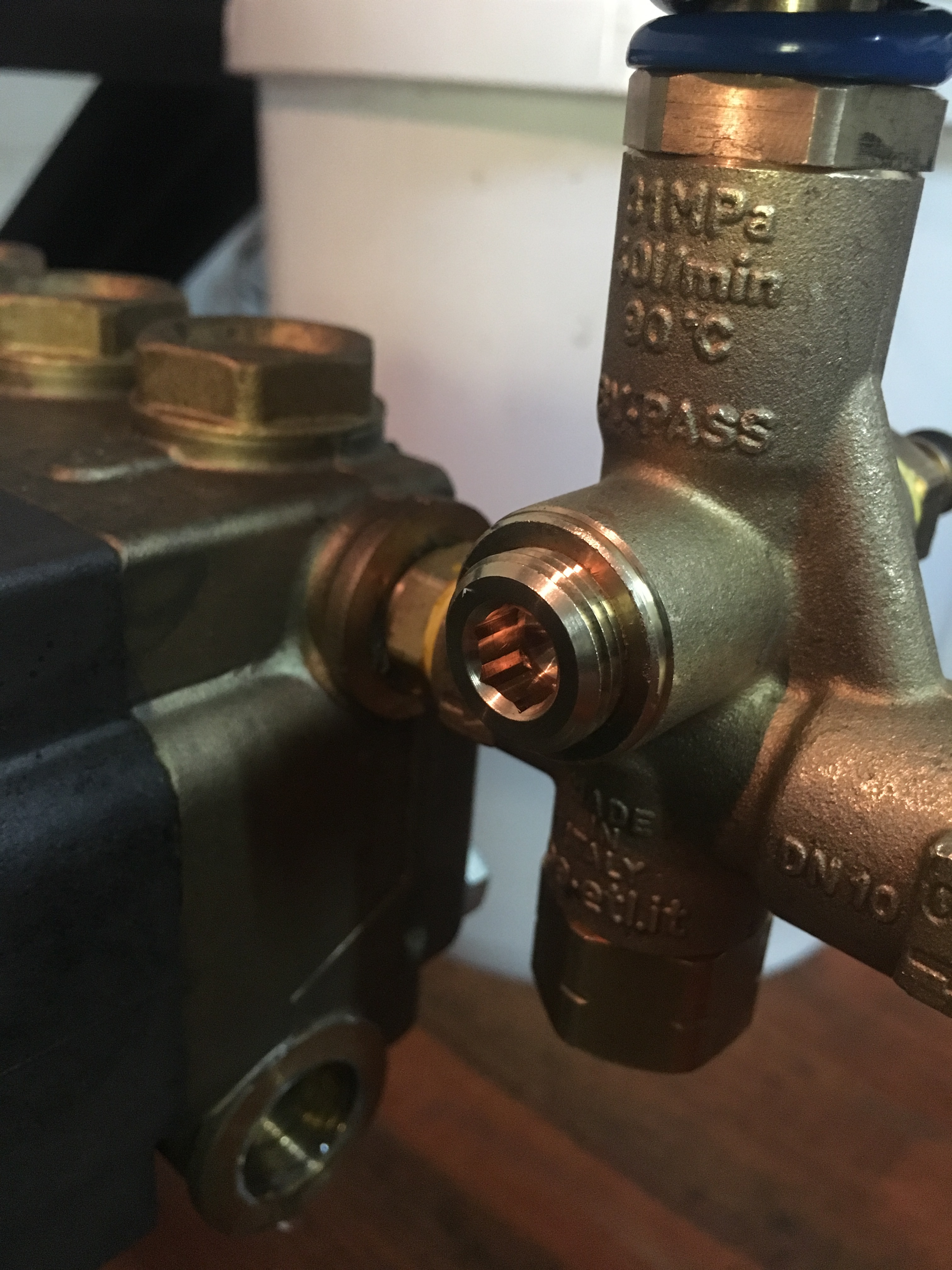

@florida_condo_cleani ok I got the new unloader installed. Two questions. 1) the bypass was on the other side on the old unloader does that matter? Looks like they are interchangeable. 2) these hex screws on the side and bottom, should they be tightened all the way?
Likely you could use either side . Both should be labeled bypass. And yes you want them tight. But not necessary to be super tight since it the low pressure side
Yeah both are labeled bypass. Thanks! I’m going to get everything re-connected and try to set this unloader.
