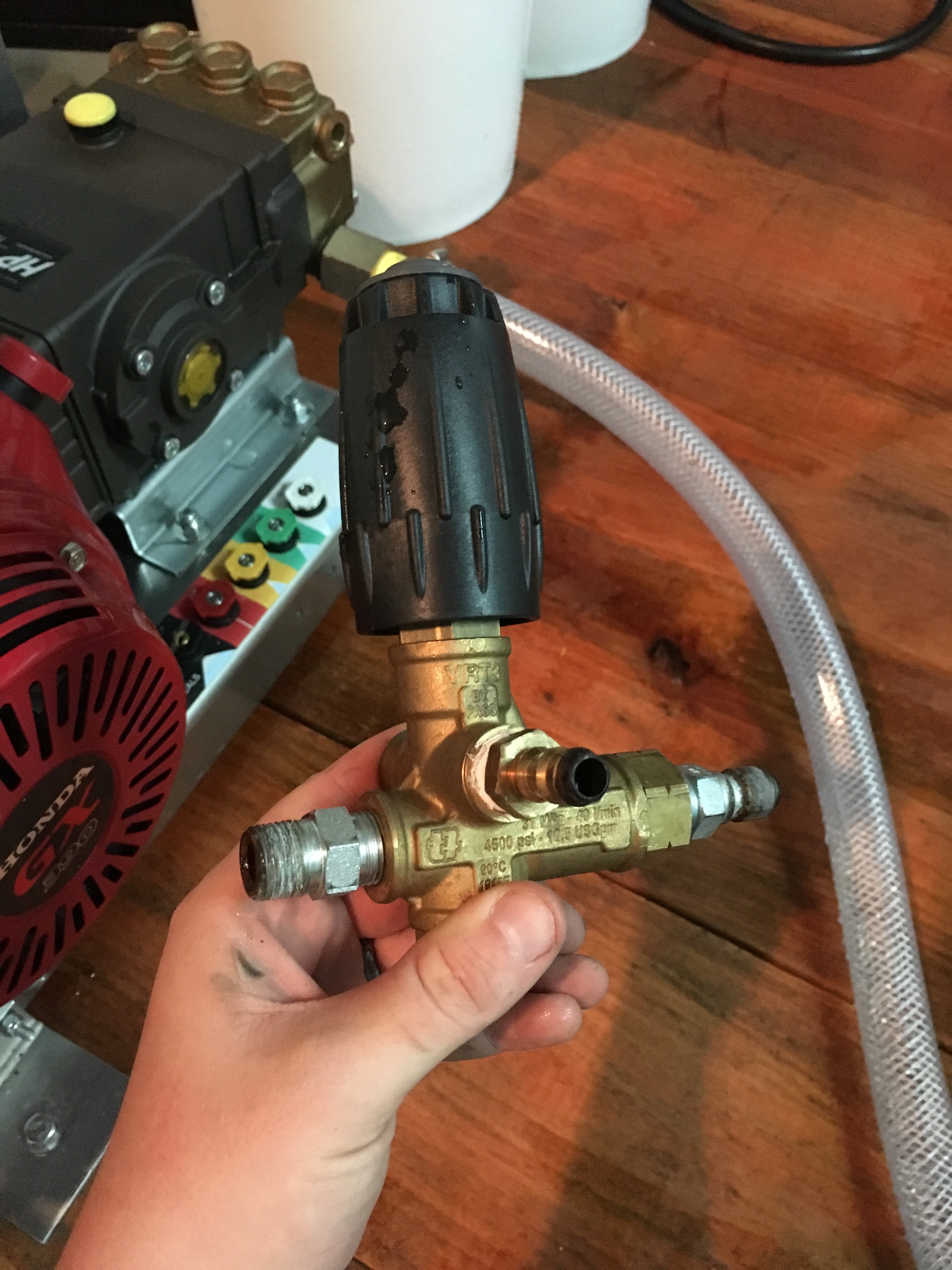

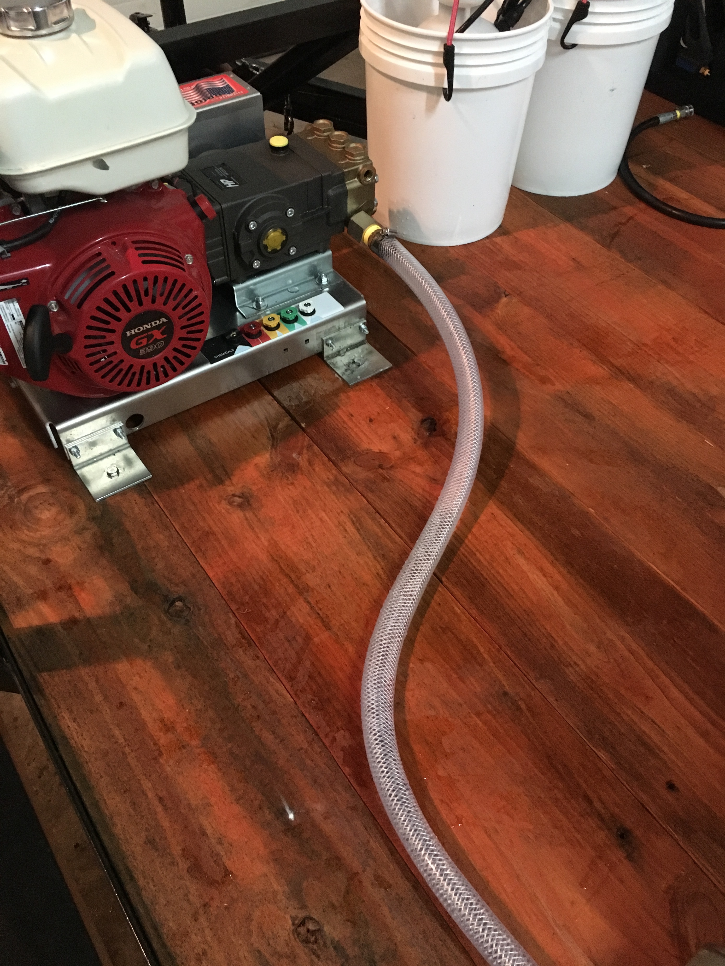

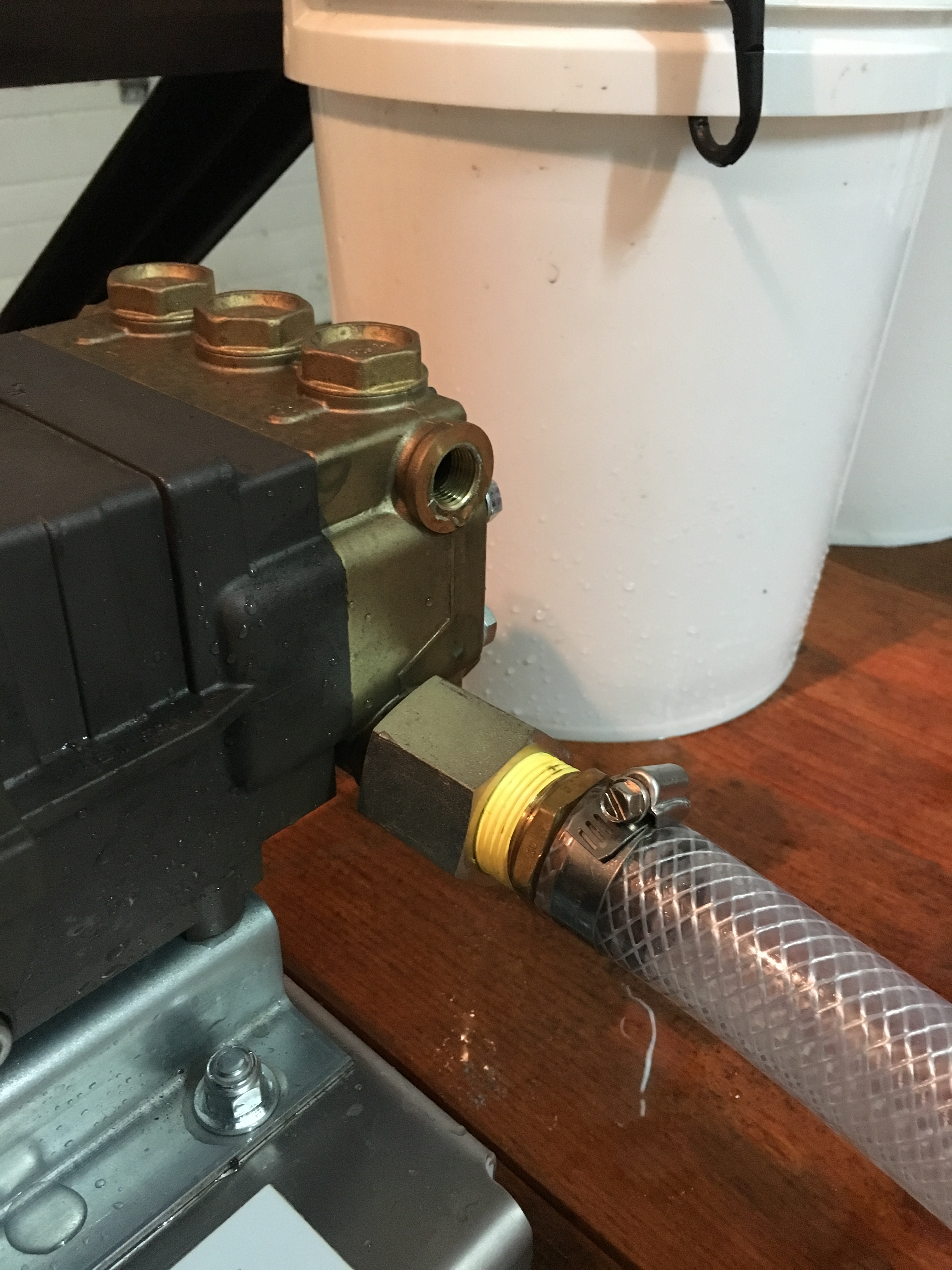

Ok I have the unloader off. @florida_condo_cleani you can see nothing is connected except the hose on the inlet of the pump. So at this point I need to just try and start it and see what happens correct? How long should I let it run? Should I be watching for anything?
Start it . You just want to see if the pump is locked or if you have the unloader backward or something else
