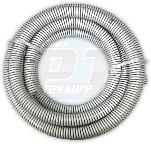

Got the wrong hose for water water supply to your washer. Those braided hoses collapse and can causes a lack of water flow. Get this one.
I have just about the same set up. I upped the bulkhead size to 2" coming from the tank. Then 2" pipe to a reducer to 1" and used the hose previously stated. Non-collapsing hose. The only issue I’ve had is from draining the tank to much and an air bubble gets into the pipe. Other than that, works perfectly.
