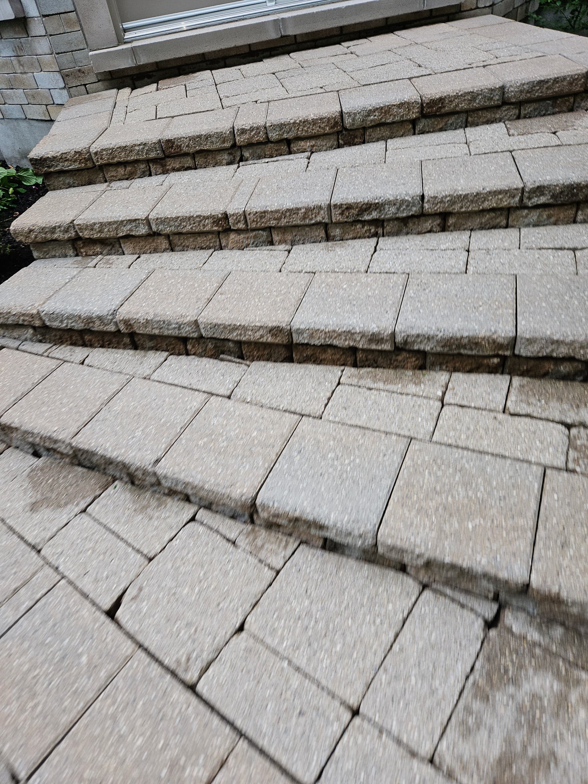

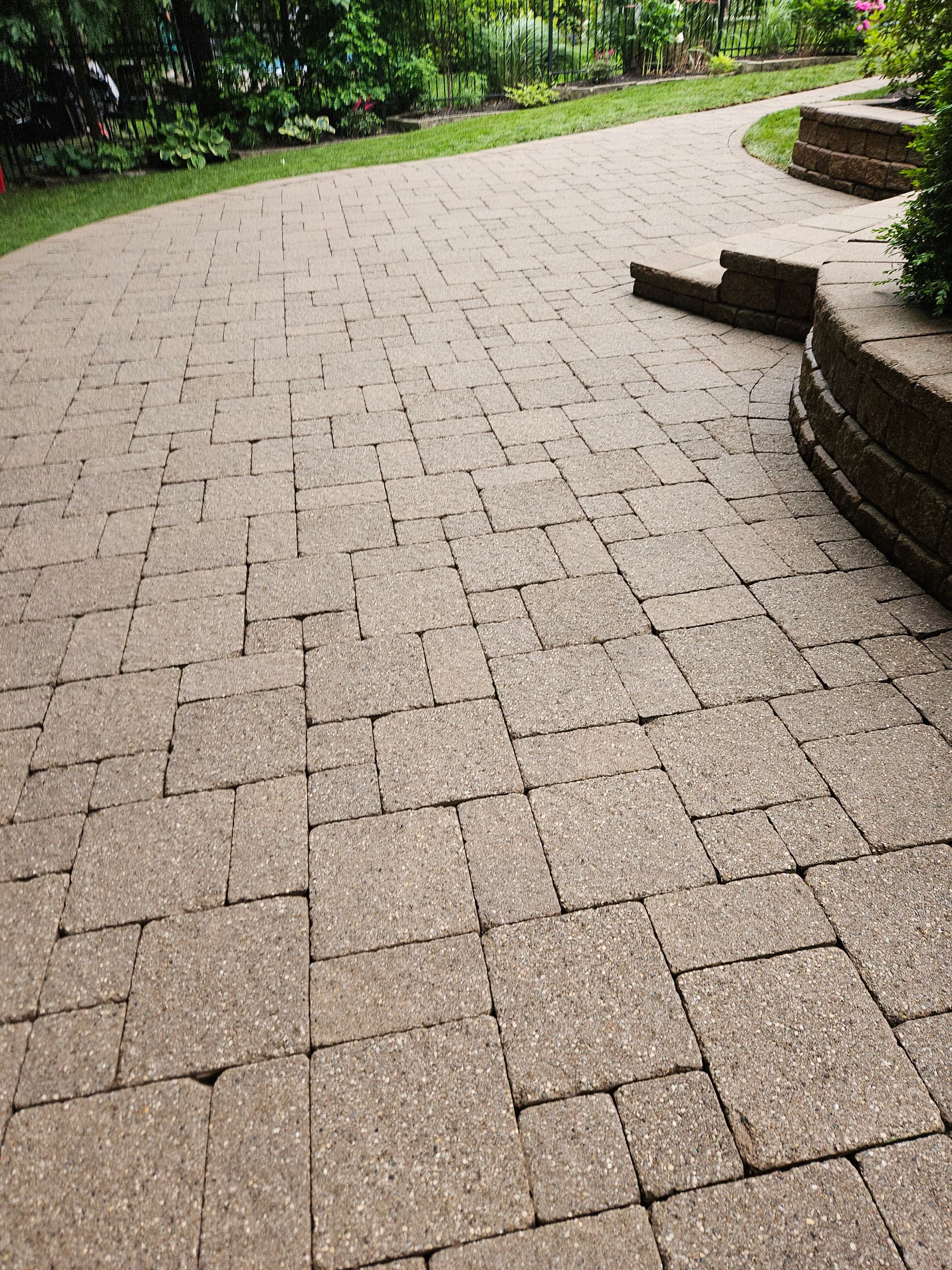

Open to criticism but wanted to provide some closure on the first photo.
17 blocks from the left, 6 from the bottom looks like you missed an ant turd but a good rain or two should take care of it. What are you gonna spend them fifty dollars on? Otherwise, nice work.
Nice work!
Looks good

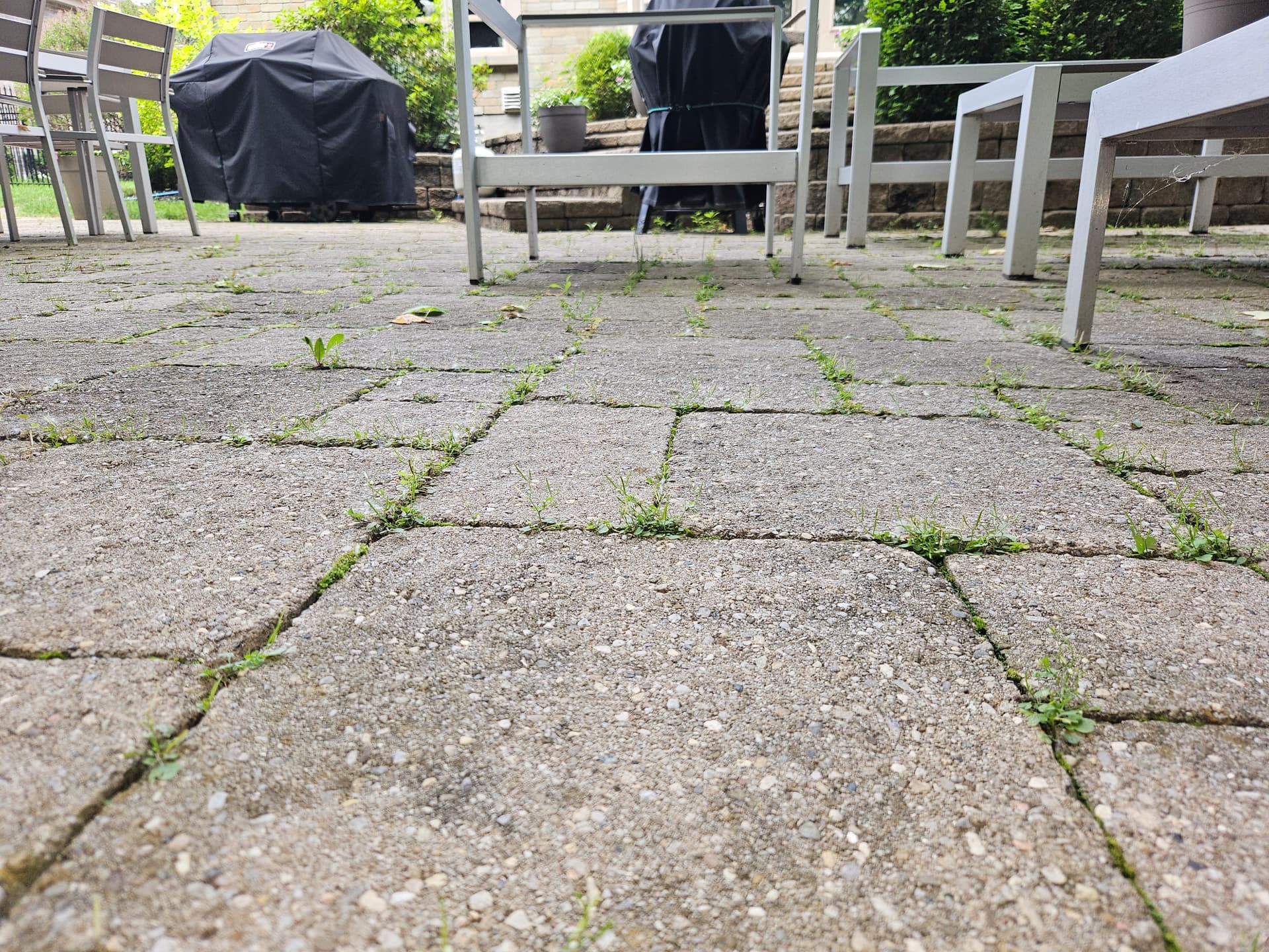

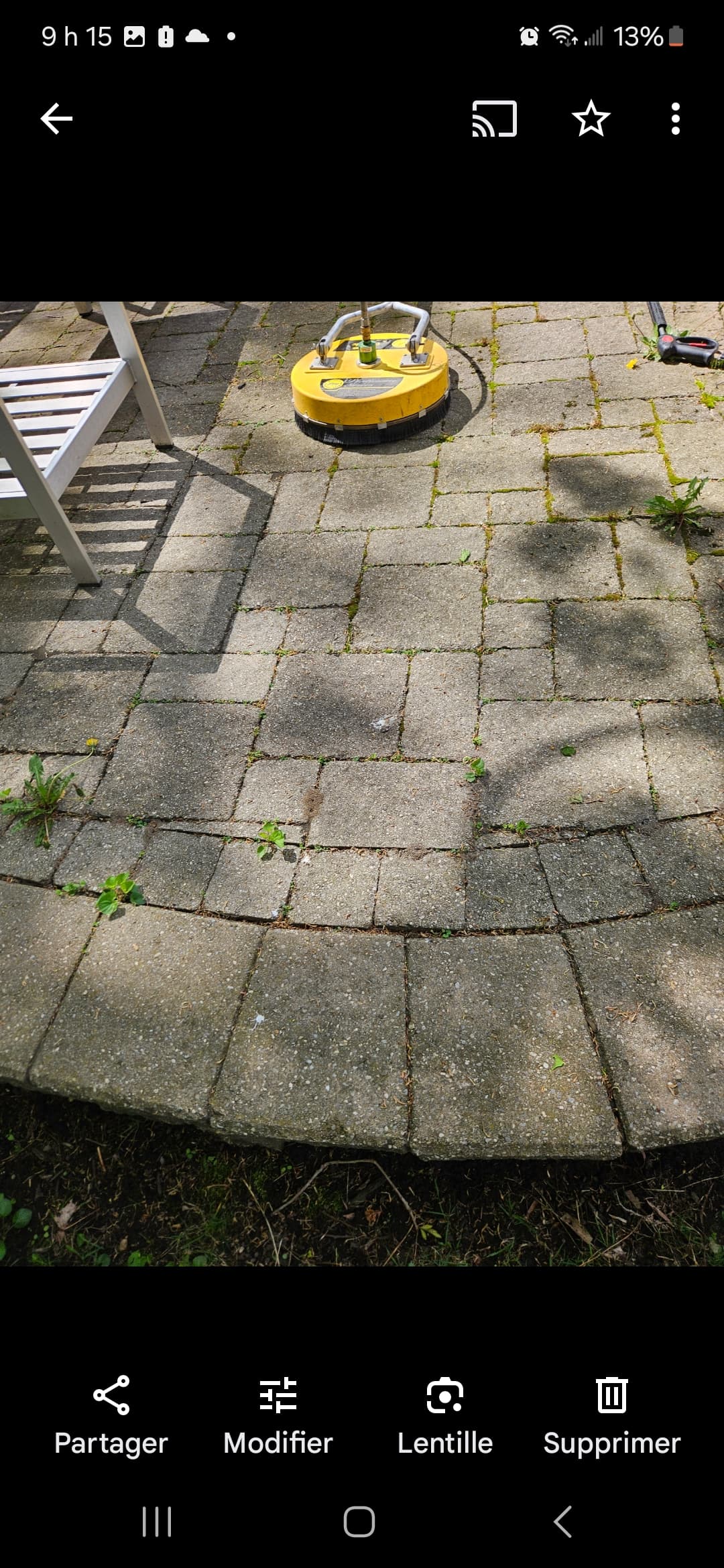

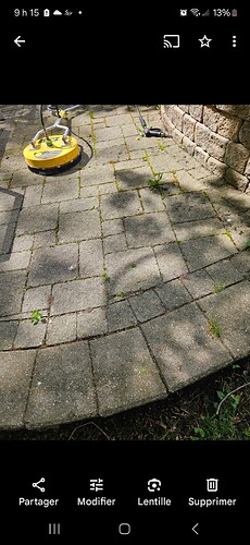

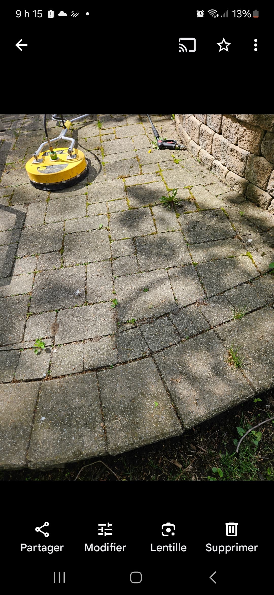

Is this an exception needing the turbo and is surface cleaning usually enough? Starting cleaning and re-polysanding jobs this week. I thought i could just surface clean the old polymeric sand and weeds out.
Here’s a quick test i did with just the s.c.:
I have never used a turbo, maybe that works, but my go to is the yellow tip.
It’s going to be a messy job; what I might recommend first is a paint scraper and leaf blower once the joints dry a bit, then using the yellow tip.
If someone else has a better method, I’d love to hear it.
If you have enough depth for new sand, sand away… if not either turbo or painter’s tool are going to come into play. How many areas you need more depth would determine which for me.

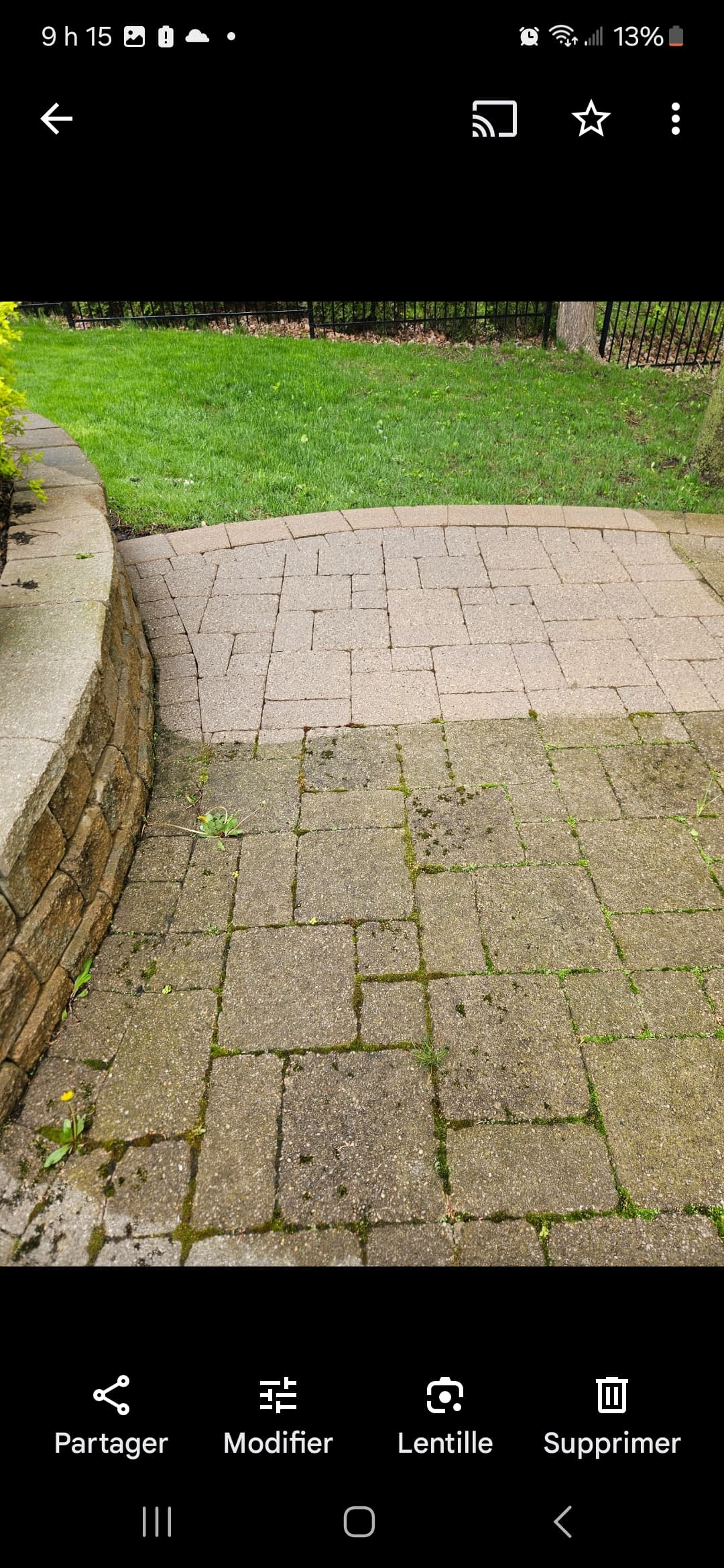

So 9 hours, 2 guys using surface cleaner then yellow tip then painter’s tool. 1200 square feet full of roots.

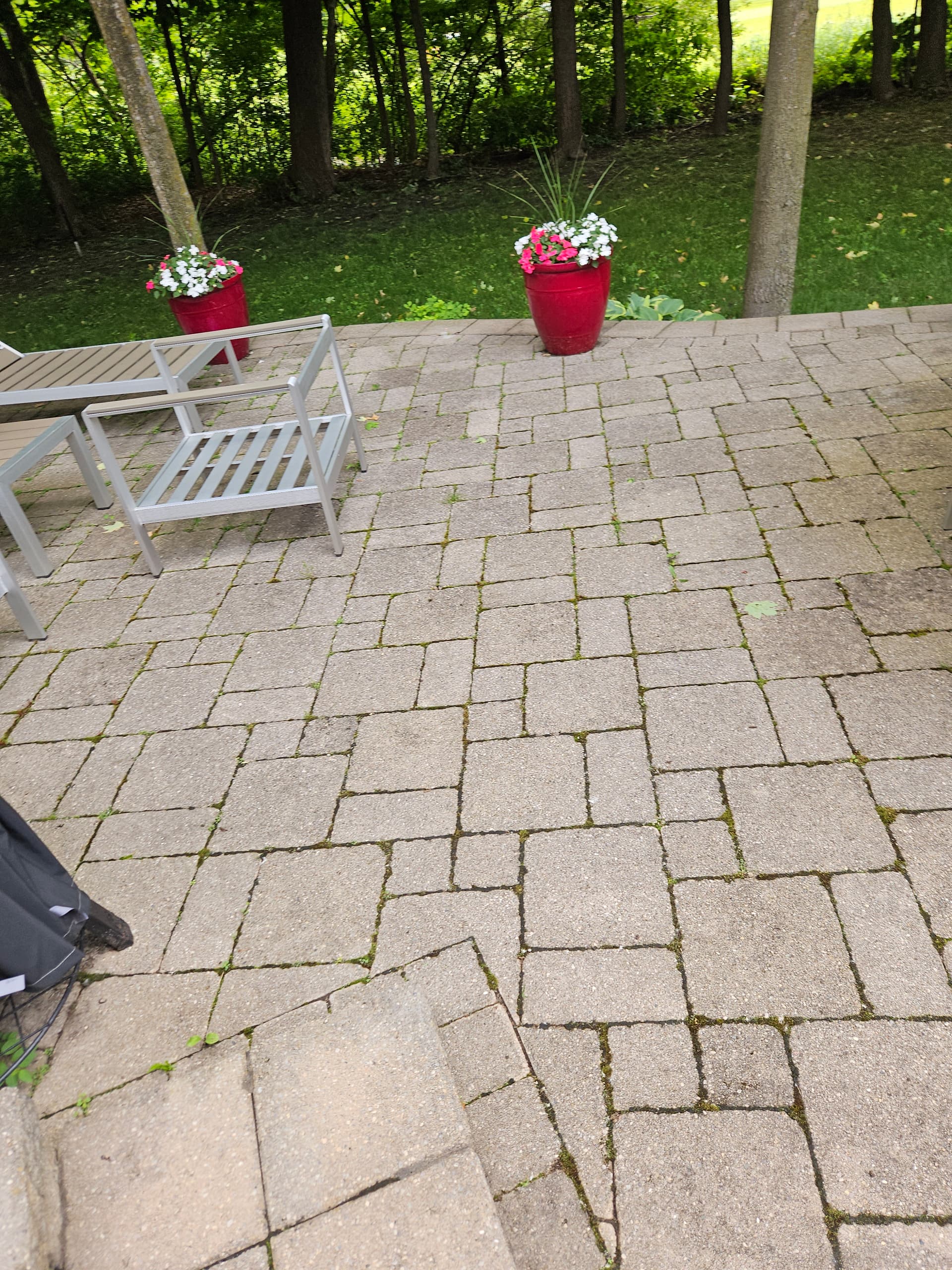

-what happens if some pavers move out of place/sink while washing the old sand around it? Is this to be expected? How should i fix that without it becoming a huge job?
  • the installation was done by a diy in some areas, it’s not great. In some areas spaces vary widely, cuts are crooked, etc. What do i do when space between two bricks is just hair thin? I don’t think poly sand will go in?
-is one day of drying enough before sanding?
Set clear expectations with your customers. Are you there to clean, sand, and seal, or to do a full patio restoration? In my experience, most customers are aware of the areas where their patio is failing. When I provide a quote that includes leveling or other repairs, it either makes them realize those details aren’t that important to them, or it ensures I’m fairly compensated for the extra work.
When applying sand, get it into every space possible. If the pavers are tightly butted up against each other but still surrounded by other pavers and sand (i.e., not on an edge), they are unlikely to move. Depending on the temperature, one day should be sufficient for the process. With temperatures hitting 80-90 degrees, my last three jobs the cleaning was finished by 11 AM and I started sanding around 2 PM.
