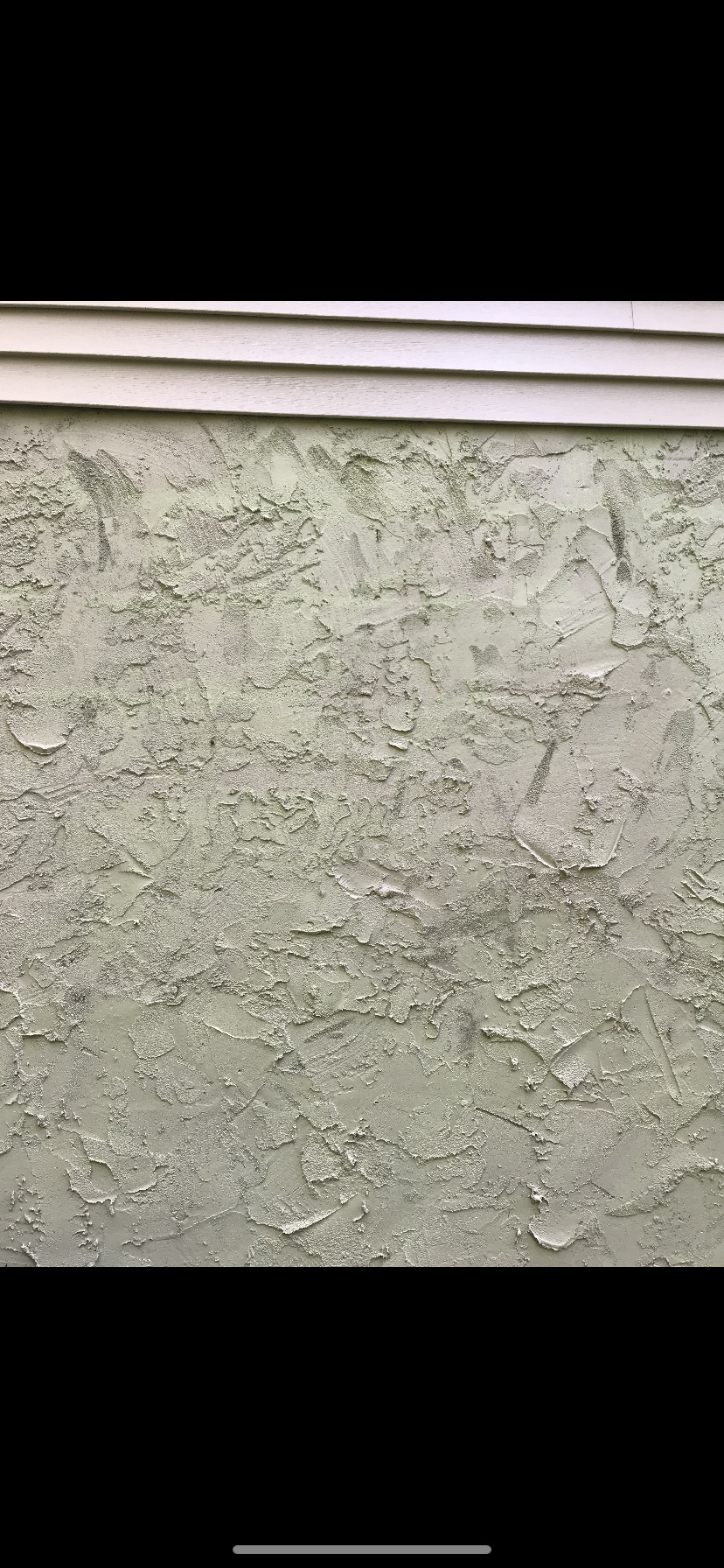

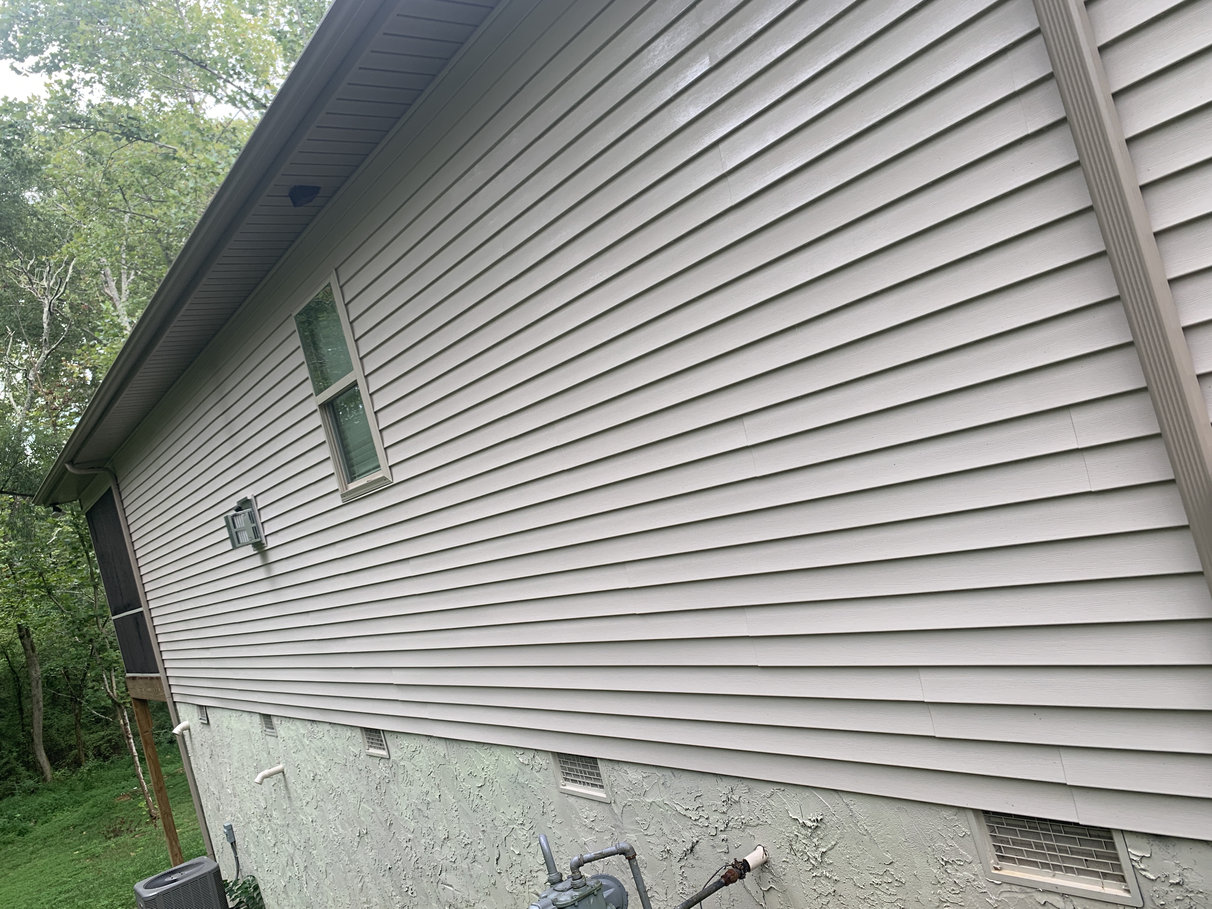

Recently soft washed my the side of my buddy’s vinyl house was getting grimy and green, everything turned out good and looked great rinsed and washed off all the sh and surrounding vegetation, a few days later he messaged me and said the painted cinder block wall turned greenish? not sure if this was dude to a reaction with the paint or me not rinsing enough? I’m new to this and I’d like to know if anyone out there has any suggestions, would like to know if this is something that can be fixed. thanks

It was just a grey/concrete color, you can see the original color in the picture compared to the greenish areas around it, I do know it was painted with Sherwin Williams paint
Probably bleached out or oxidized how hot was your mix? Did you use a surfactant if so what type? Also is the siding green above it?
I was using just household bleach for that one job he’s a buddy of mine so it was 6%, I used about maybe two gallons in a 13 gallon tank. I normally use 12.5 and never have any issues with it, I did not use any type of surfactant this was after the wash
I would think you might’ve bleached that out or caused some sort of reaction with the paint then, don’t know why it would be so uneven like that if you washed that part aswell, maybe one the more experienced guys knows something I dont

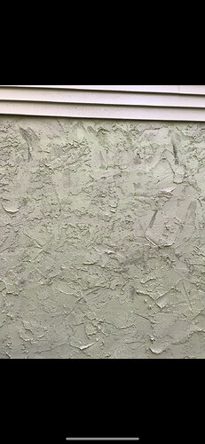

as you can see in the picture I took right after the wash it almost looks like it was already a little greenish? I’m wondering if that’s just how it is or if another soft wash or even a pressure wash would help it or make it worse, or any chemicals that may help as well, thanks for the feedback
Doesn’t take long to bleach paint, whatever happened definitely already happened in the post wash pic

That is strange. I’ve hit painted foundations with straight SH in a pump sprayer before and never seen that happen. Try treating it again. Any chance it still has algae on it? Either way it’s an easy fix to paint it. Better the foundation than the siding.
