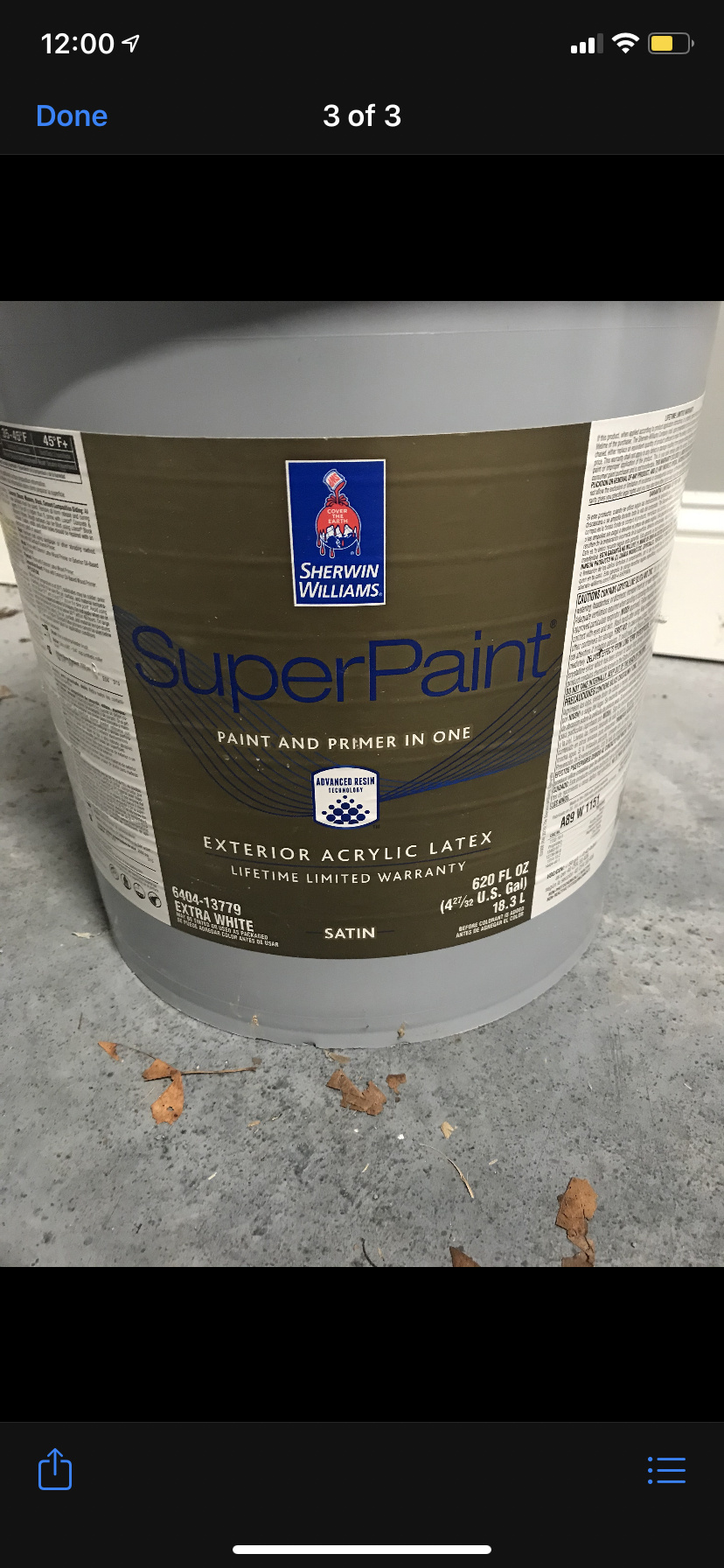

He’s got some left over, he said this is it

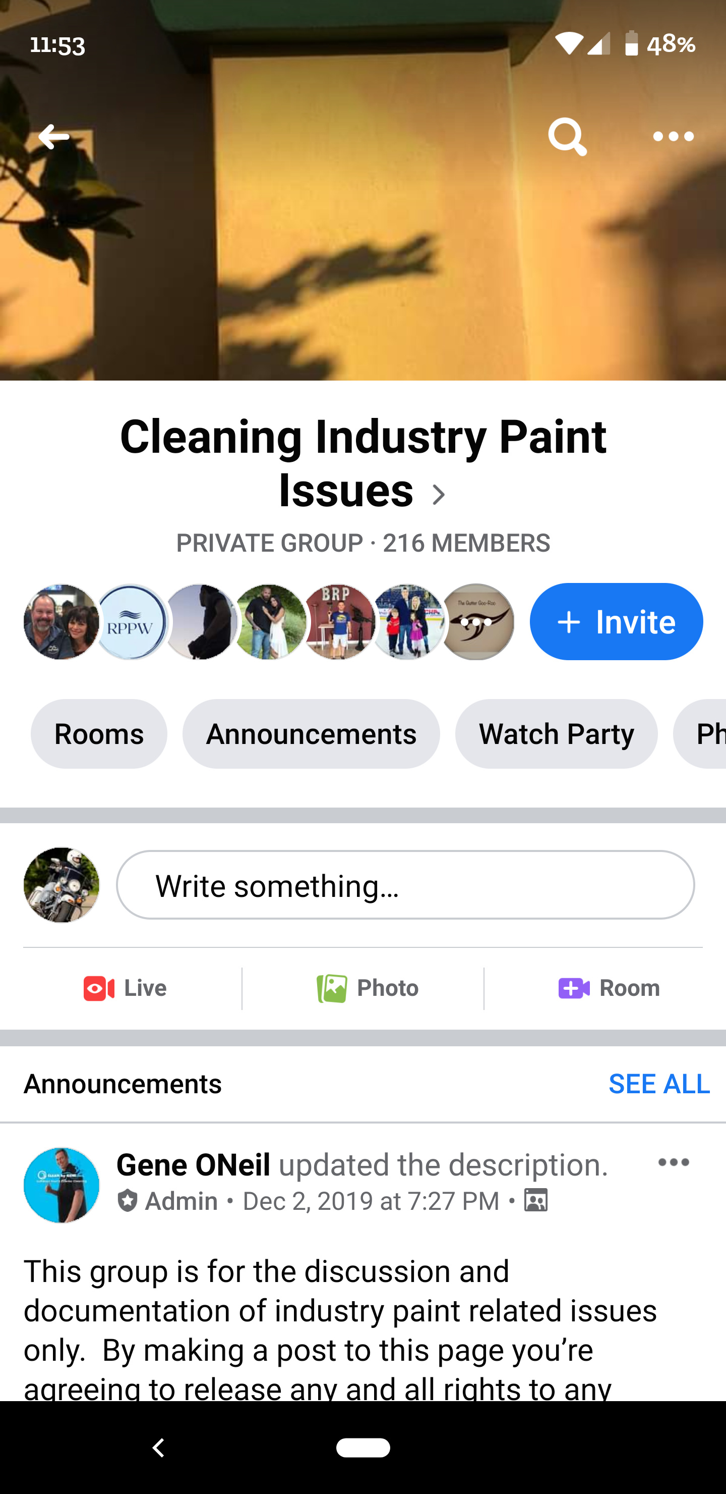

It’s a common issue. It will have to be repainted. If you hit it with 12.5, you’ll just make it even worse. SW paint has organic pigments and will change colors on contact with SH even mild mixes. Check out the Facebook group called cleaning industry paint issues for more information.
I thought it was only a few Sherwin Williams paint types not all Sherwin Williams paints. If it’s only certain ones is there a way to identify them from the can?

I believe the paints pigments reacted with the SH, causing the color change. Some, not all, SW paints have the organic pigments that react this way. Oxidation is a good guess but the vinyl above doesn’t support that idea. Bleaching out paint isn’t a thing. If you want to further prove the claim, hit it with a hot mix in an small inconspicuous area and see how it reacts. If it gets worse, repaint with a non SW paint would be the best route.

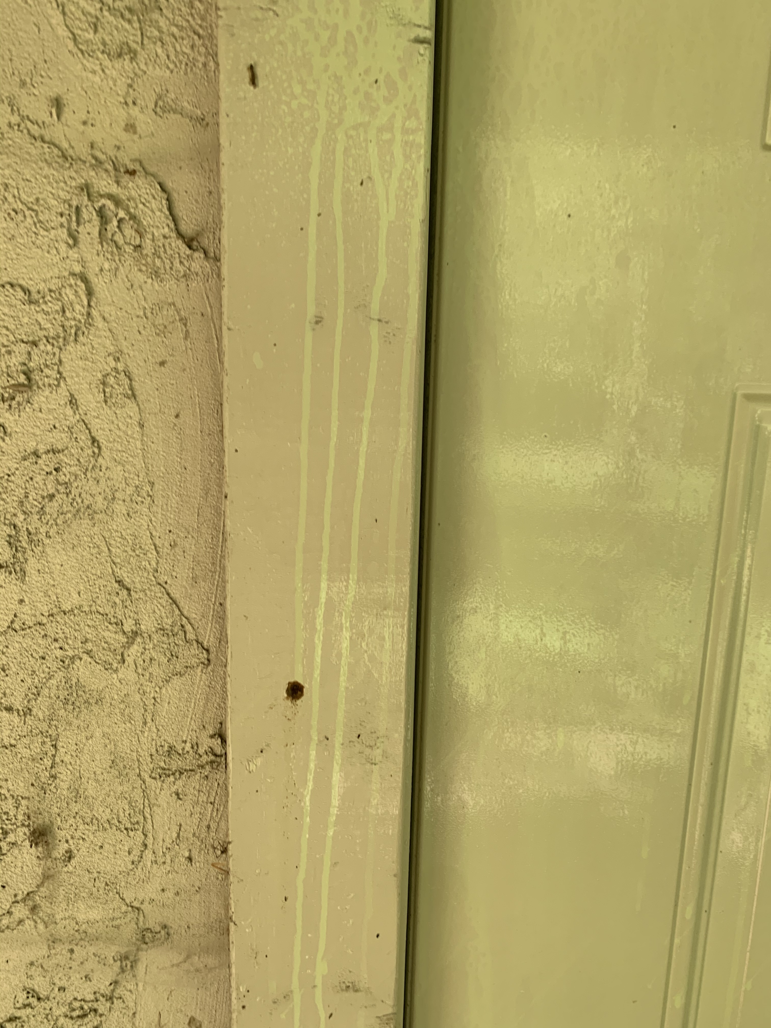

I went over and looked at it today, it definitely bleached the paint. There’s also spots the hit the back of the house where you can see where the over spray ran down. We tried a light mix in a pump sprayer on the back door to the basement and not even a minute later the paint was already spotting and streaking from the sh. I don’t want to risk making the side of the house any worse so I’m not going to re apply any more mix. I imagine so many home owners have painted foundations, painted wood siding houses, I was under the impression soft washing doesn’t damage that. Now I’m afraid if I see paint I won’t want to even touch it
I’m going to have to re paint it. Luckily he has left over paint from where they built his house.
