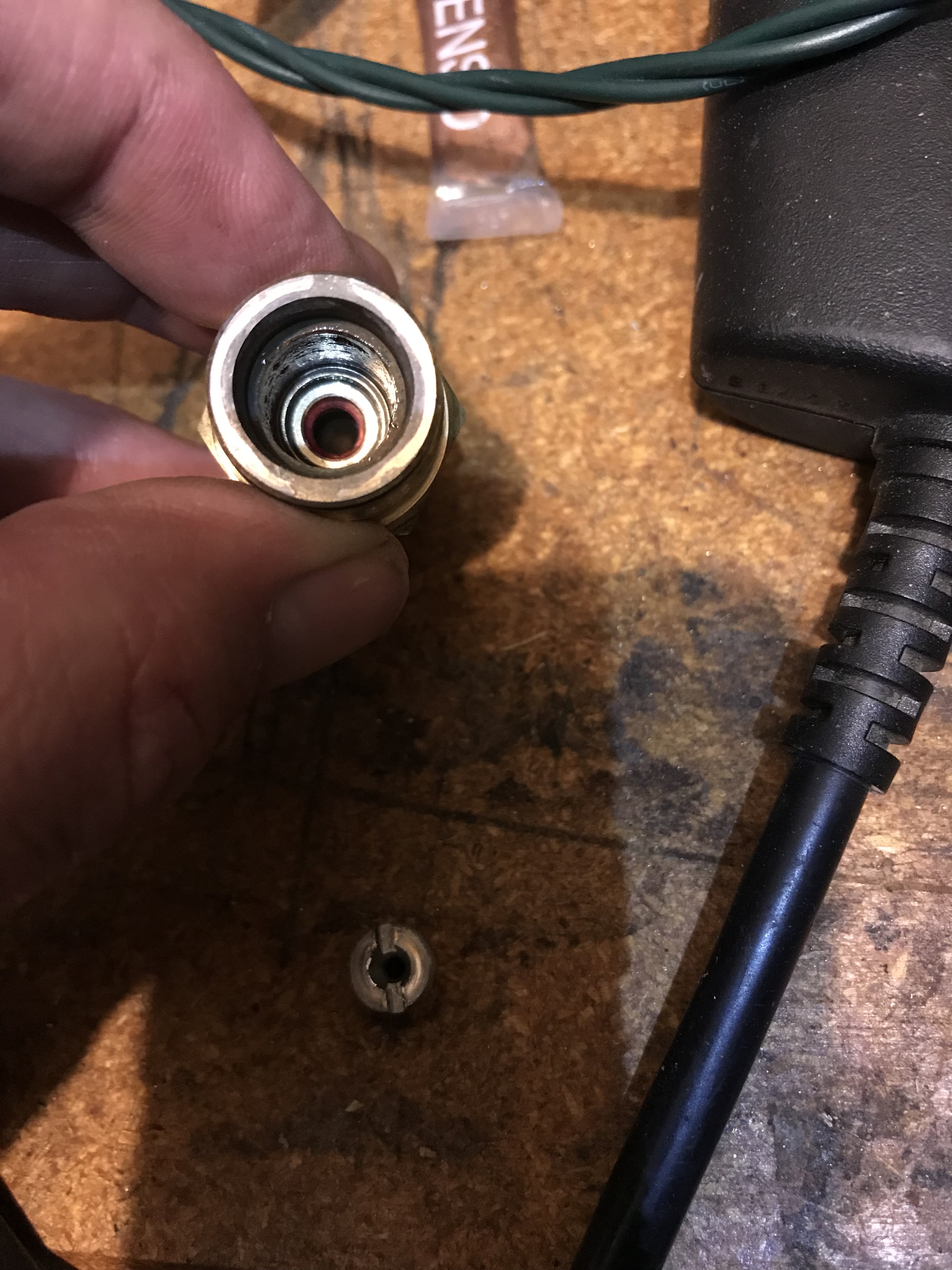

On the advice of more knowledgeable members I took my stock injector off the Cat pump and discovered it had a restrictive orifice screwed in.
I took it out, but will it mess with my unloader? I’m getting an add-on injector tomorrow, hopefully doing this correctly.

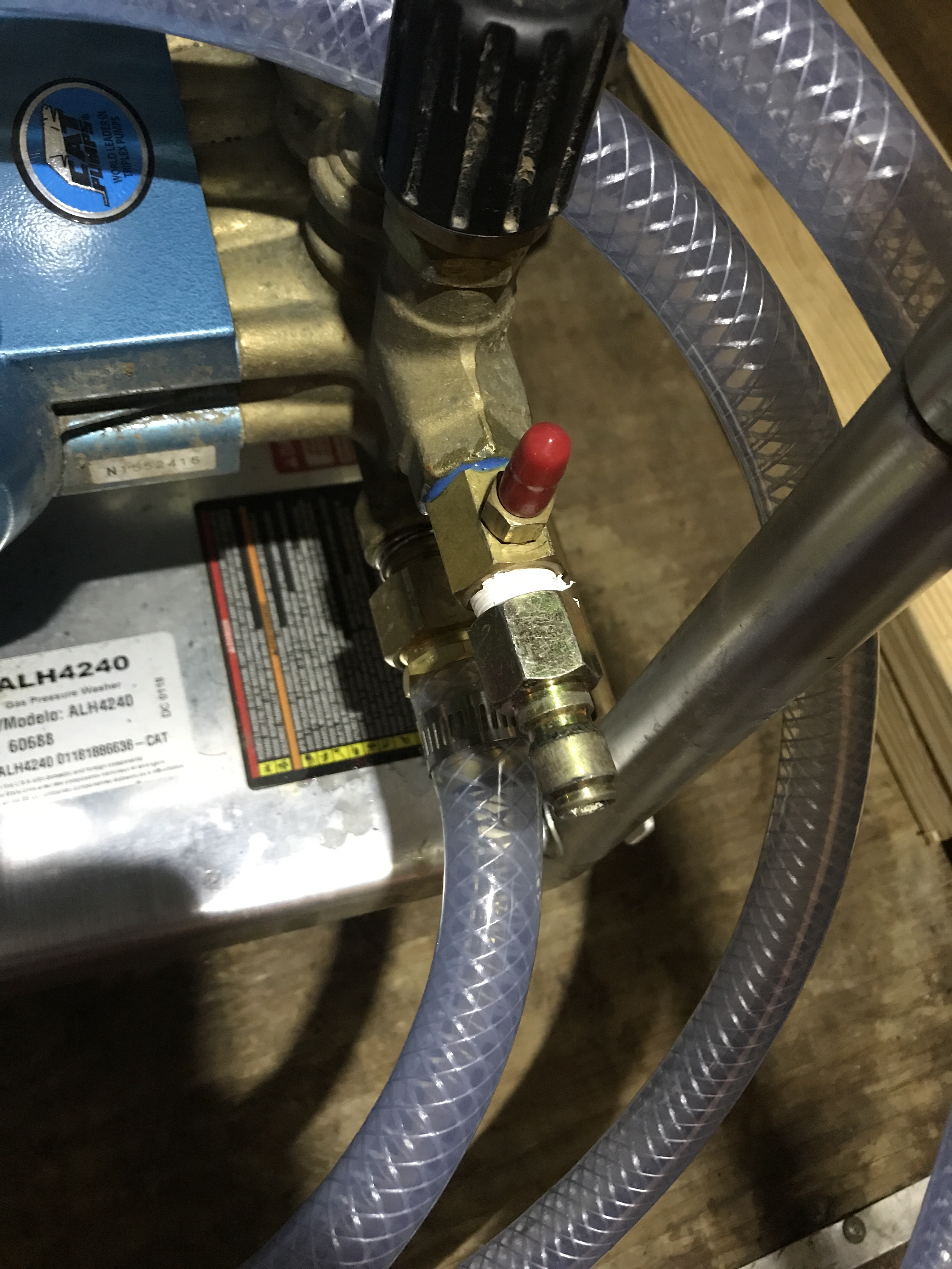

Do you have a photo of it plumbed? It looks like you could leave it off totally.
It has some sort of banjo style spring loaded valve with a rubber seat inside, I feel like it’s supposed to interact with the unloader somehow.

Thanks, diagram shows it’s a check valve, #443. I’ll just leave it be for now, at least the orifice is out.:flushed:
Do you still have your spring and ball?

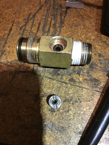

I hate cat… you see these threads. You need to find a male hydraulic fitting that fits these threads to a female fitting that fit the npt threads on the right to adapt it. Or your new one isn’t going to fit. Those ding dongs want you to buy their injectors which are probably garbage.
So again you’re going to need to find a hydraulic fitting, male with the same threads as on the left to female npt with the threads that are on the right to adapt your new injector. Two different threads. Pretty sleazy of Cat to do that because the fine threads on the left aren’t typical of common hydraulic fittings.
Or hydraulic fitting, male with the same threads as on the left to male npt then a high pressure female npt to female npt to adapt the two together to adapt your new injector.
Your best bet is to take your old injector and new injector to your local hydro shop, plop them down on the counter and let the wizard behind it find you two fittings to make your dreams come true. But don’t be shocked if they have to special order a fine thread hydro fitting for you.

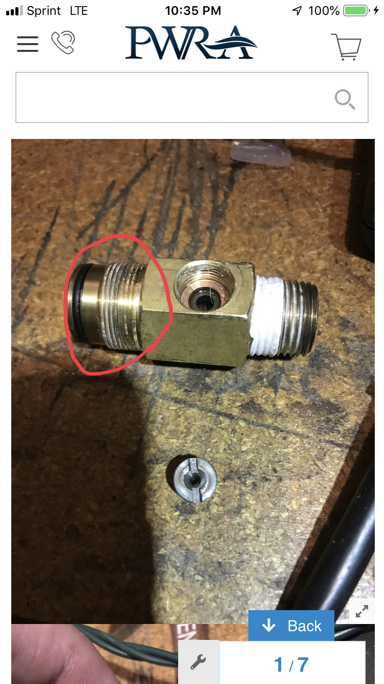

As Squid pointed out it’s not standard threads.
Look at the threads that @squidskc pointed out.
Because the unloader is threaded female in fine, parallel threads. Almost all injectors and QCs are NPT. He needs to adapt it.
