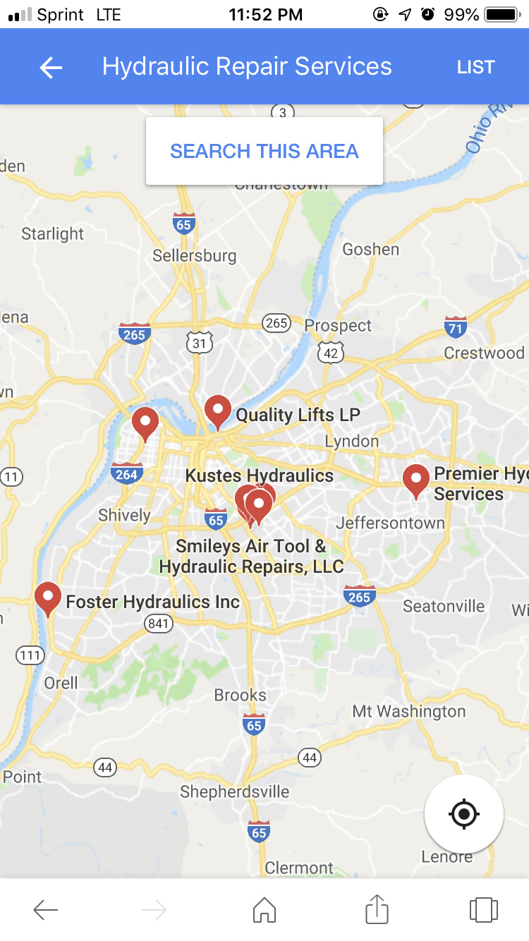

I’ll try, Louisville can be difficult when it comes to ‘specialty’ items.
Louisville Where
I’m an hour from Walmart or alike, in the middle of nowhere . Use that amazon prime. He did you’re research for ya .
You’ll be fine. There’s a ton of hydro shops near you. And now you’ll know where to go buy whip lines and get your hoses fixed when they blow.
Crap, just call Southside Equipment if your in Louisville Ky. They may have, if not, can sure tell you best place to go. One of the 3 biggest distributors around. If I lived in Louisville, they’d ban me. I’d be hanging around their shop all the time just to learn stuff.
