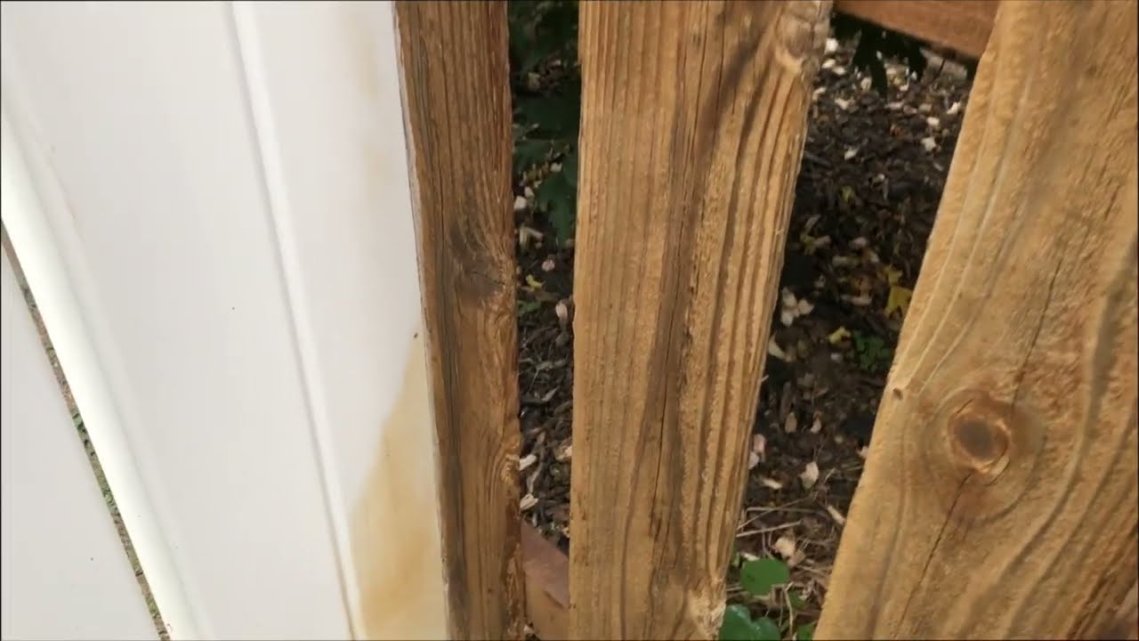

I used this on a vinyl fence two weeks after I stained the wood fence. The wood fence was my mom’s. Somehow I missed the overspray when I was cleaning up. And I noticed it when I was back at her house a couple weeks later. Kinda surprised her neighbor never said anything.
