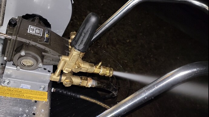

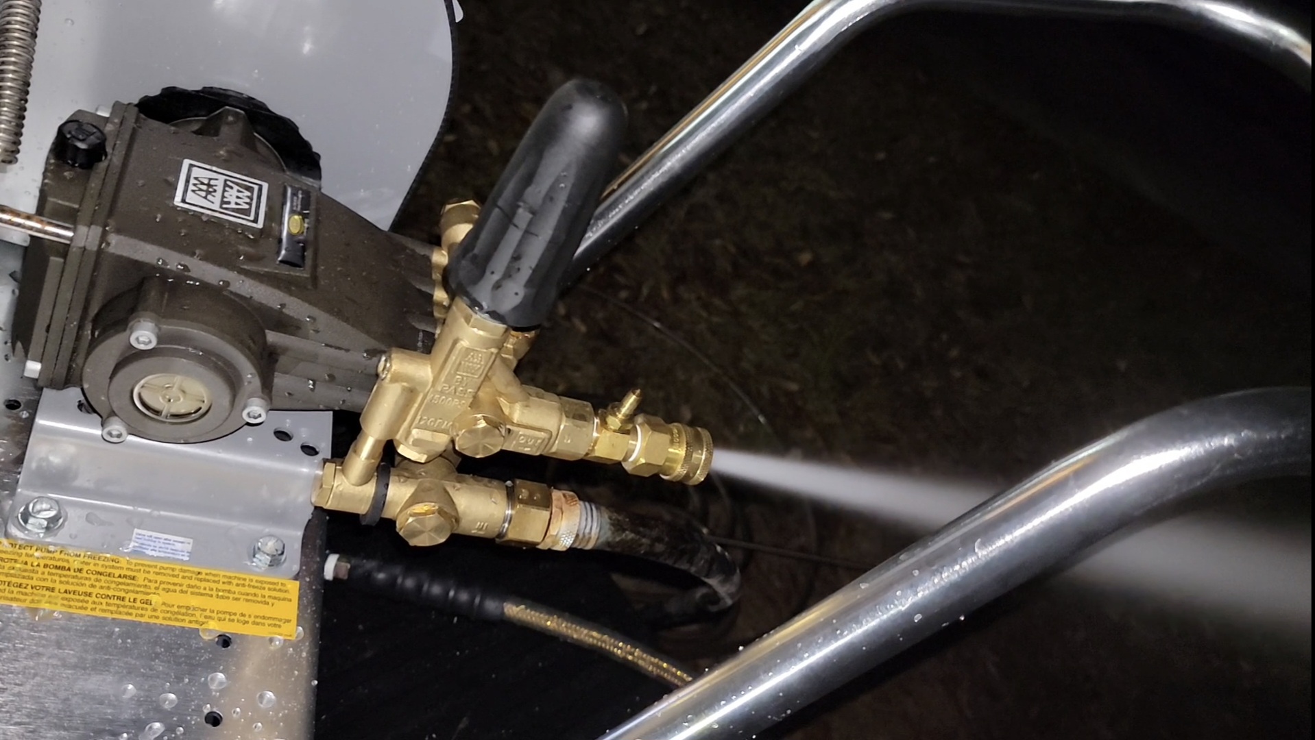

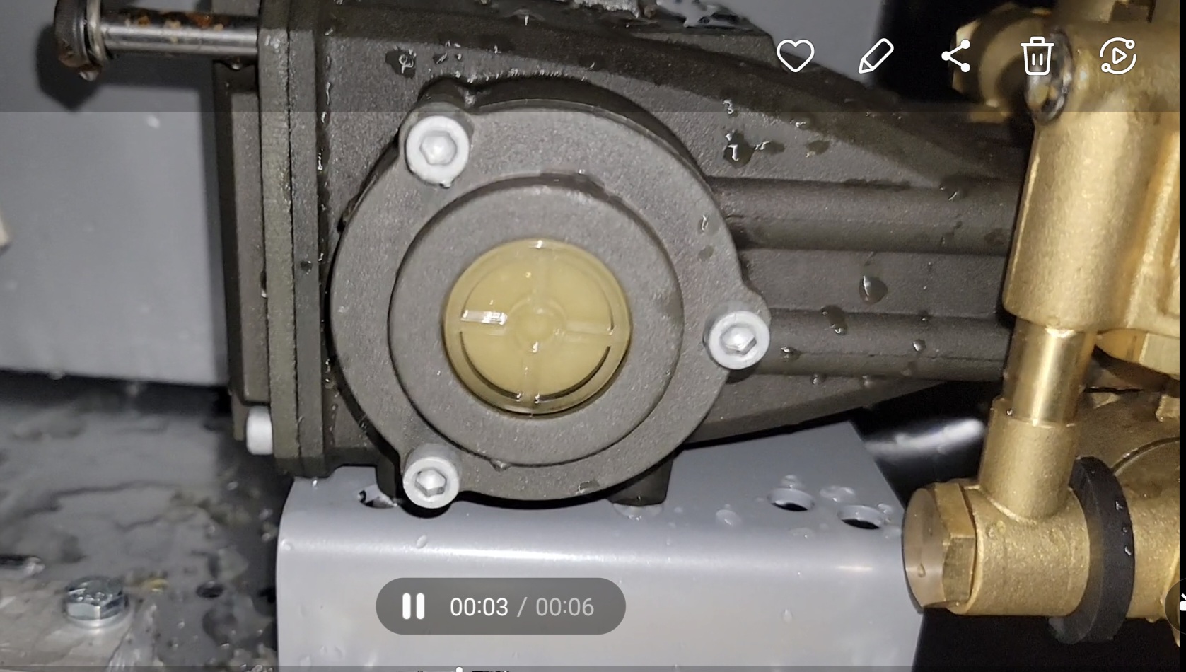

Problem: at first glance the oil in sight glass was a little over full… maybe a quarter inch over the bullseye… so I drained just a smidge until it was dead nuts in the center… started the machine for the first time, and had no pressure… looked down at the pump and there was no oil in the sight glassšŸ˜¬ā€¦ shut it off immediately, it ran for all of 5 or 6 seconds… so I picked up some 30 weight ND oil and put it back where it was before, just above the bullseye… also unplugged the pressure hose and let the water run through for a second to make sure no air caught anywhere… started it up without the pressure hose on and it blew the water out under what seemed like great pressure but when I looked down at the pump the sightglass was completely full and the oil looked aerated and frothy… shut it off immediately, this time it ran for maybe 7 or 8 seconds… been about a half hour since it ran and the oil is slowly clearing up as the air goes out of it… level is still what i would consider a little high… but its as it was when it arrived, and again when I set it at the right level before when I started it the oil level while it was running was low. Seems like such a simple thing to be having issues with. Really hope its a simple/stupid mistake on my part… and therefore easily fixed.

Machines on carts tend to vibrate a lot and that’s just aerating the pump oil. No biggie. Perfectly normal. Don’t worry too much about how much oil is showing in the sight glass when the machine is running. Check the sight glass every time before starting the machine to verify the oil is at or just slightly above the center of the glass and you’ll be fine.

Thanks man! Glad to know I’m not going to have to go through returning it. As far as the lack of pressure. I bled the line w/ just the hose pressure for a couple minutes… it seemed like it was continuing to get a small amount of air in somehow… it would just sputter intermittently, but I fired it up anyway and it worked just fine. So that was a win… thanks again for your help.
Quick question… what kind of pressure would you expect out of the end of a wand w/o a tip in place?
A few hundred psi maybe. Not much. It should be a somewhat solid stream so if it’s spewing erratically then it’s probably sucking air in somewhere. I’m not a huge fan of hooking a garden hose directly to the pump. Those little fittings just aren’t very well made and it can be hard to get one to seal completely. May have to swap the gasket out for a better one.

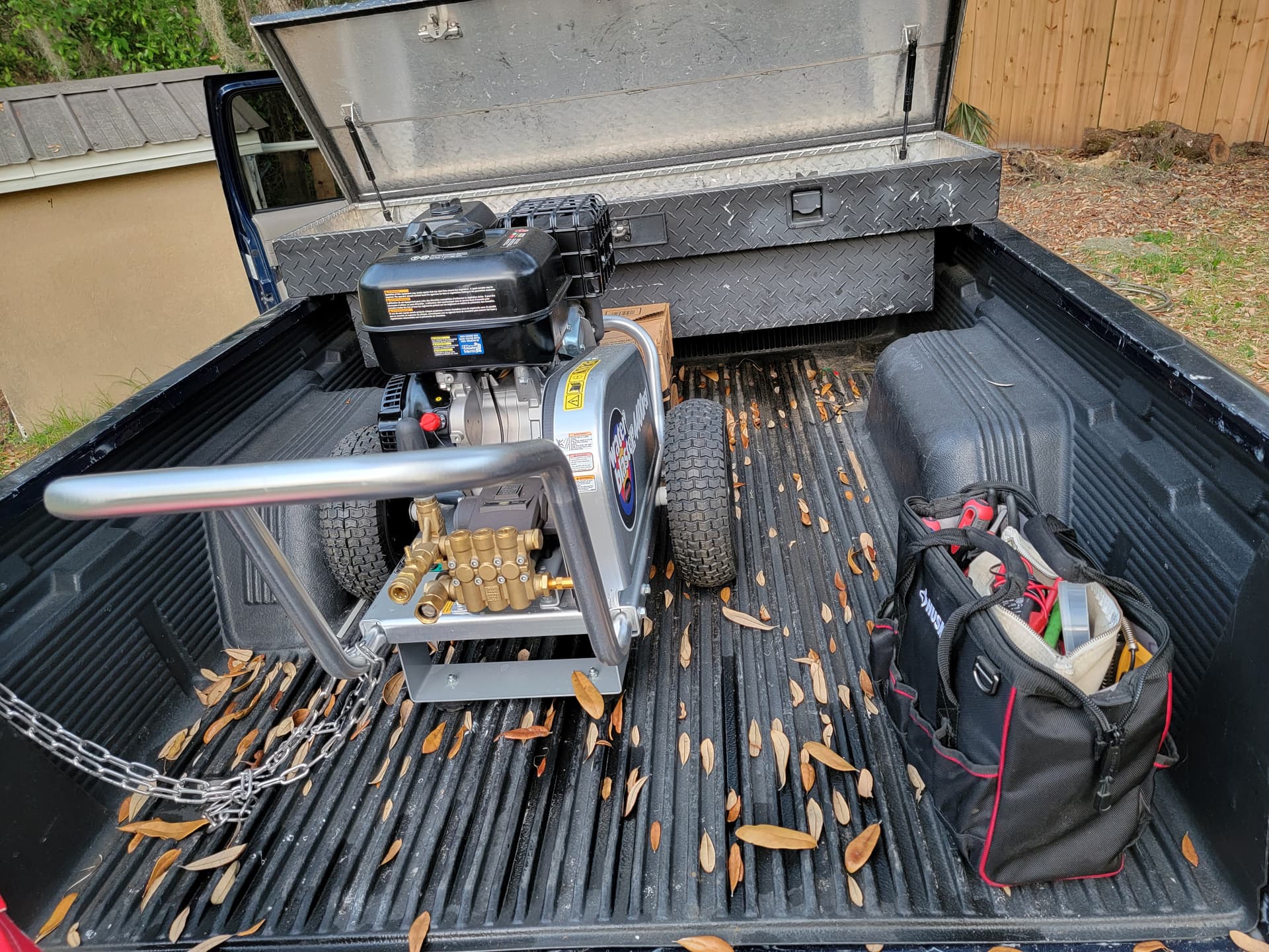

Post some pics of truck and setup so I can see what type of room you’ll have and then can give you more specific recs.
Thanks for the help! Will do on the whisper wash. Ive had several ideas on how to lay out the back of the truck… most w/ the two reels facing out the back, one on top of the aforementioned diamond plate box for the 12v setup… but as of right now its a blank slate. The toolbox is obviously coming out. Debating 55gal barrels as resevoirs? This is going to be a one year setup, I fully intend to buy a full size pickup w/ either a skid, or possibly a trailer. So investing the money in the tanks didnt seem worth it to me… but, please feel free to weigh in. Appreciate any advice.
Excuse the mess… just bought the little thing, desperately needs a cleaning… I also have to put a new headliner and replace the drivers door panel, and few other small plastic interior pieces, but its all on ebay… and I dig custom headliners anywayšŸ’Æ
