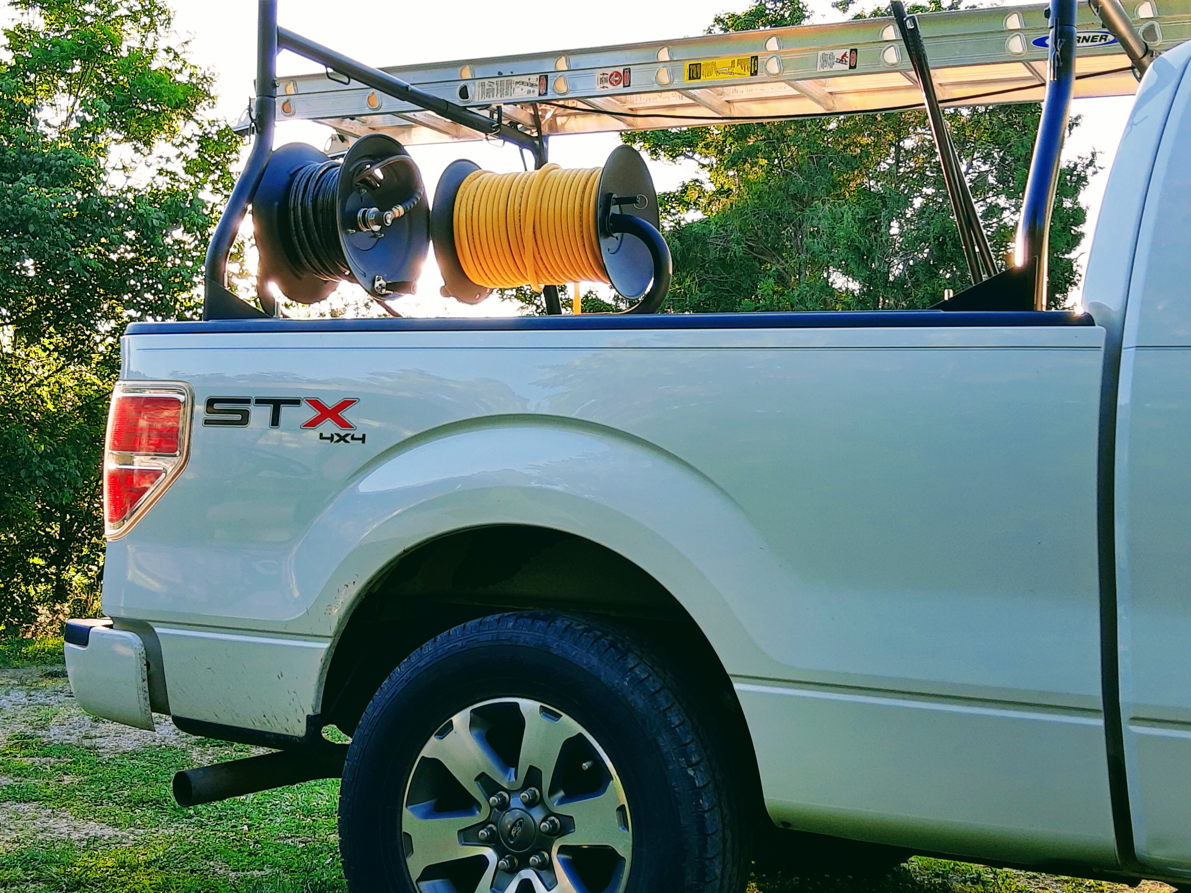

My name is Jeff, I’m in Virginia, near Roanoke. I have been reading a bunch on here and decided to introduce myself. I started a SW and PW business, an LLC, this spring, got insurance, built a skid unit for the pickup truck, and have done a couple of house washes and some gutter cleaning jobs.
I joined Home Advisor to get some exposure and customers, and have received some leads from them, plus some word of mouth referrals. I made a Facebook page but I really don’t spend much time on there. My yard signs finally arrived so I got those available now.
I have a day job in human services which is not a typical 8-5; sometimes I only work 3 days per week. So that’s why I started this business, I was bored, and liked the earnings potential.
In building my SW unit I realized I’m no plumber. I used to be a heavy equipment mechanic and did a lot with hydraulics, but with this project I seemed to run into challenges at every turn. But it works, with 150’ of 3/8" hose and my homemade PVC wand. I’ve only used the pressure washer for concrete.

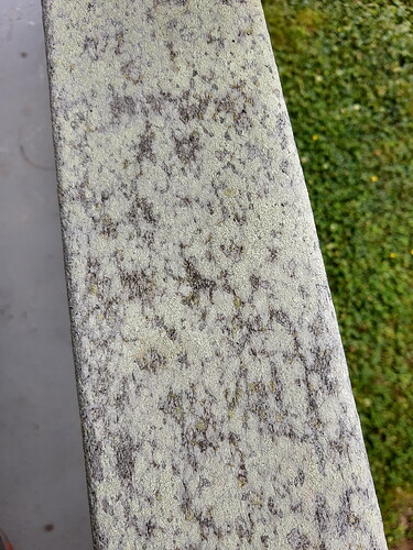

I looked at a house yesterday that has two issues that I’m puzzled about. One is the plastic deck, you know, the fake wood. Not only is is moldy and has lichen growing on it, it’s very oxidized, I can scrape material off with my fingernail. I can remove the organics with SH, but that’s as far as I think I should go. Anyone have suggestions for cleaning weathered fake wood and not disturbing the oxidation?

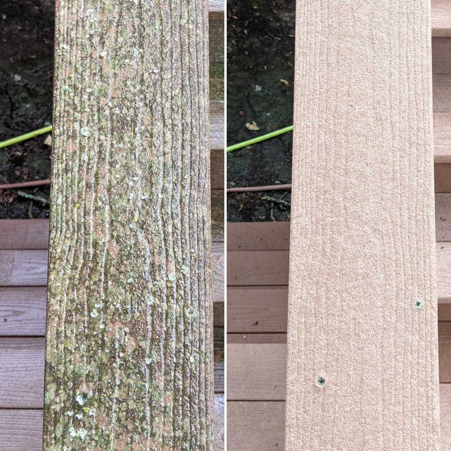

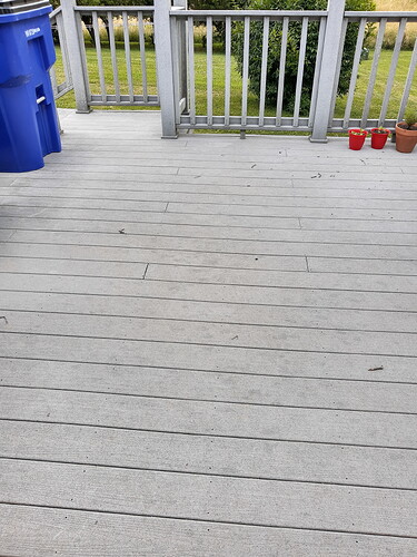

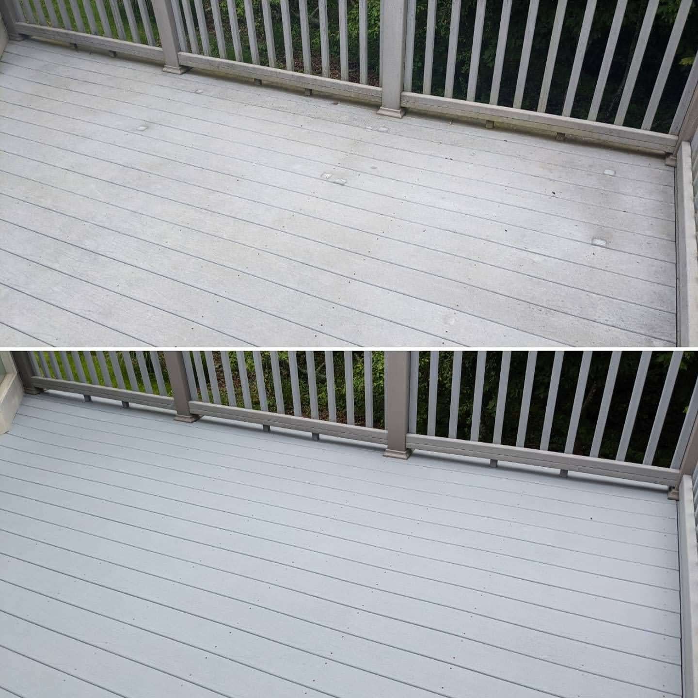

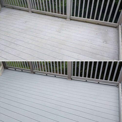

This is a close up of the handrail, and a wide view of the deck. I’d say this deck has some age on it. Thanks Racer for the reply.

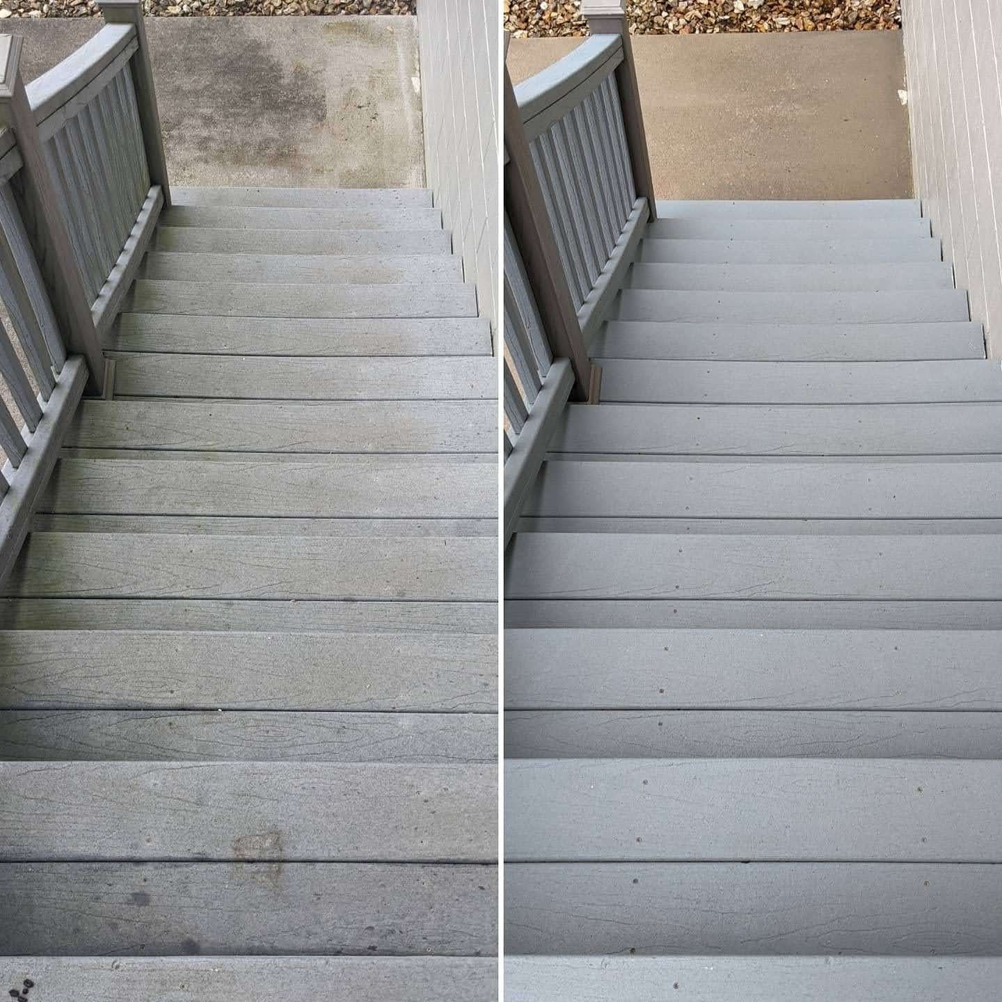

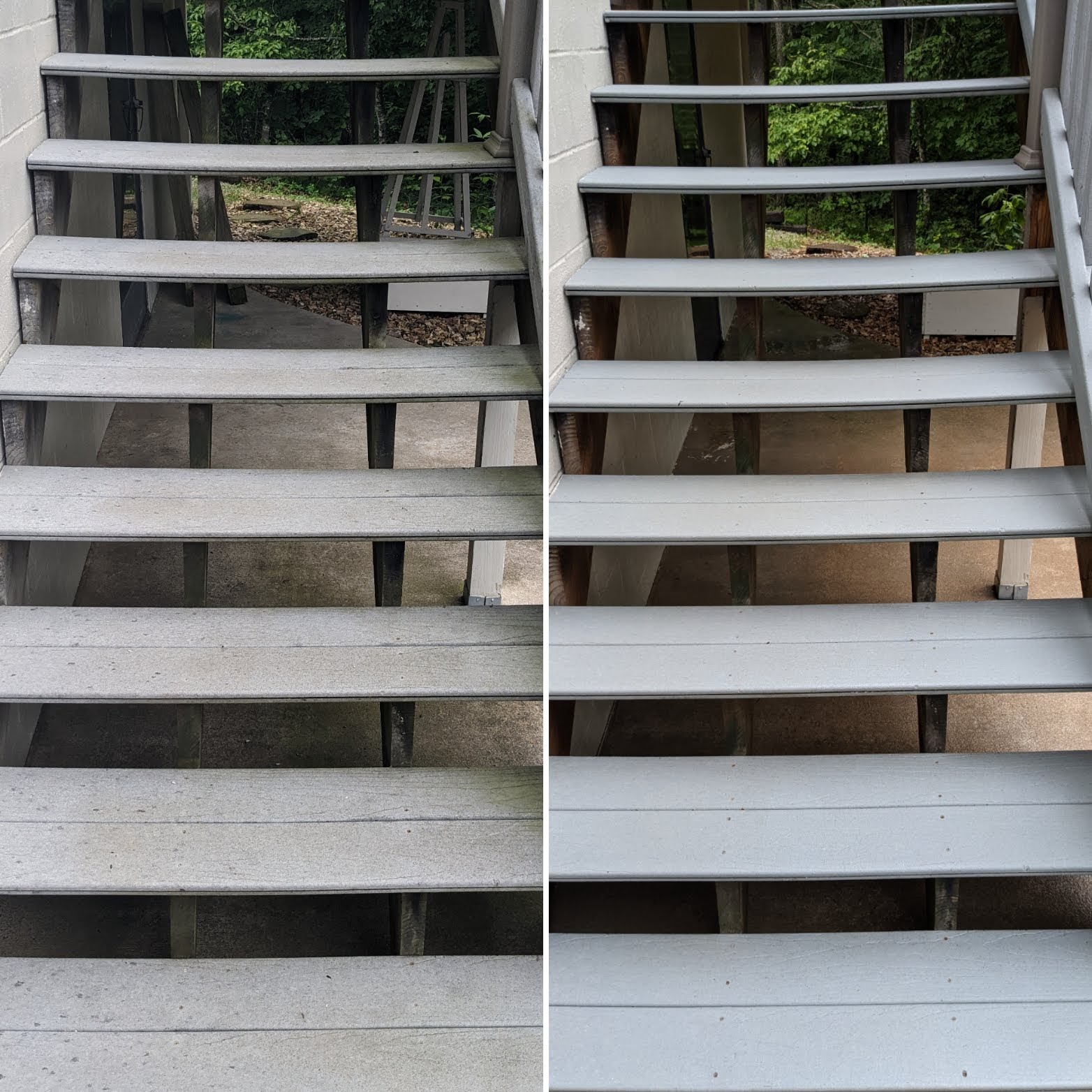

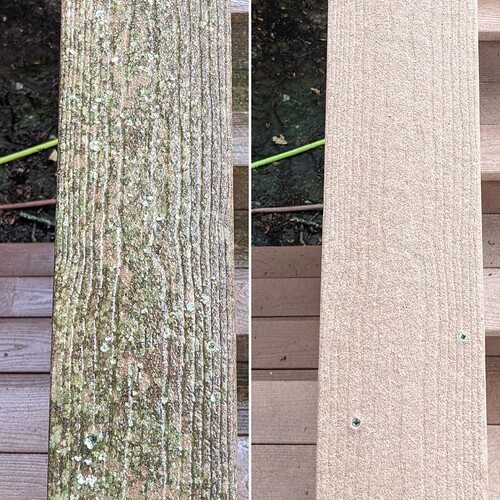

That’s not too bad at all in my opinion. Here’s one I just did on Saturday. It had lichens all over it. Yours should clean up nicely.
They look even better when they dry but I don’t stick around for that most of the time.

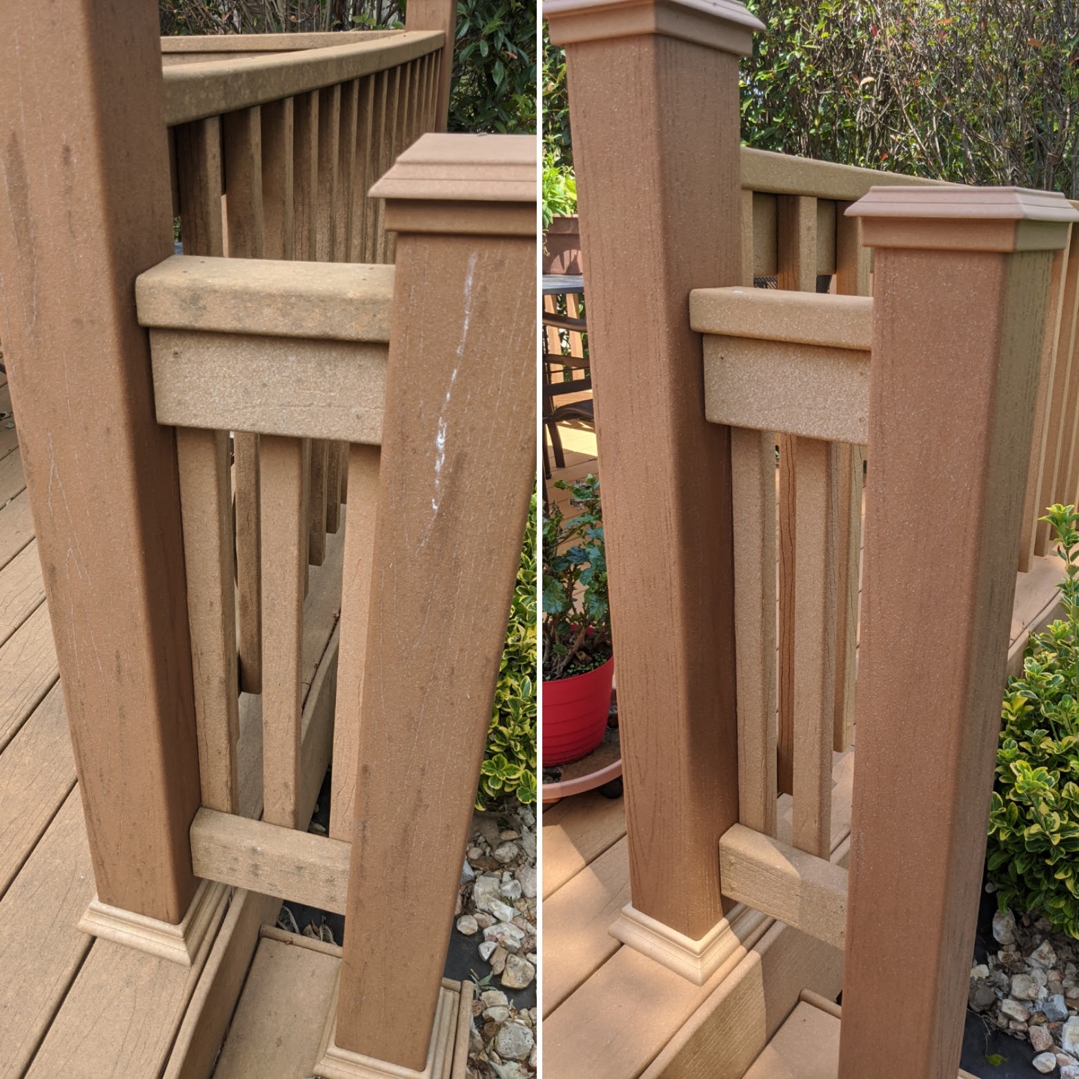

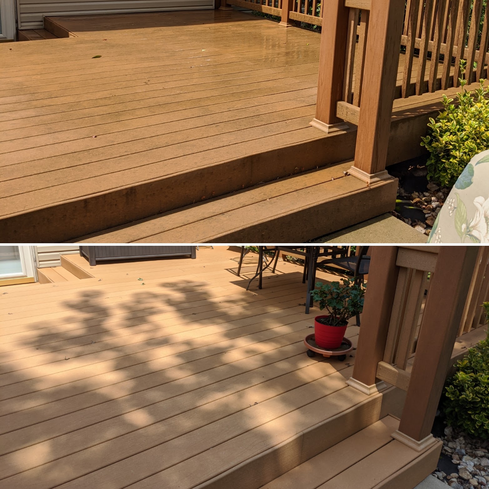

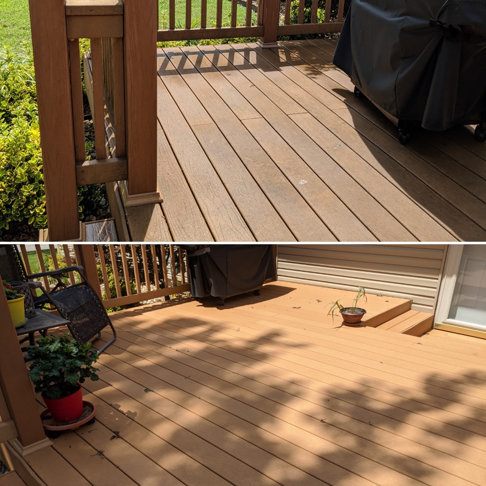

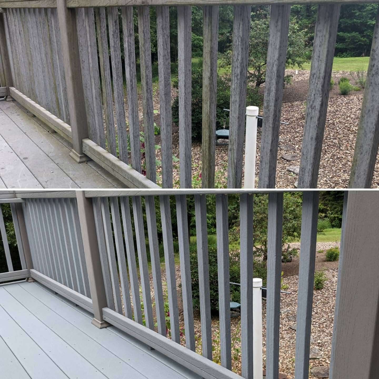

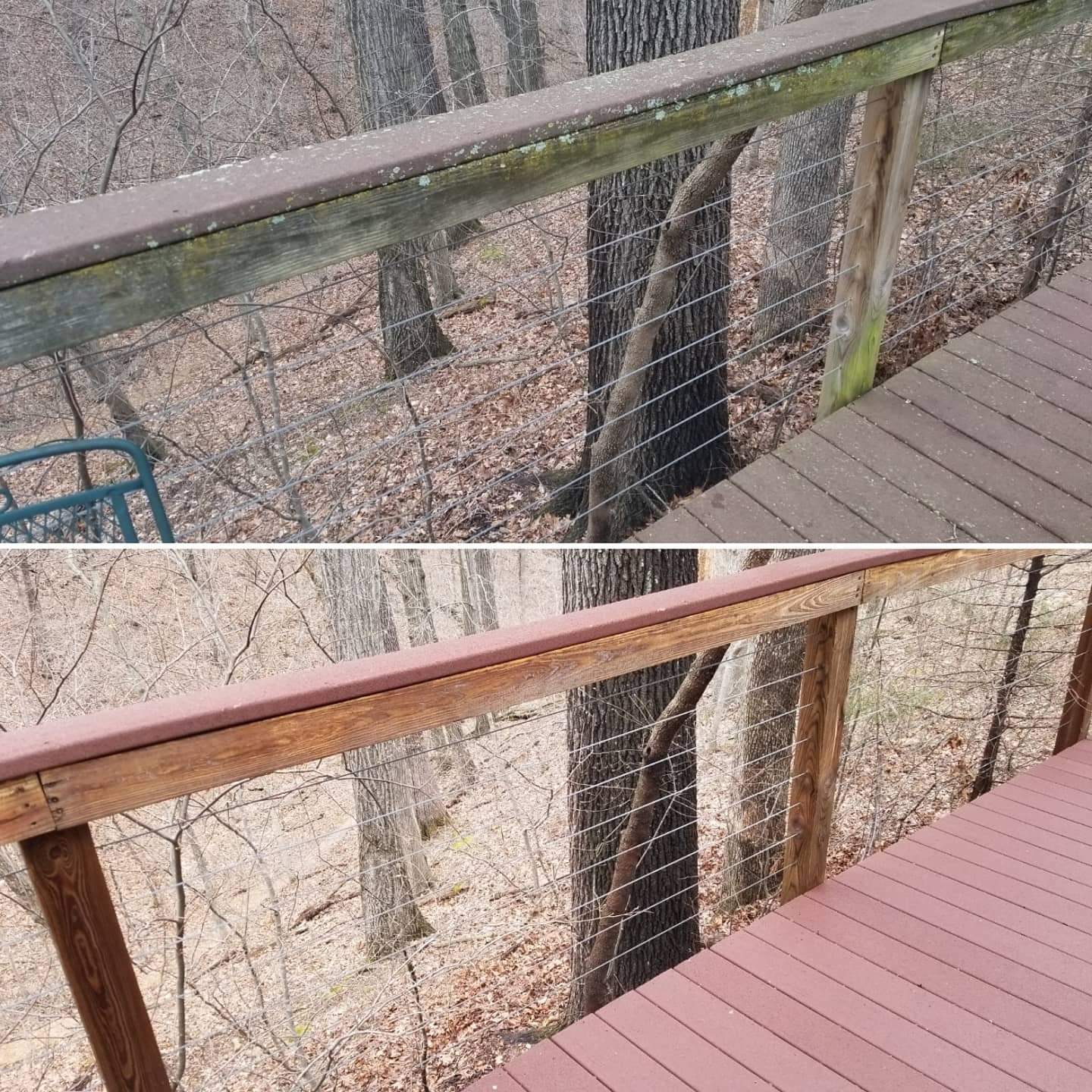

Oh here’s one I did a few weeks back that I believe is the same color as what you have there. I’d probably start at 3% and go from there.

Dang! Did you prewet it, use a brush?

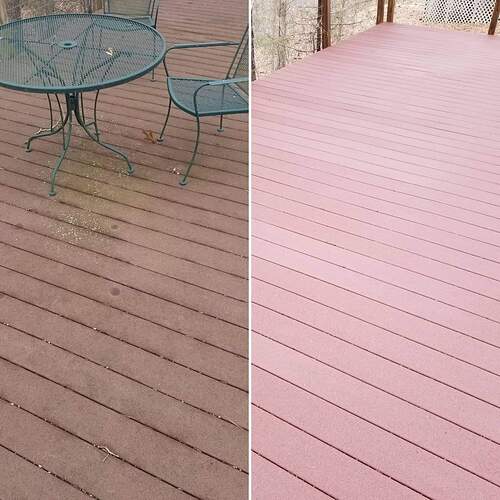

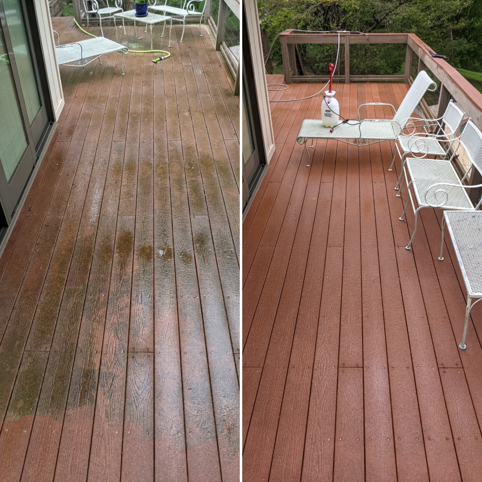

No brush. Quick prewet (like the Flash quick if you’re using 8gpm like I do), start at 3% and go up or down depending on dwell (do a test spot first), 1000psi wood tip on my JROD, and then a thorough rinse. I’ve done probably a dozen or more composite decks with this method and they always clean up beautifully. I’ve changed phones a few times in the last few years but I’ll see if I can find some more pics somewhere for you.
I would not have dreamed that SH and lots of water could produce such results. Feeling much better about this project. Thanks a bunch.
No worries man. I prefer cleaning composite to cleaning real wood. It’s much less tedious and you can really move. I use a 12v for deck jobs and I usually go about 1/3 to 1/2 an ounce of surfactant to gallon of mix to cut down on rinse time. Just shoot for a 7-10 minute dwell time and you should be golden. Good luck with it.
