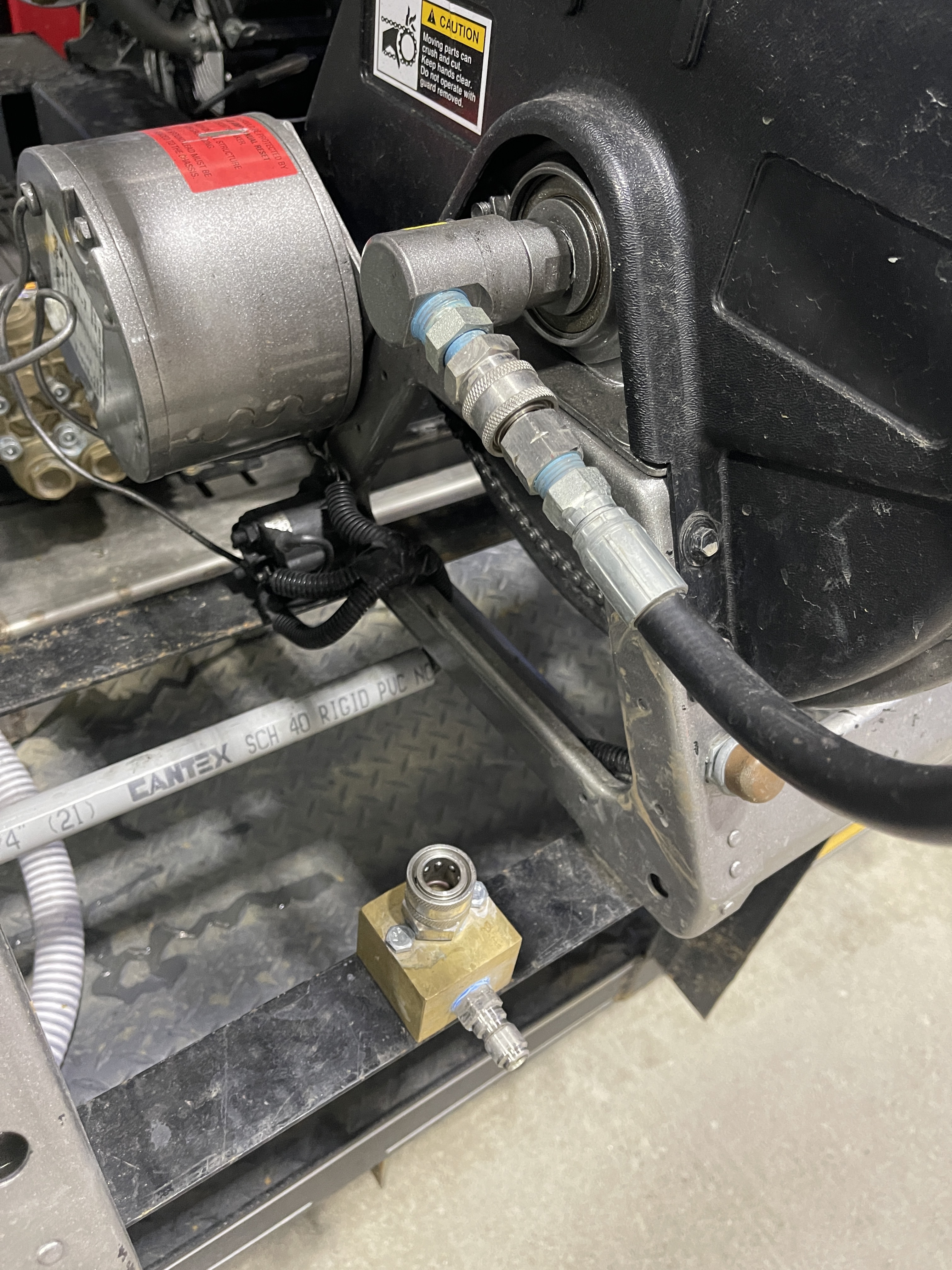

@DisplacedTexan I have a 150 foot section and then 100 foot section. All the hose gets pulled off the real and if I just need a 100 foot section then I disconnect it and plug it in my unloader block and then I disconnect the whip line off the reel and put it in the unloader block to bypass the reel and hose.

If someone can tell me how to lock a hannay electric reel
I’m all ears. I was going to make some sort of pin spring contraption to stop it but can’t figure it out
Send me your address and I’ll send you one
Did you buy them or make them? How much do you you think it effects the electric reels since there is already a good amount of friction from the chain
I don’t have locks on my electric reels, never needed to. With the chain it seems like they don’t go anywhere, I have to pull on the hose to get it going, so…
Hannah makes them. I bought and sold 6 Electric reels in less than a week once I found out they were dangerous and slower than a normal reel. I’ve learned a lot of things the expensive way.
