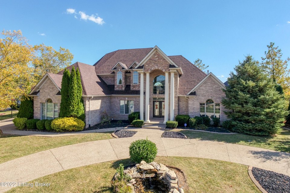

2-3 story gutters. My shoulders aren’t what they used to be.

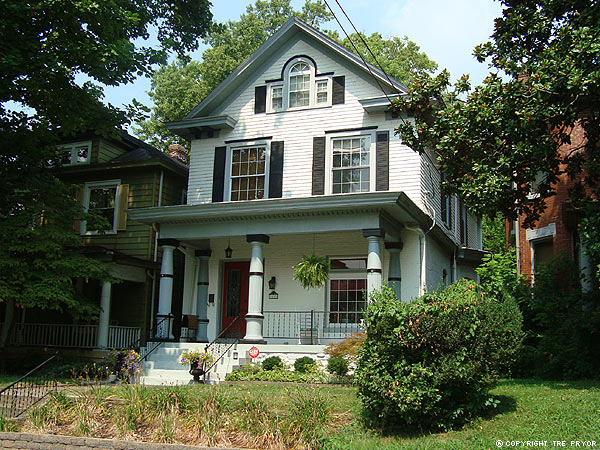

Typically 3 stories in the back.
The really bad ones are in the older part of town where there is about 8’ between houses and are 3-4 stories tall.

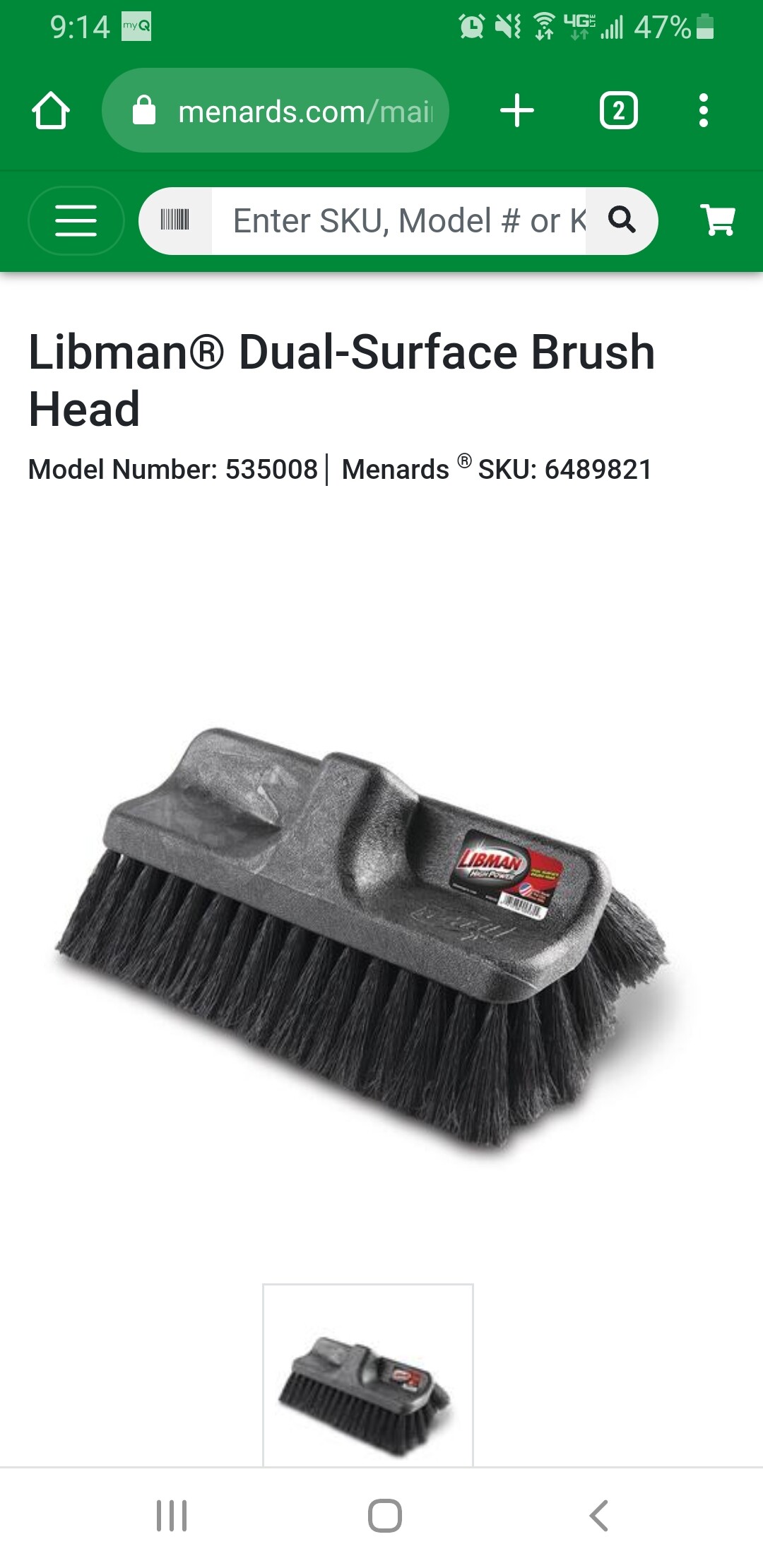

I use a Libman brush on a 8-24’ extension pole. You don’t need to scrub hard, just a quick wipe gets them clean.

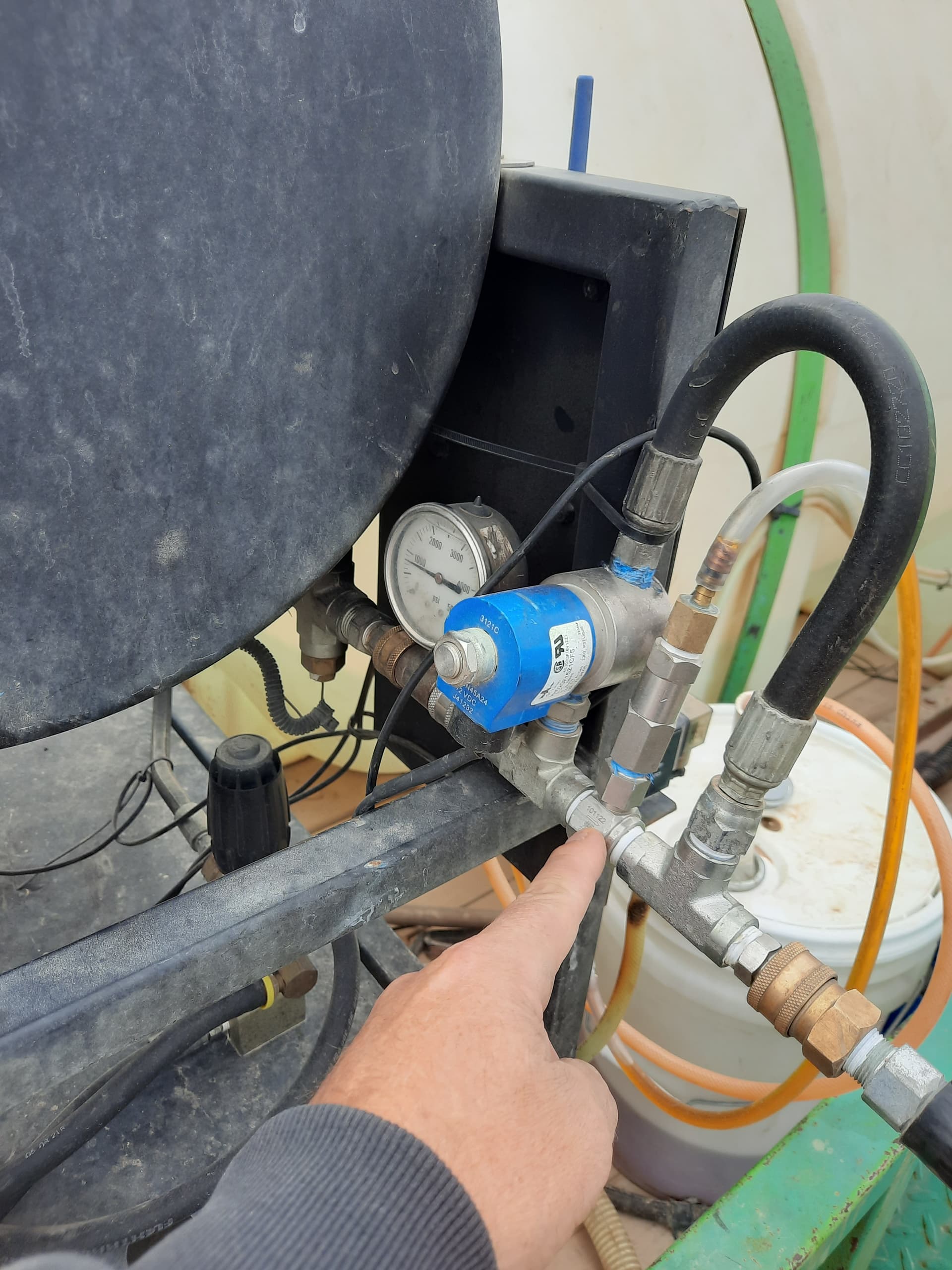

My 12v booster system gives my the same pressure no matter what the spigot pressure is. I’m always boosting to 95 psi (I’ve changed this a few times +/- 10psi) and while spraying I maintain 70 psi.
But you are right, varying pressure will change ratios. It will draw stronger at lower pressure. This is also why the nozzle size has to be right. Any smaller nozzle size and it won’t draw anything.

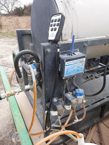

Well I want the first one dangit ! Im going to put it right there.
To make this 3 chem remote system even more bulletproof
How often do you have problems with that check valve on your DS injector? I’ve only heard second hand about how problematic they can be. I even heard some don’t work even when they are brand new! The check I’ve engineered into this DS injector is truly ROBUST. I can see you easily wearing out a few nozzles before you have one single issue with the integrated check valve. Even after a few hundred cycles the seal kept getting better and better and with no spring to go wonky there’s a slim to zero chance you’re going to accidentally dilute that pricey acid you use.
We change them out about twice a year. It starts to let water back to our chem tanks, then throw them away and buy more from dultmeier. We rinse them out every day.

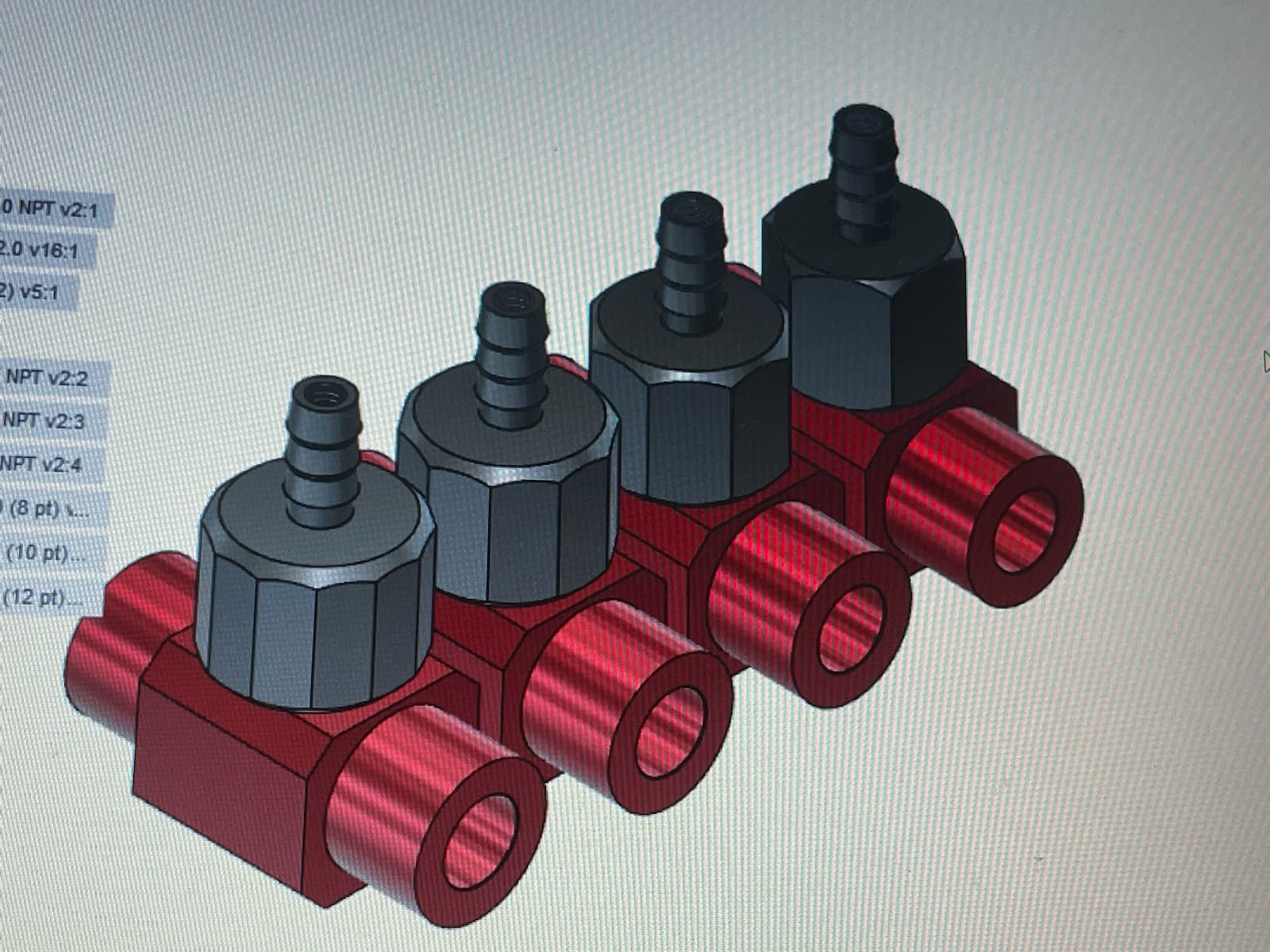

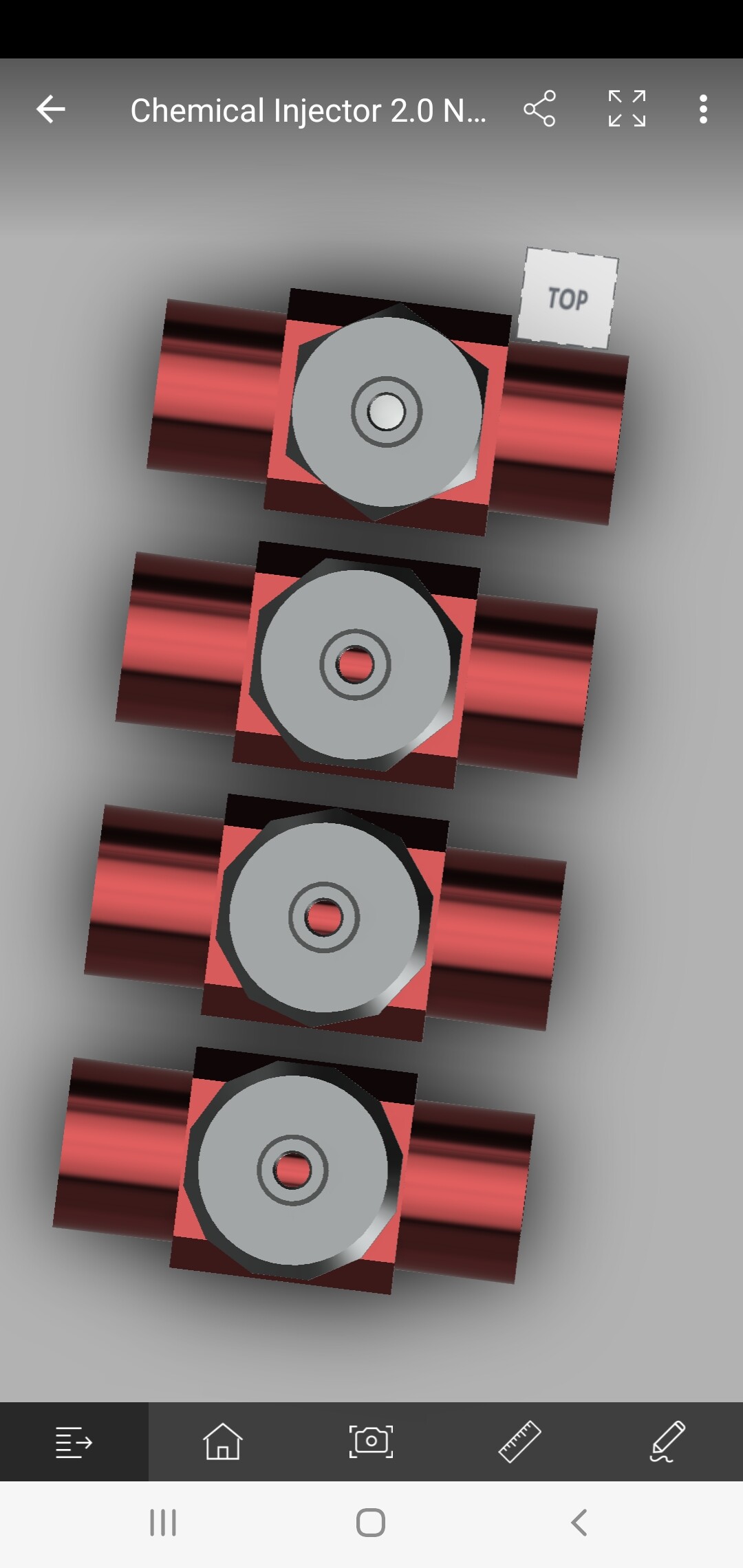

@Firefighter4hire Went with the octagon check valve as the sides will line up with the block and its not as busy as the decagon
