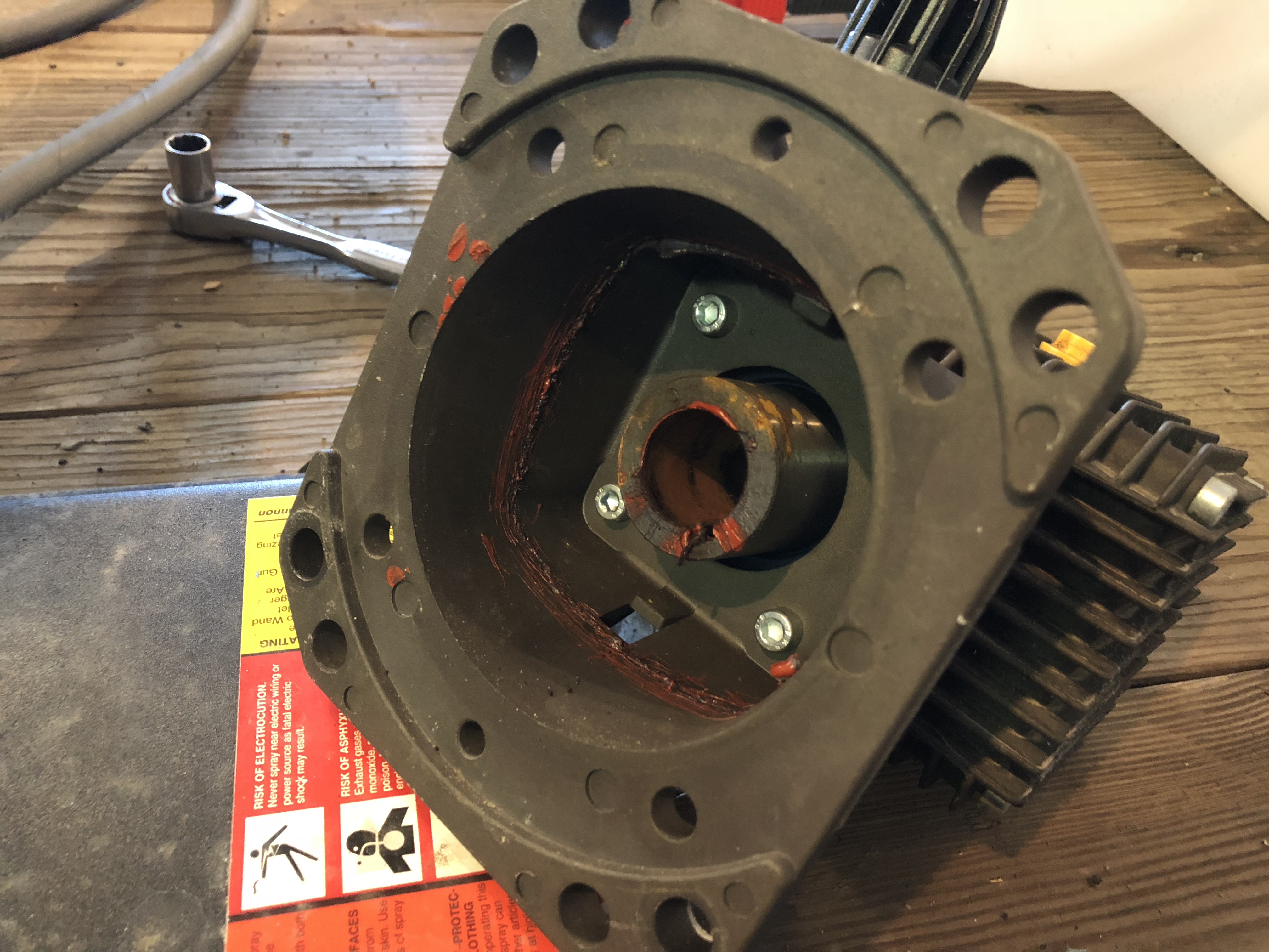

@tireshark, I know you put the mounts on under your pump. Russ told me though that those mounts are only for when the pump is used as a belt drive. It’s actually fine to mount the pump right to the GX390 with no supports.
The new pump mounts a little outside, and there is a raised rim around the shaft, so i had to put some washers in to fit everything correctly. Also, I had to trim down the washer for the bottom two bolts. They hit the rim on a corner, so there’s a photo of that too.
Also, just comparison photos of the AAA pump and the new 5.5 pump from GP.

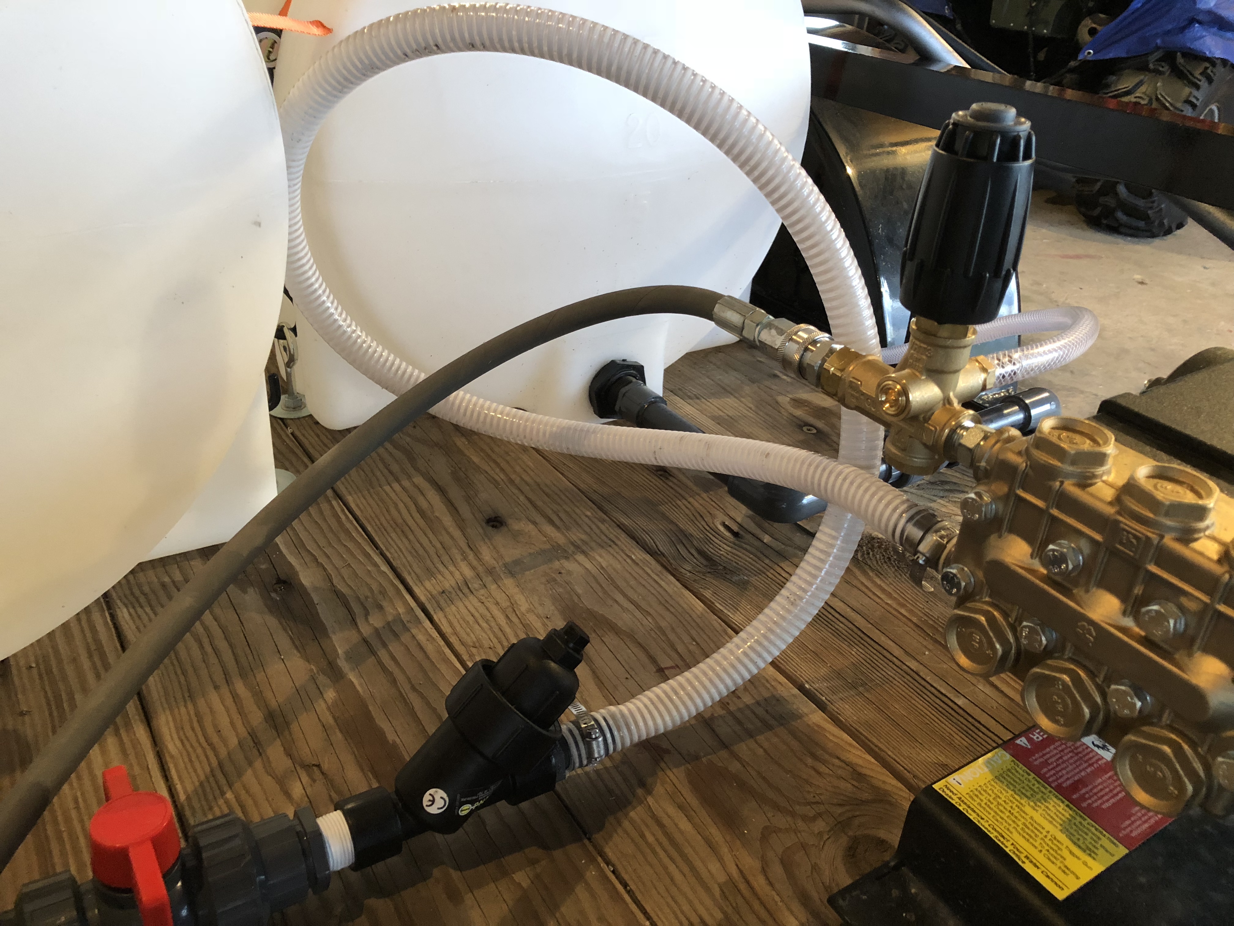

Just need a few more fitttings. I need a female quick connect on the pump, and a few more PVC parts so that I can get another 80 mesh y-stranger in line from that buffer tank to the pump. So I’ll have 2 strainers, one from the supply hose reel to the float valve in the buffer tank, then one out of the buffer tank to the pump. I also still need a couple pieces to get my bypass line fitted to my buffer tank. Those parts should be here early next week.
I’m going to hard pipe from the chemical tank out to the side of the trailer for filling 5 gallon buckets for mixing house wash downstream mixes. I’ll do that tomorrow or early next week.

keep the pics coming, I’ll start my own pics in my other thread once I get back to work on it. Weather makes it hard to get to. What size barb is that off your buffer tank? It’s looks smallish. Where is that suction hose going to?
That part isn’t finished yet.
