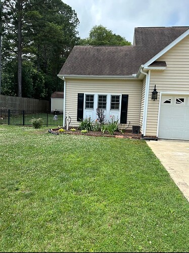

Greetings all! So last week, we did an asphalt roof clean and I down streamed the pool essentials liquid chlorine with some “Kling On” Surfactant and a week later, no difference ! And its worked just fine before! Any suggestions on what to change ?

Problem is you ‘downstreamed’ that 10% strength bleach. By the time it hit the shingles you were probably at about .6% concentration, barely enough for a housewash.
The other guys that do roofs for a living on here know a lot more than me but it takes about 4%+ to even start on that stain.
