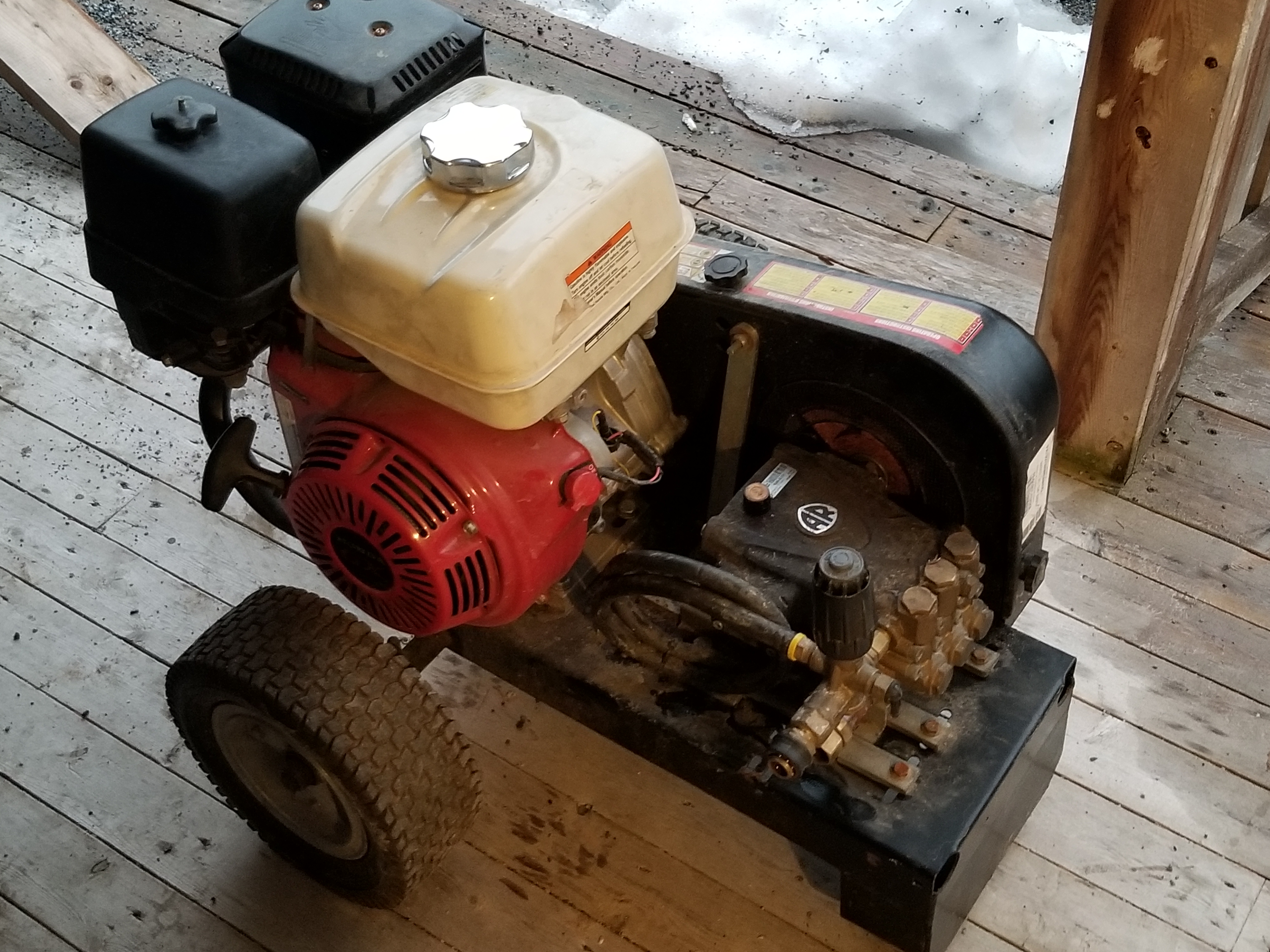

Hi again - just wanted to thank you guys for the advice. I listened to what you said and it worked out for me. Instead of throwing money at temporary solutions I just kept saving.
I got lucky and managed to pick this up today for $500 ($375 USD). Everything seems to work good. It is not the best equipment out there, but it is a lot better than what I had originally planned to buy.
GX390 + AR Pump 4GPM 3600 PSI
What would you suggest I check over/replace before I run this for too long?
Thanks
I would change the oil in the engine and pump. Also the air filter and spark plug. Get a cheap hour meter that wraps around the ignition coil so you can keep up with oil changes. At least that’s what I do since I don’t run it full time so it’s hard for me to keep up with the hours.
