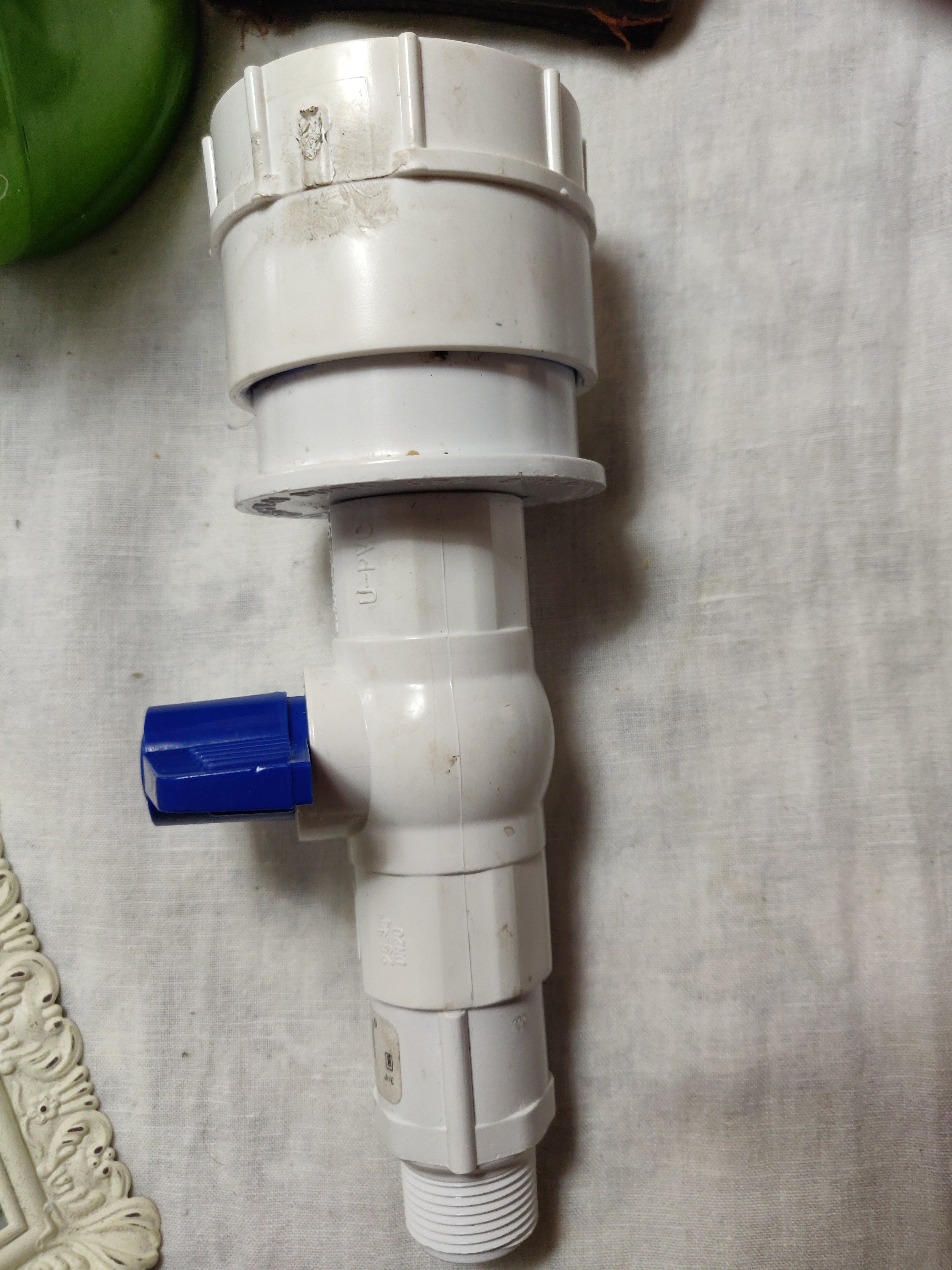

no bleach but this is my plumbing setup to the 3/4 hose. also does the length of the hose affect,effect the water flow
