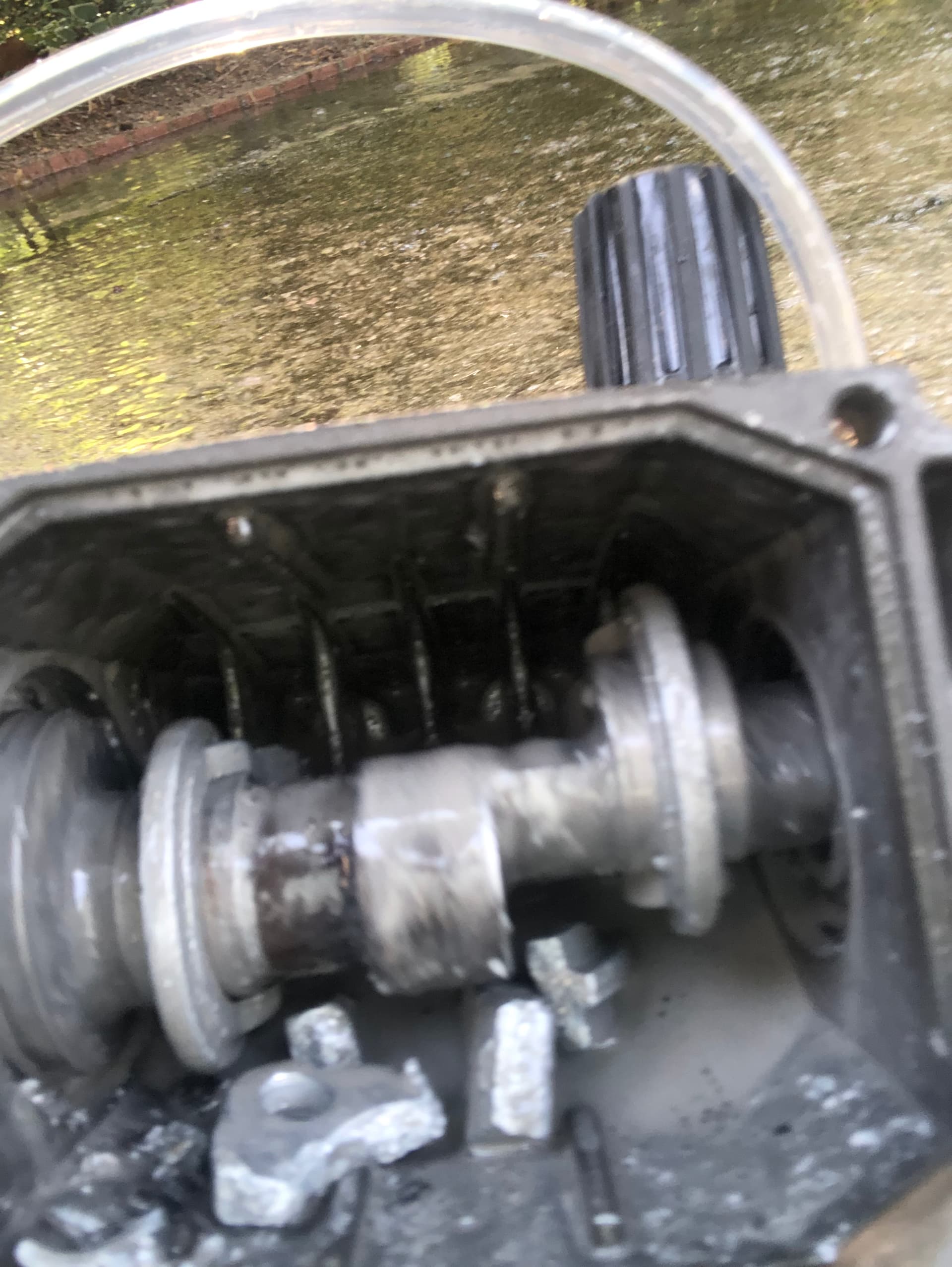

About 1 hour in I hear an awful grinding noise and instantly start running to my pressure washer. Cut it off and notice the pump spewing water. Look in the oil glass and I see a beautiful grey milkshake of water and oil. Looked back and the mixture had gone through my hose and into my surface cleaner. After about an hour of clean up with degreaser and the injector on my ryboi 2.3gpm piece of garbage, I got to take apart my pump.
For reference the PW i was using was a simpson 3.5gpm 4kpsi with a gx270 engine. The machine had about 60 hours on it total and i checked the oil (like always) before I started it. One thing I noticed that was weird was the pull cord was stuck for the first couple tries. I let the water run a little longer through the machine and it started on the 3rd crank or so. I’ve never run it dry or anything of the sort and treat it like my baby. Here’s a picture of the insides of my pump after it grenaded itself.

I have little doubt that I did something I was unaware of. I did a little bit of research and it seems my unloader valve was most likely the issue. I hadn’t seen it working lately but didn’t think much because the engine wasn’t stalling. I recently installed a 5kpsi pressure indicator on the outlet of the pump because I was curious to see how it was doing. Everything was working perfectly until it exploded. Just thankful it was my driveway and not a clients otherwise this would be a much different story.

I think my gameplan is to buy a new pump. Anyone know the biggest pump I can put on a gx270? I’d love a 4gpm/3500psi but I don’t have a clue how the conversion works. Smart thing to do would probably be just buy the same pump but thats not too fun.
Psi x gpm/1100 equals hp

You’re pushing the GX270 to the max already I believe. I also run a GX270 with the AAA triplex pump labeled at 3.5gpm /4,000 psi. I’ve never tested actual gpm or psi, and have been using it since January 2019 but I’ve put close to 60 hours on it since I installed an hour meter on it about a month and a half ago. No idea how many hours I actually have on it, but when it does die - likely soon - I’ll have no worries about paying $306 after taxes and shipping to get it delivered to my door. It’ll pay for itself in just a job or two and I’ll hopefully be set for another 3 years or so.
Yea i just did the calculations… the gx270 puts out ~9hp at 3600rpm MAX. A lot of these 3.5gpm/4kpsi pumps recommend around 11-13HP. Its a box store Simpson pressure washer… pretty ridiculous that a $1200 machine is underpowered. I got puuuunked. Woof.
