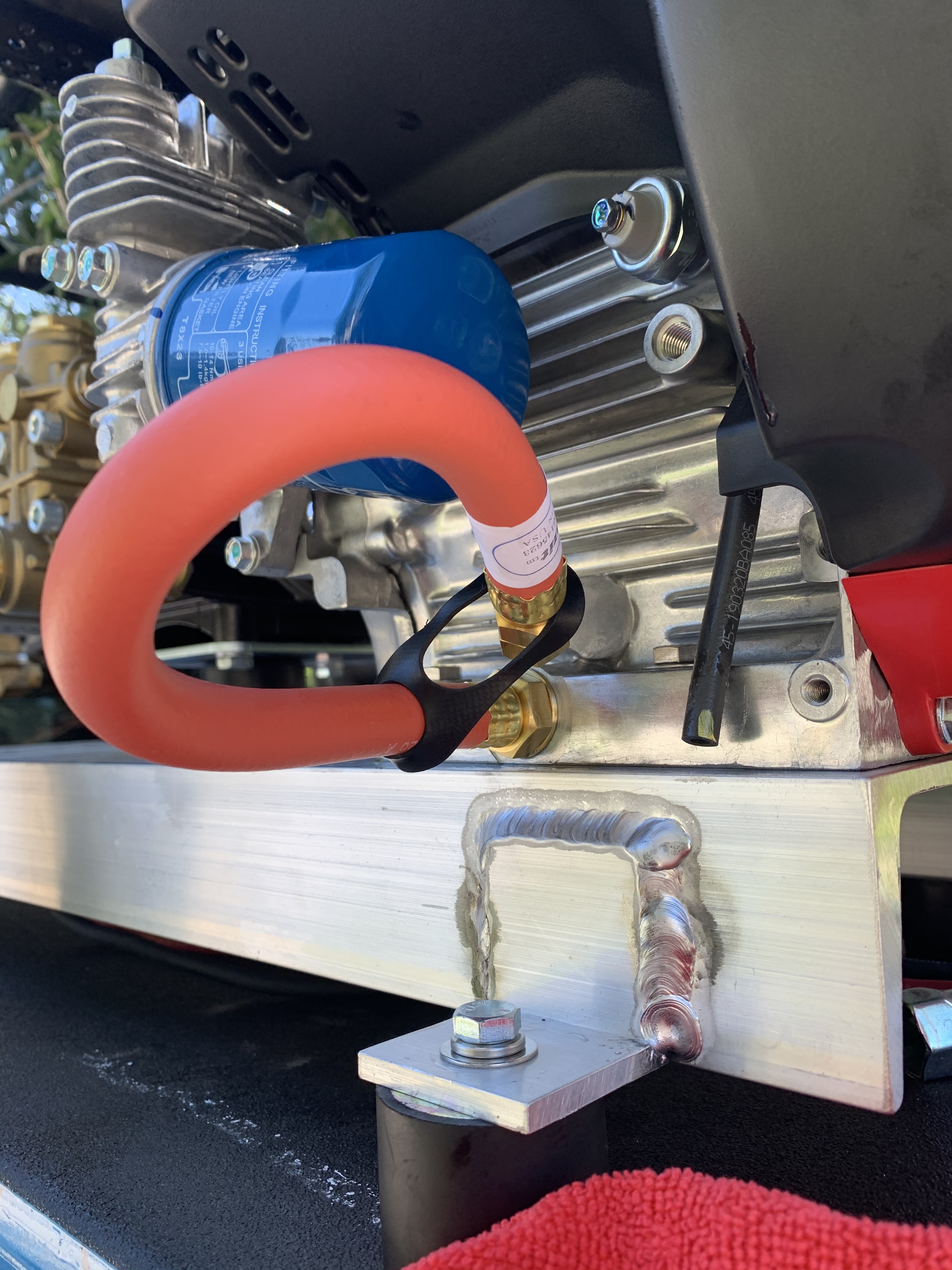

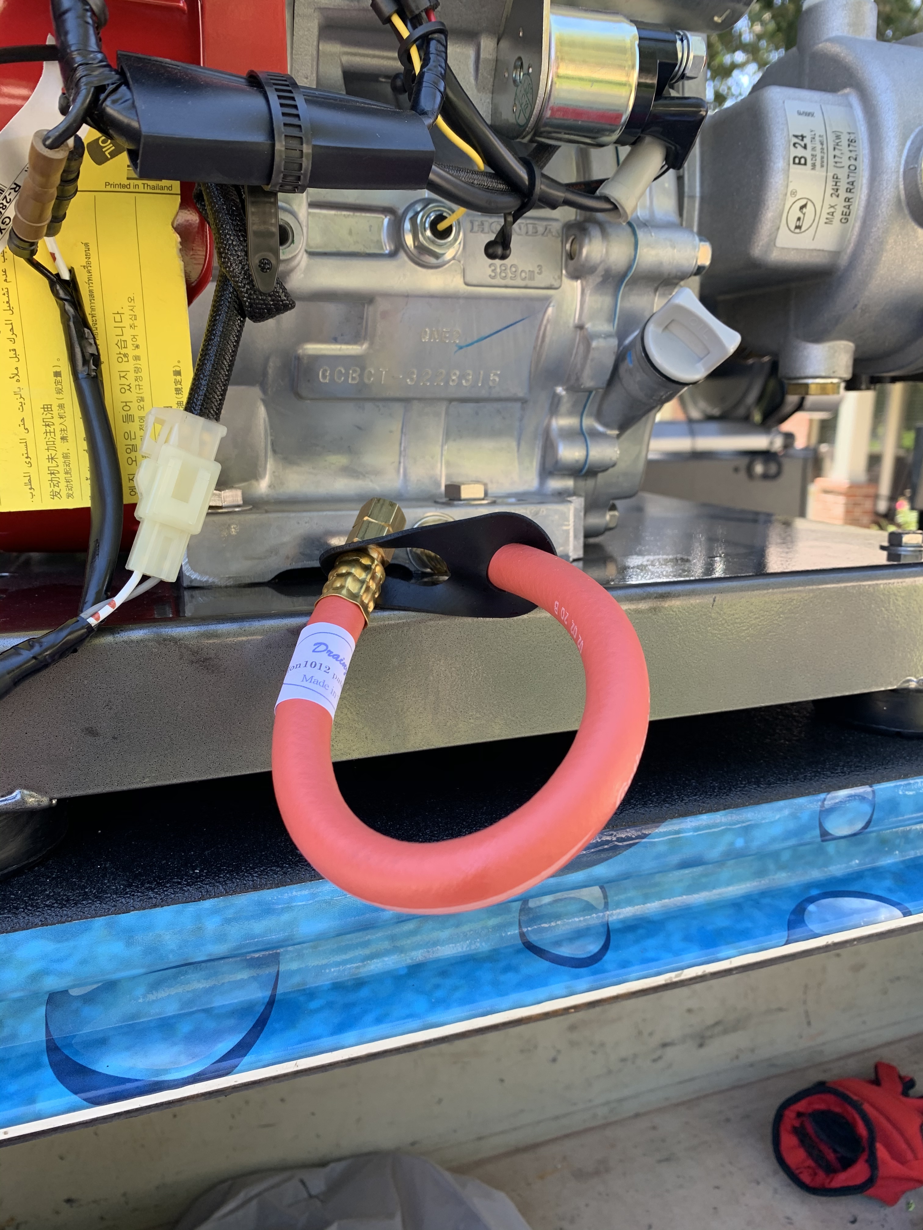

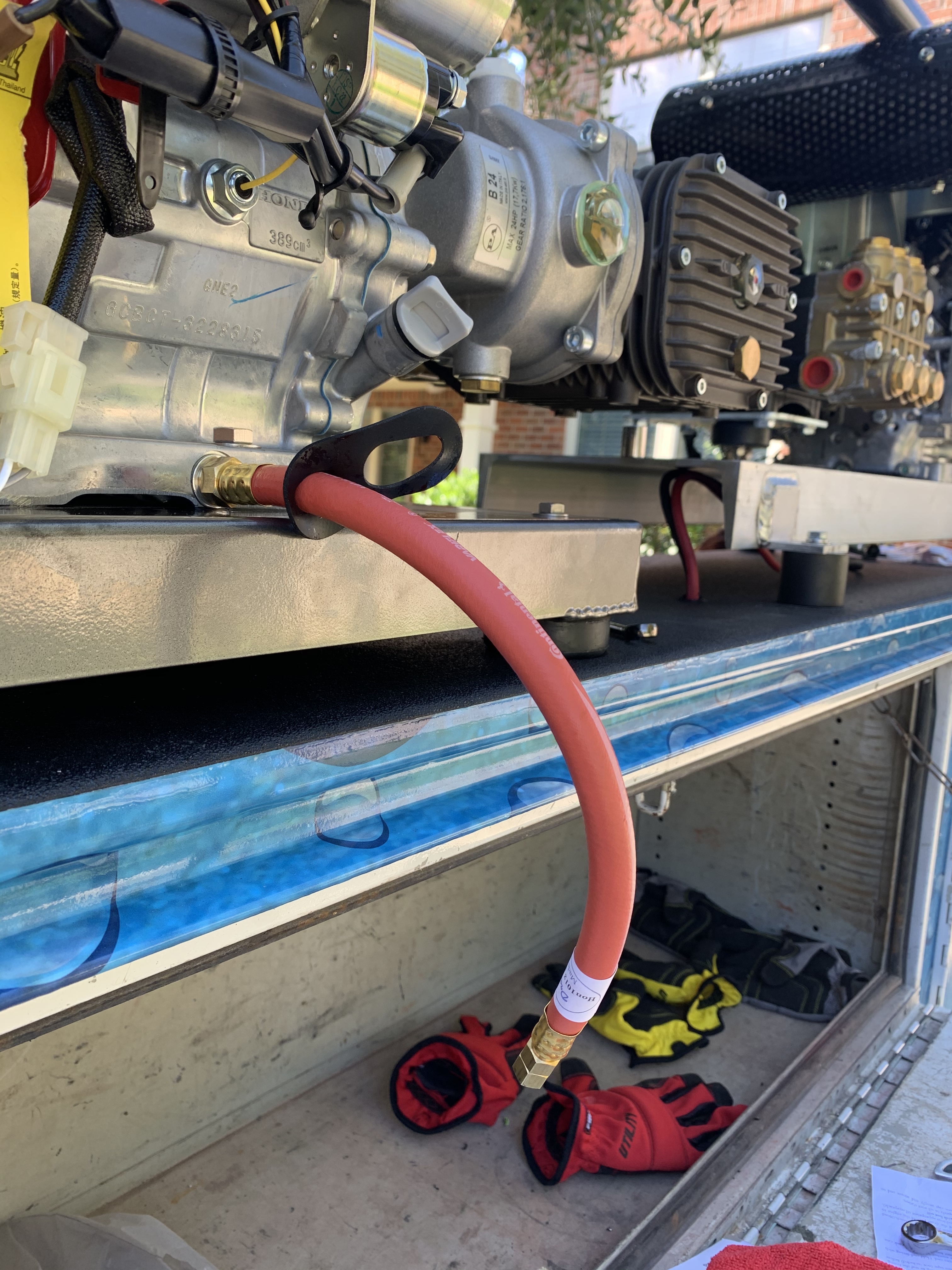

Also anyone using drainzit oil extensions? I installed them first thing.
I need those. I was about to hook up a old brown pump I had to try and suck the oil out.
GX390 12MM Drainzit Oil Port Hose
GX690 20MM Drainzit Oil Port Hose
You can’t beat Sprayer Depot. I’ve been using them for a number of years even before I got into pressure washing. They’ll bend over backwards to make things right.
My Hydromax came with an oil drain extension. I’m kind of surprised they didn’t install one for the pump oil. I’m going to order one for the pump once I do the new machine fluid change and figure out the thread size. You could be really lazy and add a little ball valve to the end. I’ve seen some drain kits that come with them. I’d be afraid it might crack open or some idiot would do it on purpose.

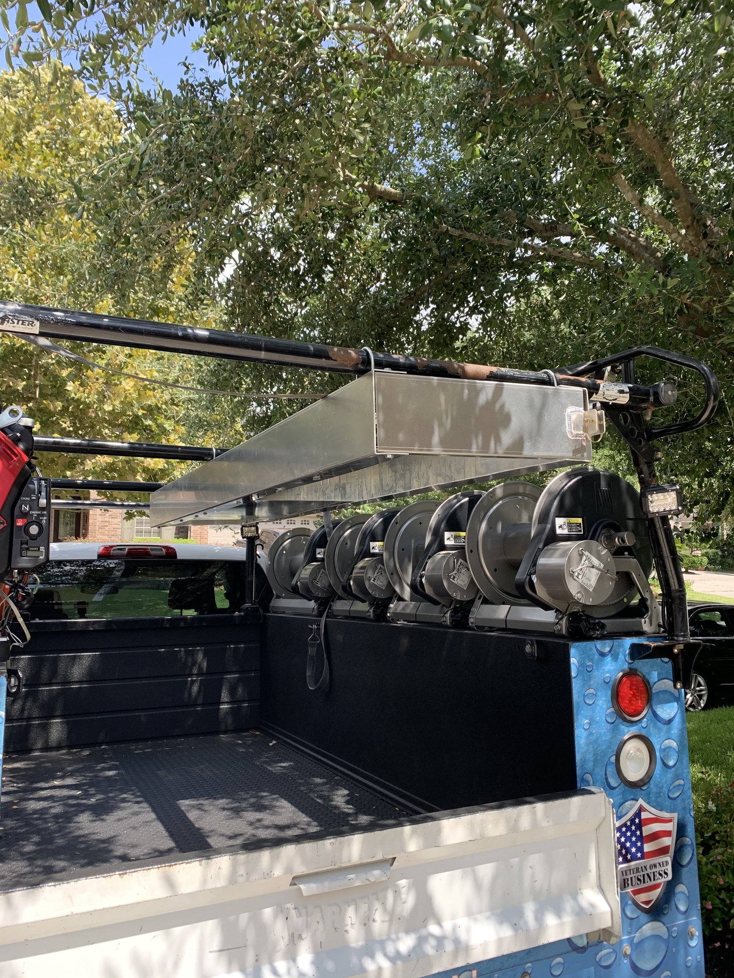

I still can’t get over how good your setup looks. It’s really top-notch. Well done, I’m excited to see it complete!
Thanks man! I’m in the 2 steps backwards phase of the build. Major work on my 2nd personal vehicle had to happen yesterday, incoming hurricane, and now wiring the engines up today.
Did you get you a sludge pump yet. Big dollars to be made with it if hurricane heads your way.
No haven’t ordered it yet. Thanks for the reminder!
I dig how small the footprint is on that 8gpm. Super clean man.

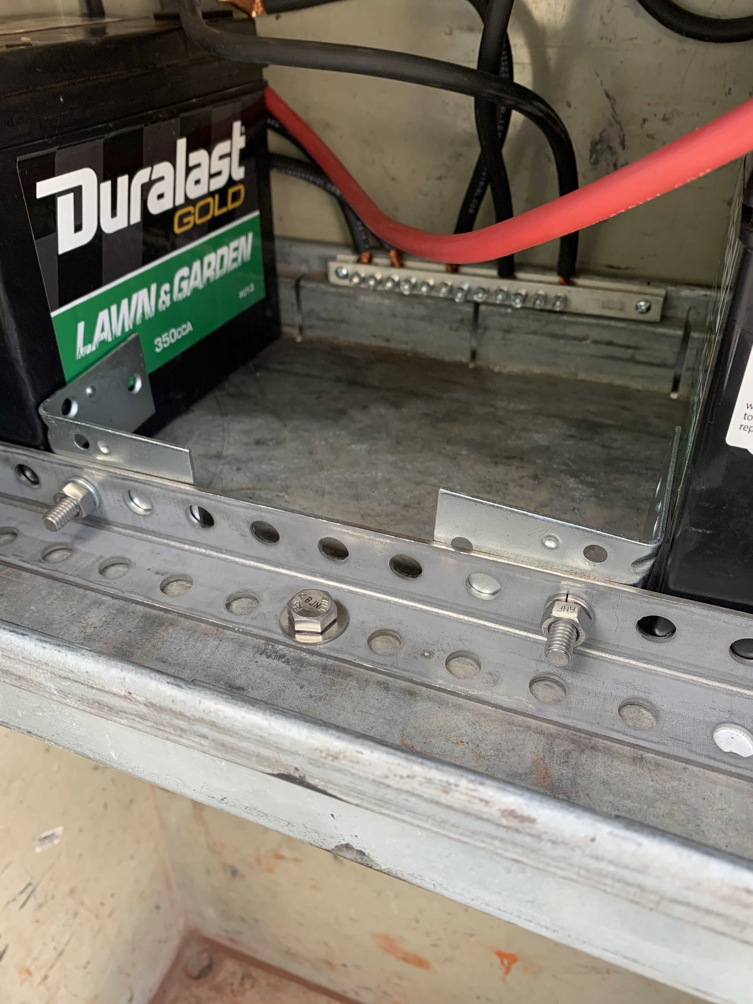

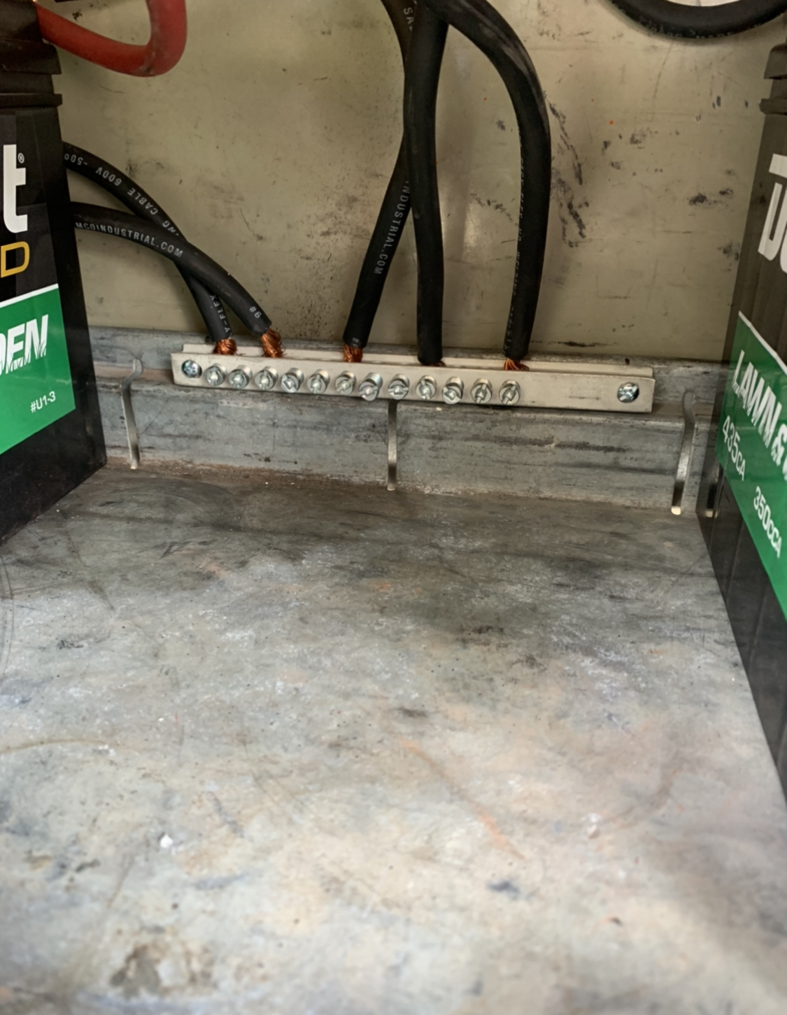

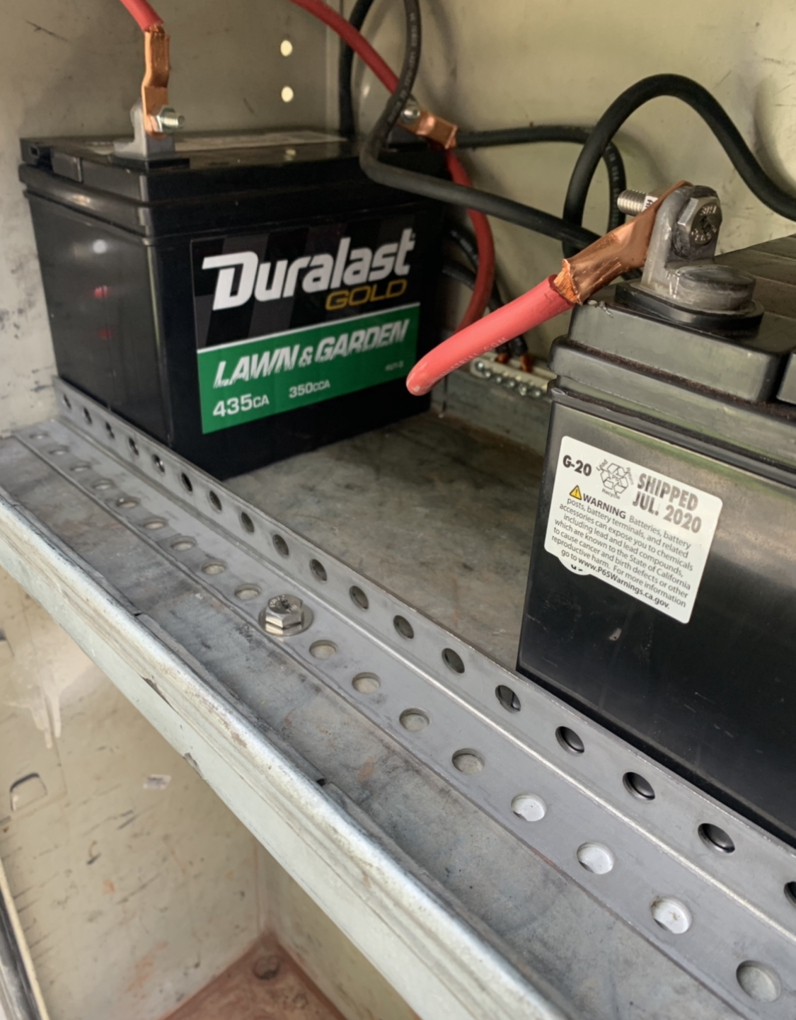

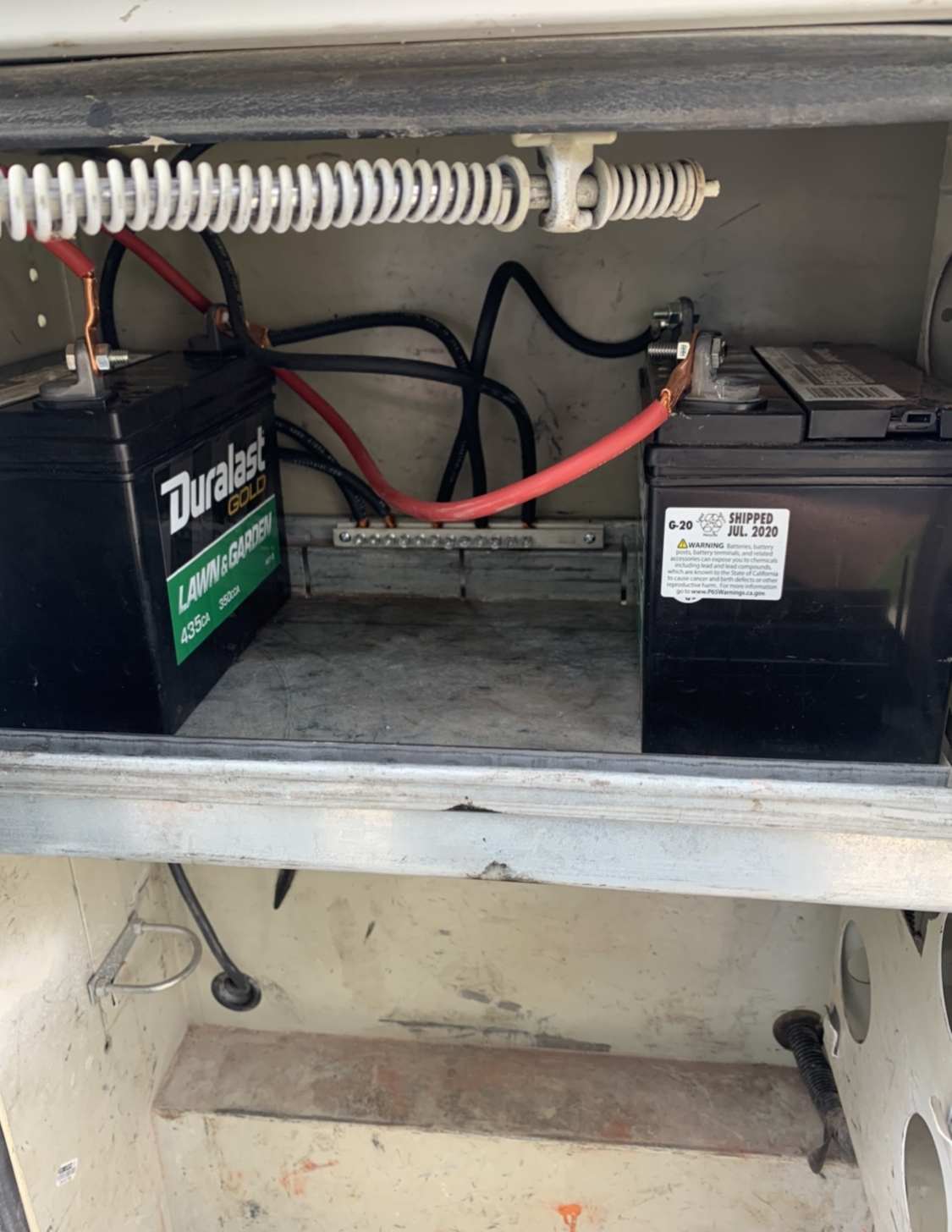

It’s coming. 91° F here and fees like 106°. Finished wiring the engines today. Used a grounding bar, attached a wire to the frame and all the grounds to it. 6 gauge wire. Will mount brackets to manage the wires next.
Sweet setup, I would recommend next time don’t crimp copper terminals, put it in a vice heat it up with propane torch to melt solder then dunk your wire in their and don’t forget to shrink wrap it. Good luck, I just started this year and even with covid, people still spending money, just wish I was more on point with social media and networking still doing 1 to 4 grand a week. Thanks to this forum, learning curve was a lot easier and less expensive. God bless AMERICA !
Thanks! Pre-made cables on the way. Agree about crimping.

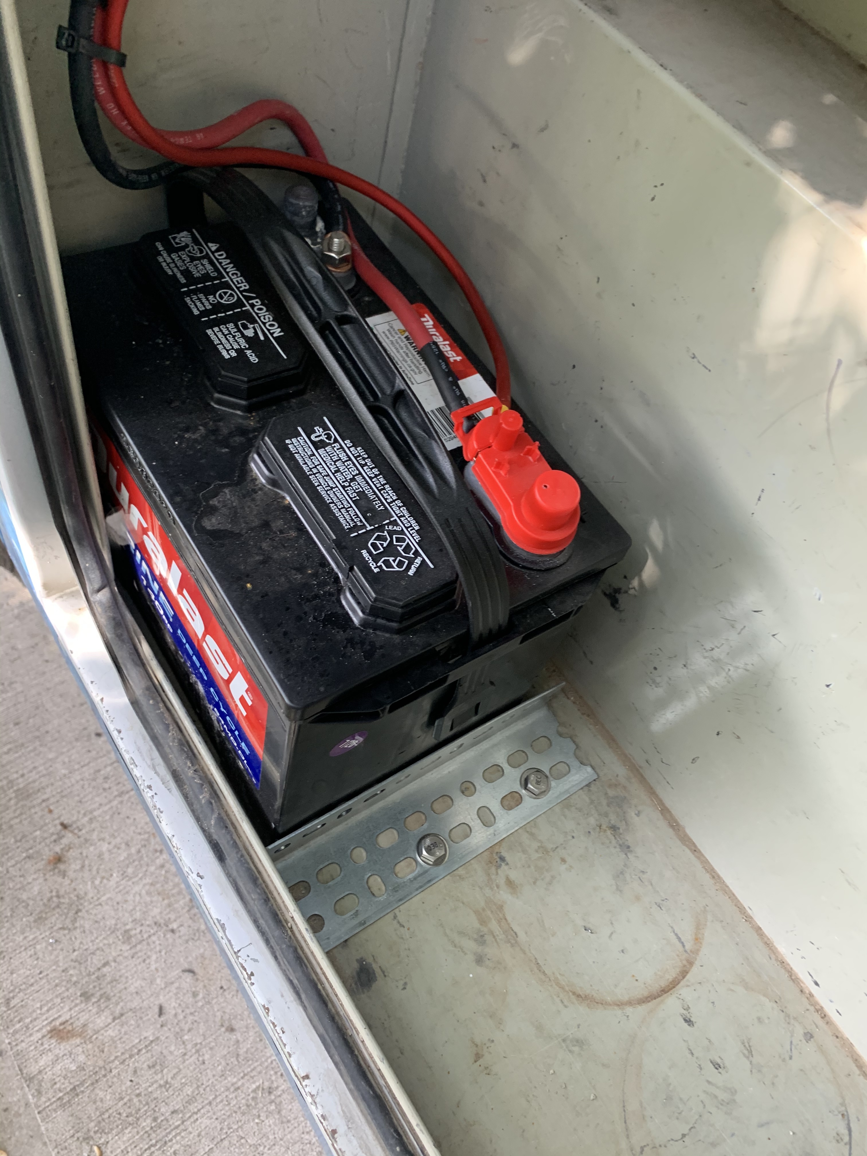

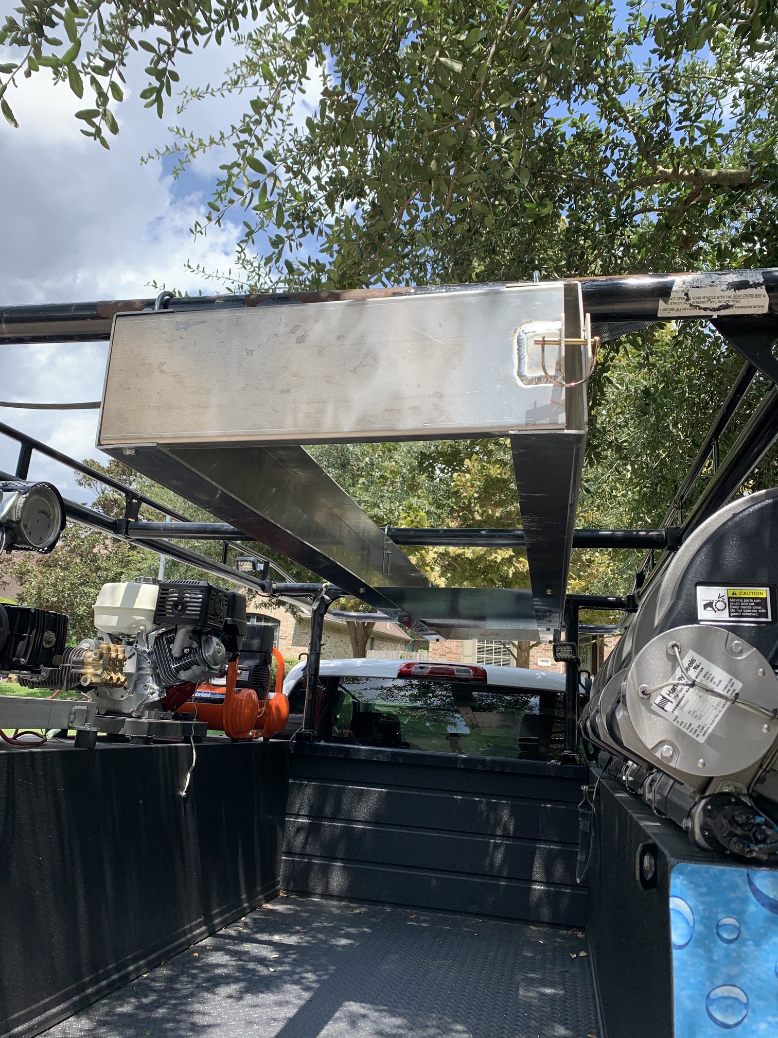

Finished mounting the batteries today and had to add some stuff to the surface cleaner mount I had custom made. Next time I’ll have it built this way, but doing it all from Hawaii with measurements I got from the Internet I’m pleased it works. Mounting the second rack tomorrow. Feels like 108° here with a heat index of 116° and 88% humidity. Currently in the pool drinking water :hot_face:
