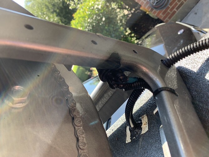

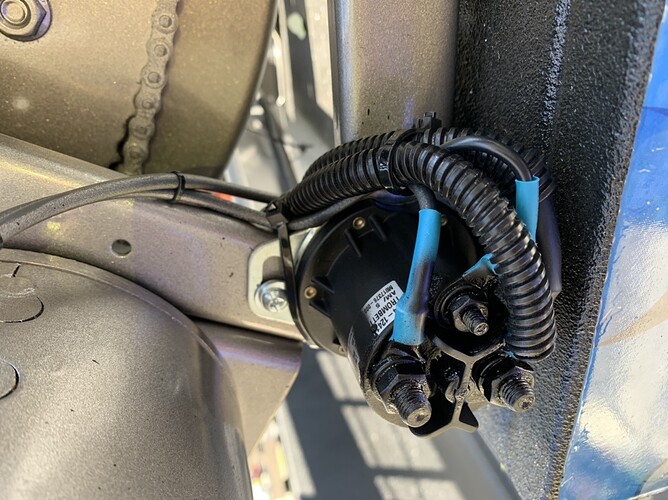

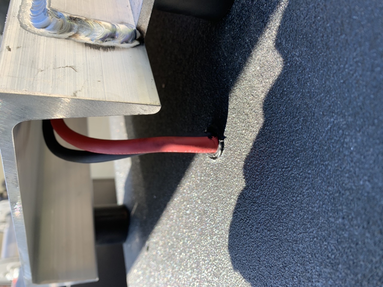

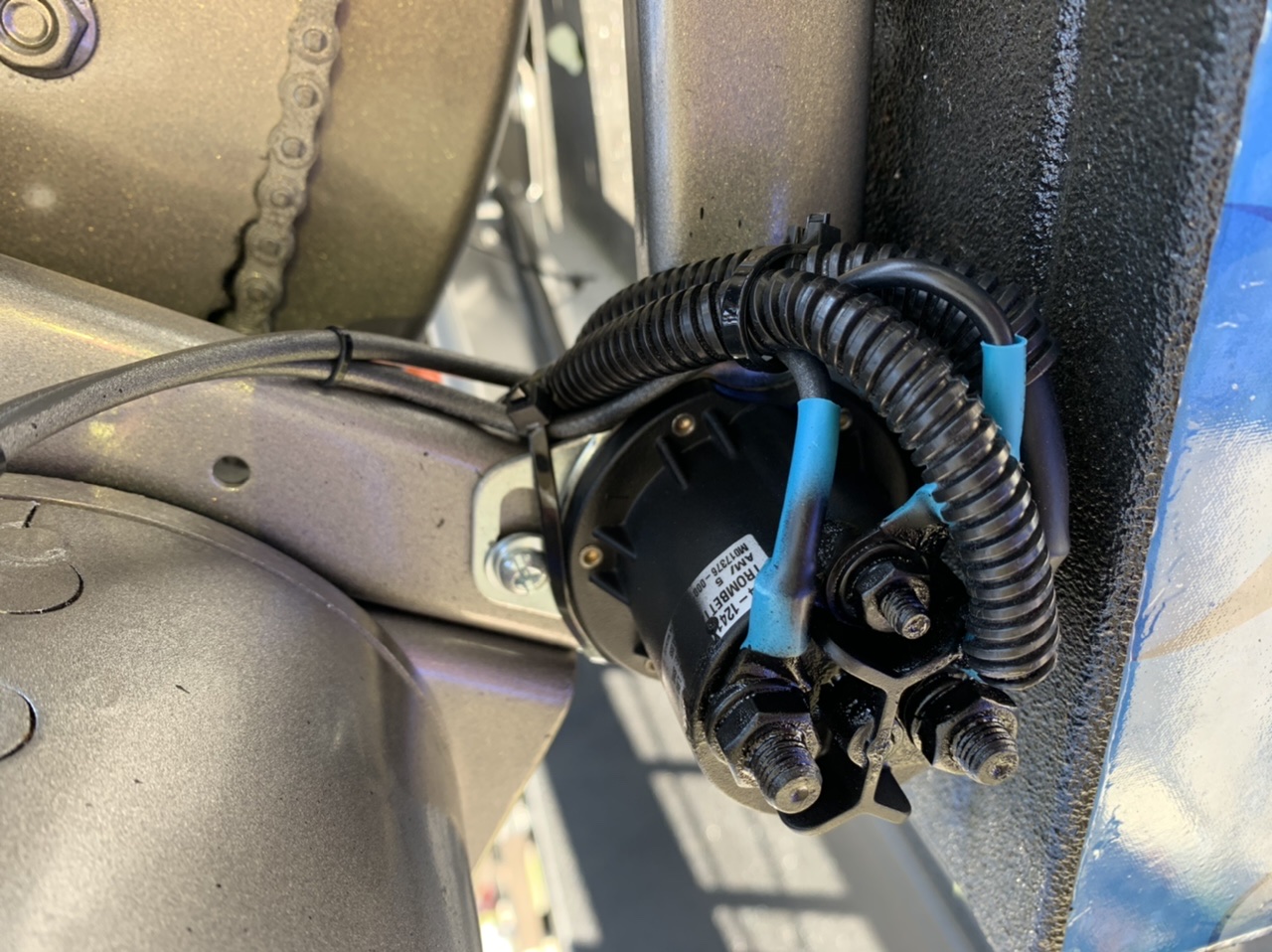

Looks good. Would expect nothing less from you. What are all those wires in the 3 rd pic coming from and what are all the switches. What do you need a 150 amp breaker for?
I think you’re talking about from the switch to the solenoid. Then from that to the thermal circuit breaker. The 150 Amp circuit breaker is between the battery and everything else. Shouldn’t ever be needed but if 2 or more short out (somehow) it’s the appropriate size. Again thermal breakers should cover it but welcome to quad redundancy submarine insanity.
Well you got 1/2 that comment right…lol

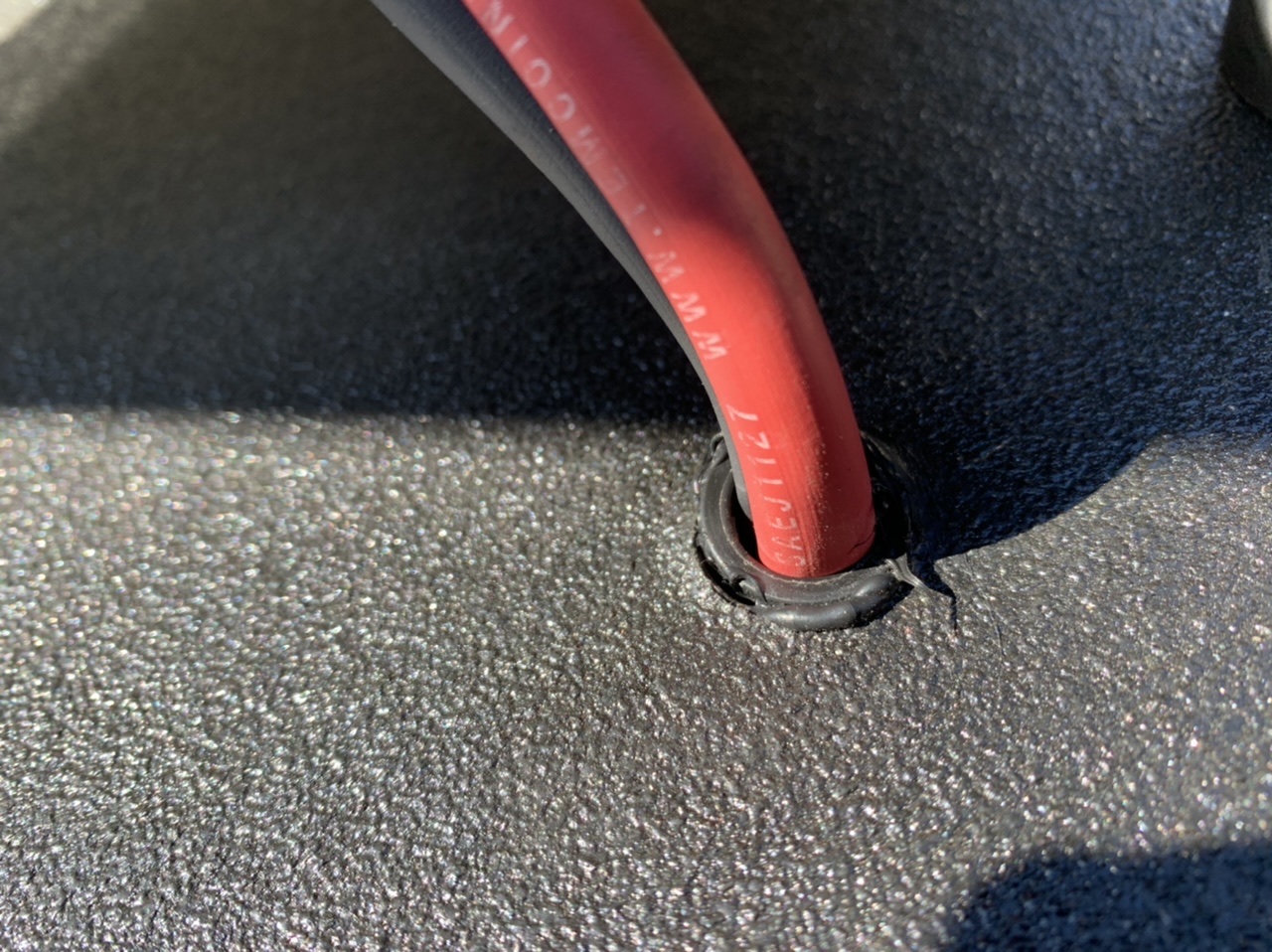

Quick question, did you do anything to waterproof where the bolts go through the hose reel brackets and into the truck toolbox?
I’m wanting to mount a reel on top of a toolbox I have but can’t have water leaking into the box if it rains.
Yes weather proof silicone and the rust spray.
