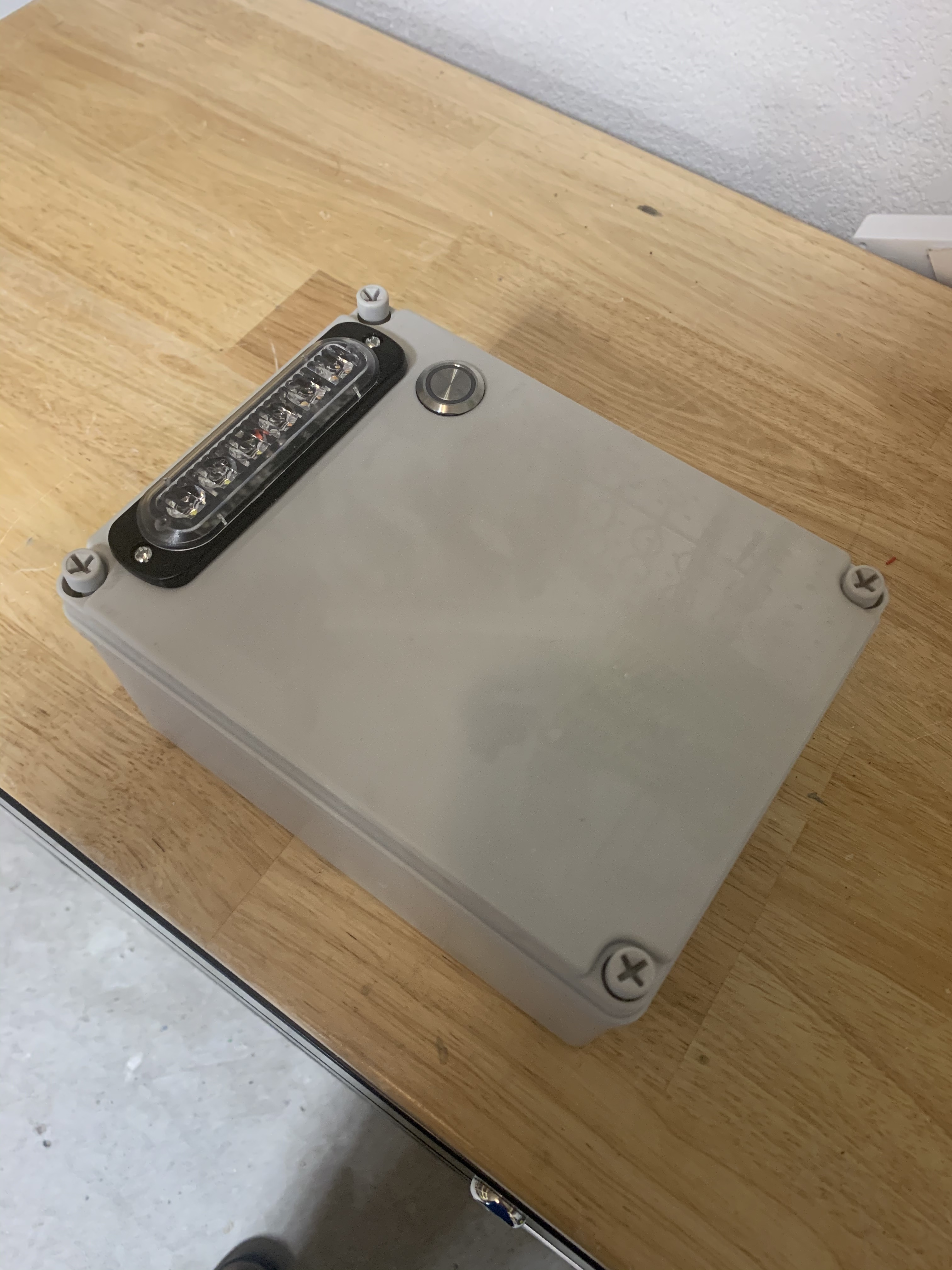

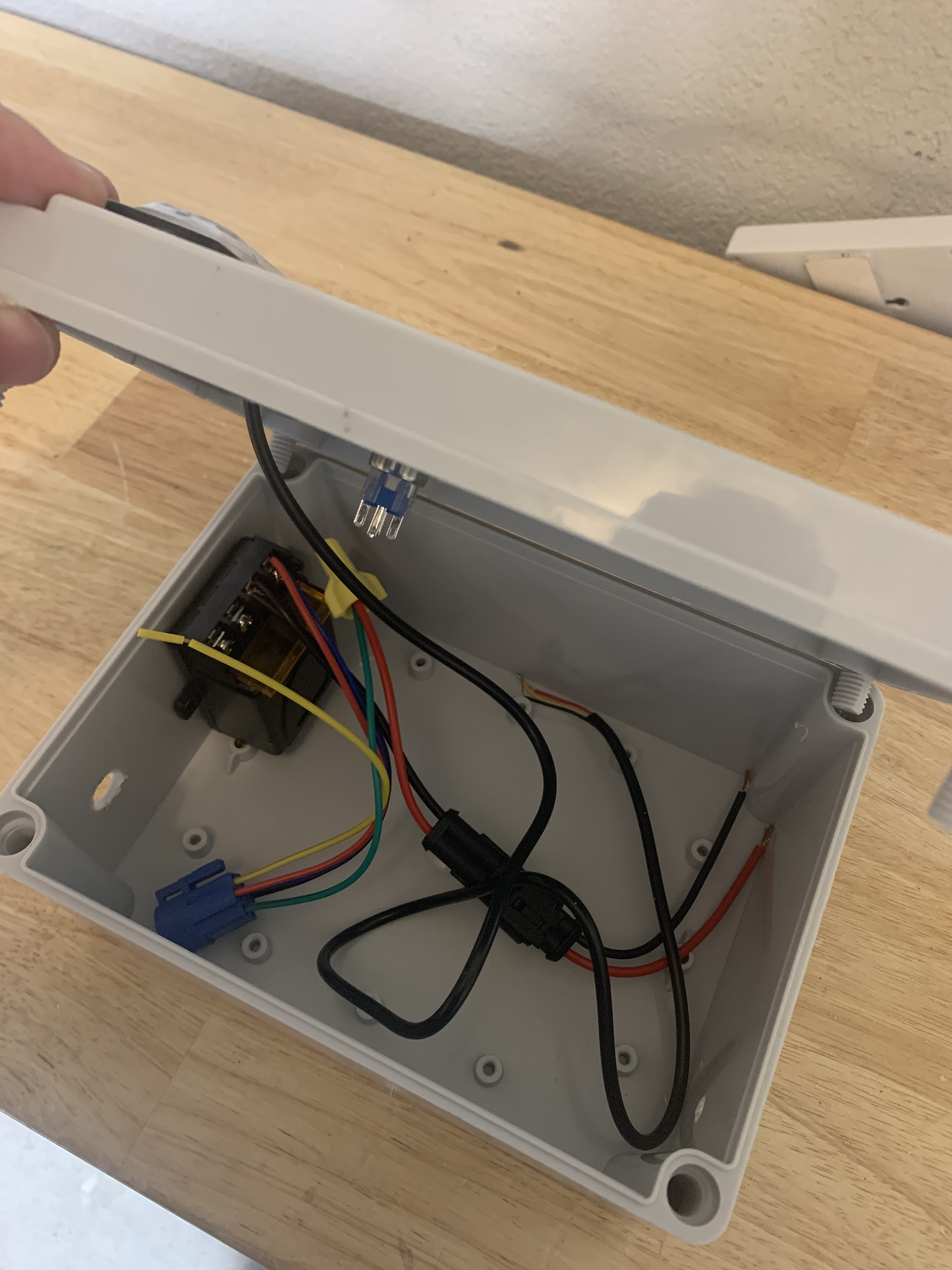

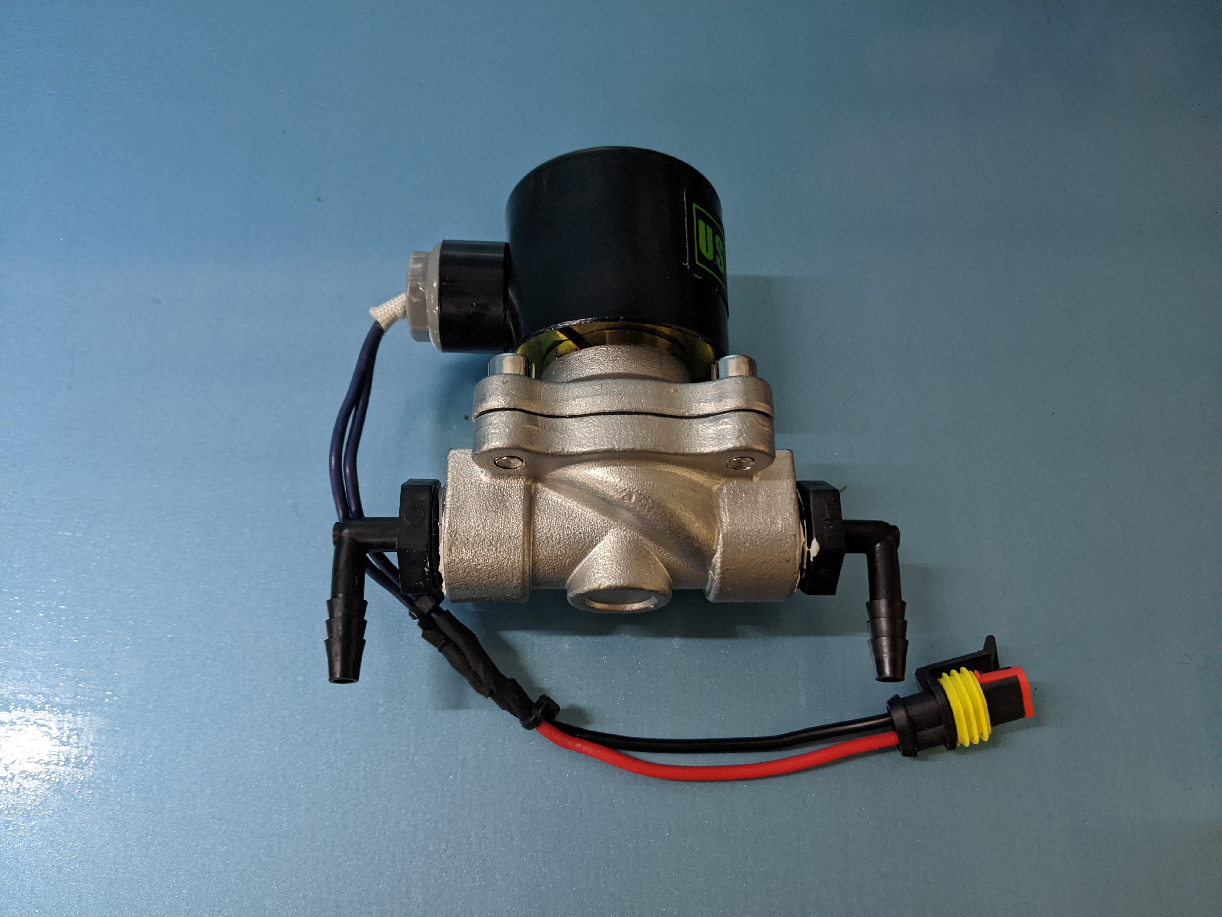

My curiosity got the better of me and I’m building a remote system. Went with a mechanical valve over a solenoid. Should arrive this week and I’ll let everyone know how I like it. I used @Steve’s parts list from another thread. No battery meter as I have one near the battery.
So far mine works great. I added a vent to the box to relieve some of the heat. It probably wasn’t necessary since I usually only have the soap valve open for 5 or 10 min at a time but can’t hurt with a solenoid valve.
When that one craps out you really have to get a Schertzbox. They’re worth every penny.
I had them on my list but they were back ordered. I figure for $120 I’ll see how long it lasts.
I also have a second backup valve tested, plumbed and ready to go with electric quick connects. Personally, I like the idea of being able to change out the valve on the fly. If I had a more expensive version of the controller, I’m guessing that it would be down while I send the valve in for warranty, that is, if it’s still under warranty. If it’s not, I guess I’d be waiting on a $200 replacement valve for my plastic box.

My area has a ton of massive homes that are built on a mountainside. It makes for a workout without a box. The Schertzbox is phenomenal
You will love it!
Mine goes 250-300 feet
