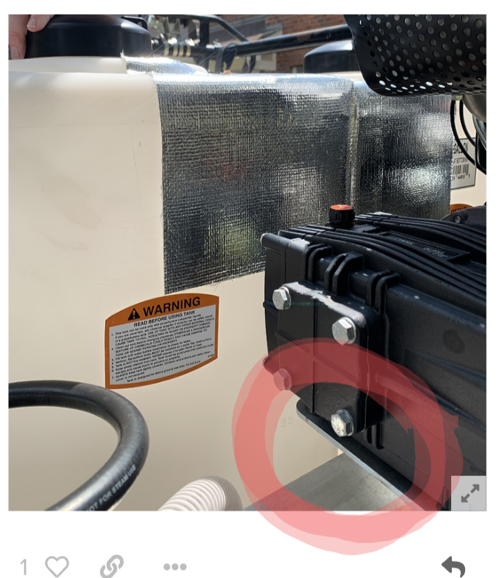

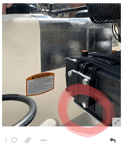

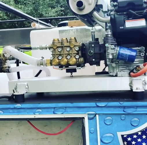

That tape you put on there isn’t going to work for you long term, study any OEM heat shield and you will find they all have an air gap between what your trying to not get hot or melt. Look at your gx690 or gx390 mufflers for examples or the exhaust system heat shields on your truck you will see a pattern. That sticker material will essentially become a heat sink when it’s soaked with heat, the opposite of what you want. Many enclosed trailer builds have had the same issues.

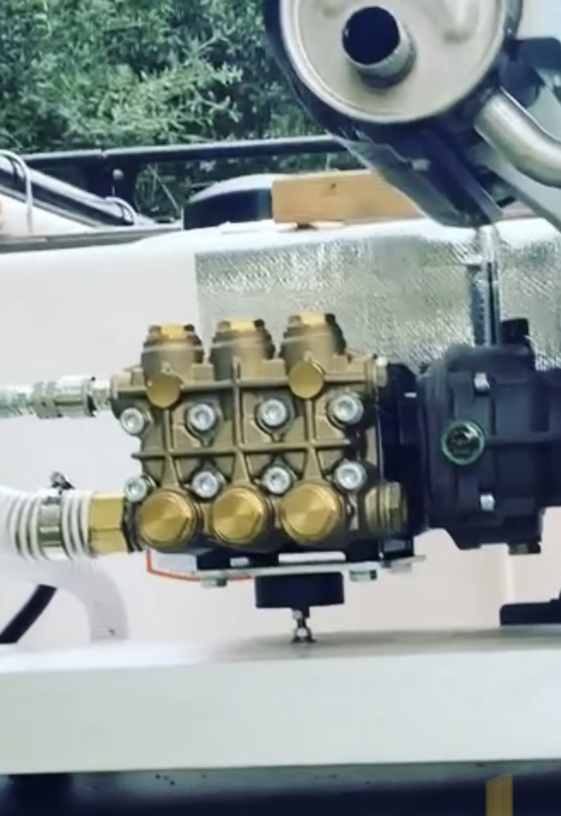

Is that a torque plate on the bottom of your pump?
It’s mounted on a plate and vibration reducer.
I see what you’re saying. Appreciate you pointing that out. Understanding vs application is a real thing haha. Thank you!

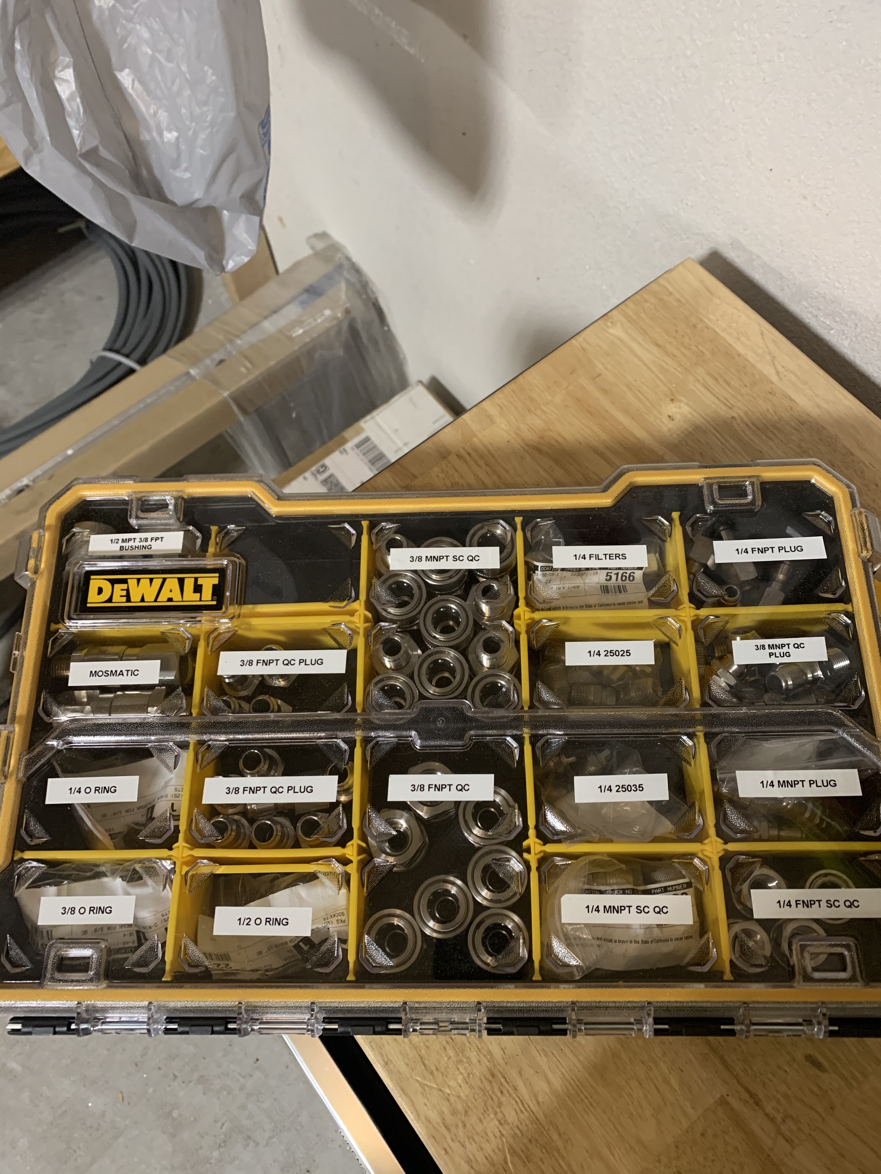

I really like these DeWalt organizers for QC’s and O-Rings.
I like how it’s tall enough to stand up the quick connect
They stack too with interlocking connections.

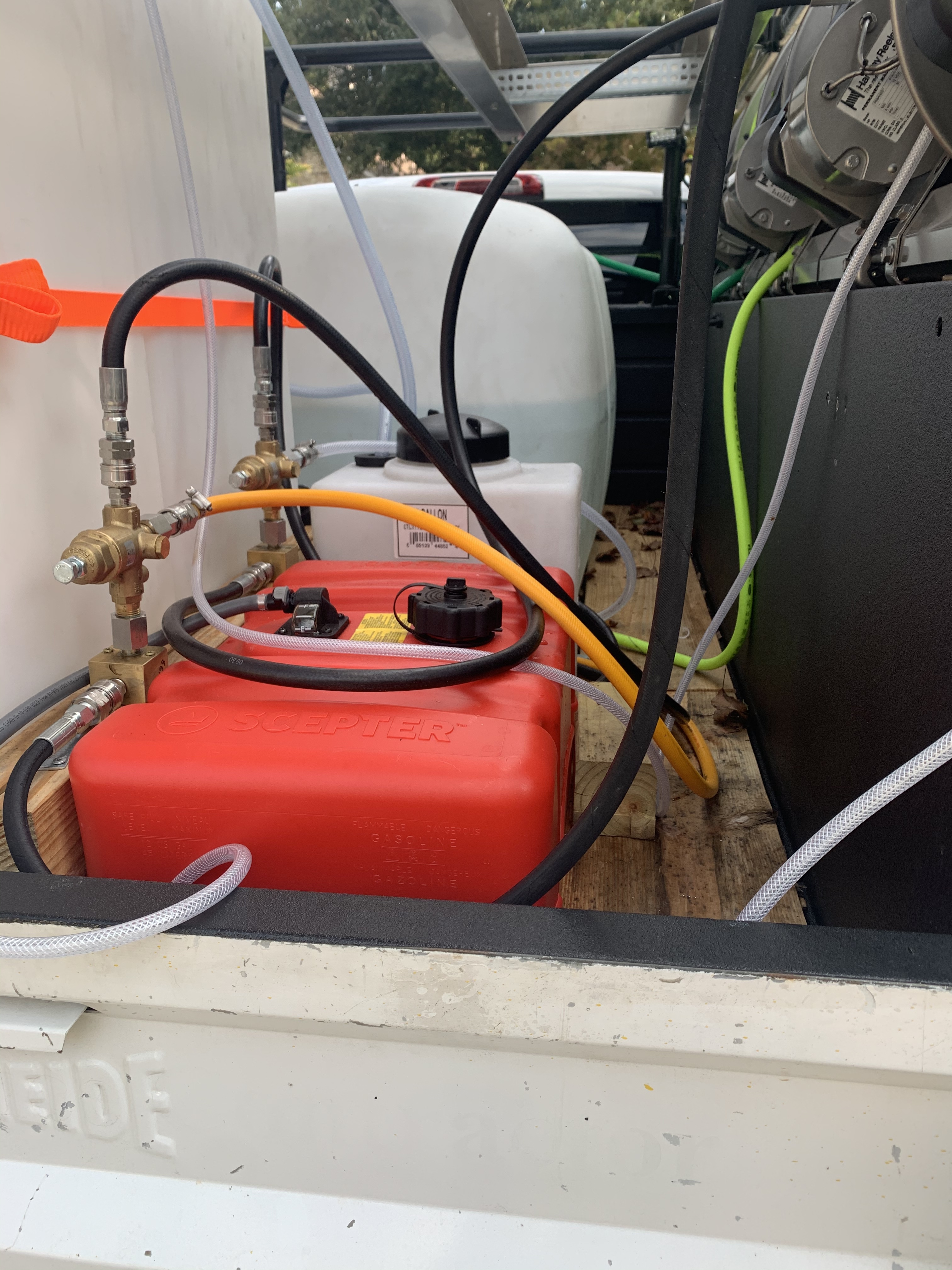

Moved the unloaders. Next up is bundling and organizing the hoses.
Is that a 12 gallon gas tank?
We upped it to 35 gal with 2 of us running full-time.
Yes it is. I have the stock 5 gallon on the Gx390 still.

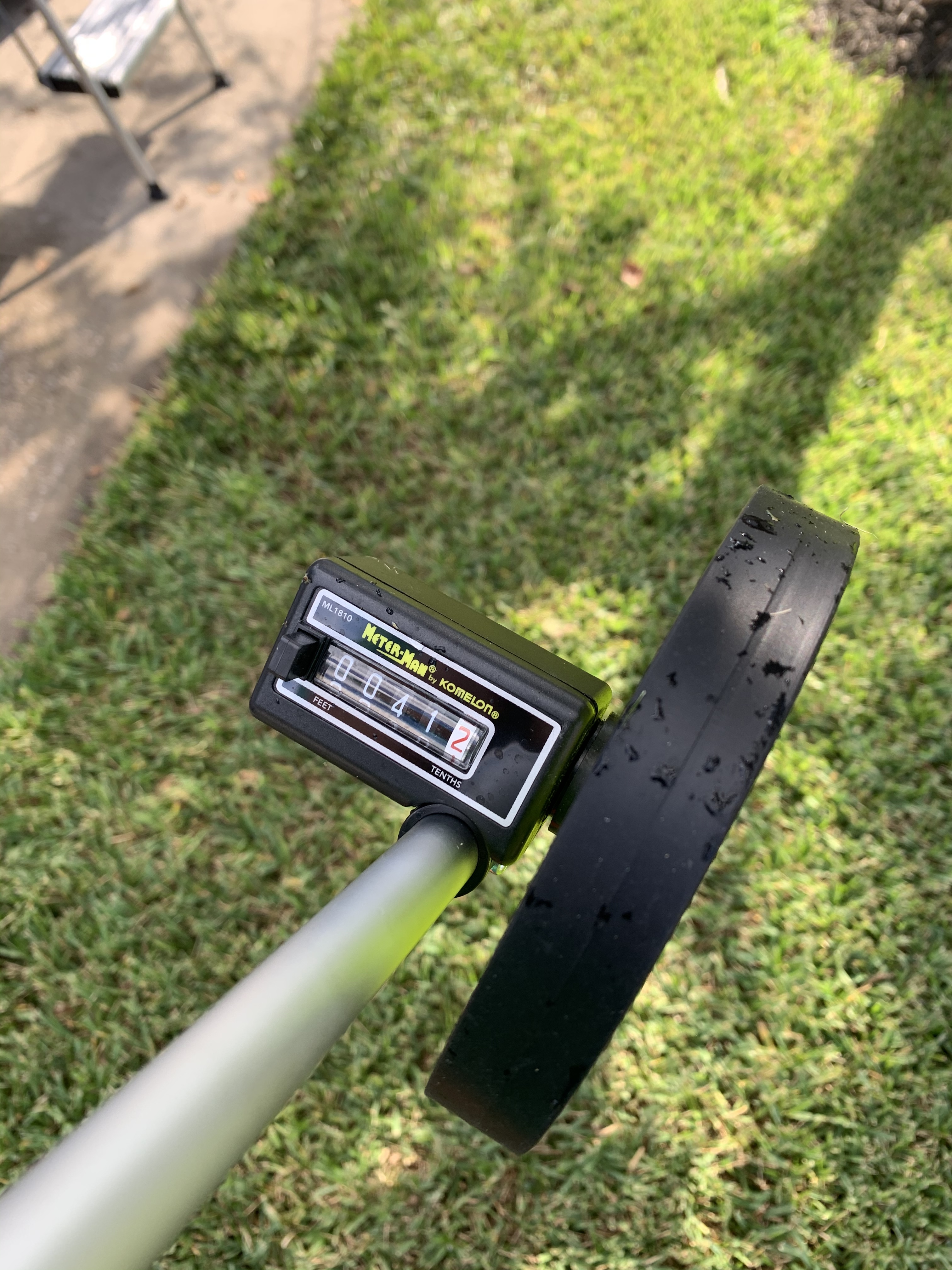

Got the AODD up and will share a video later but measured 41ft today.

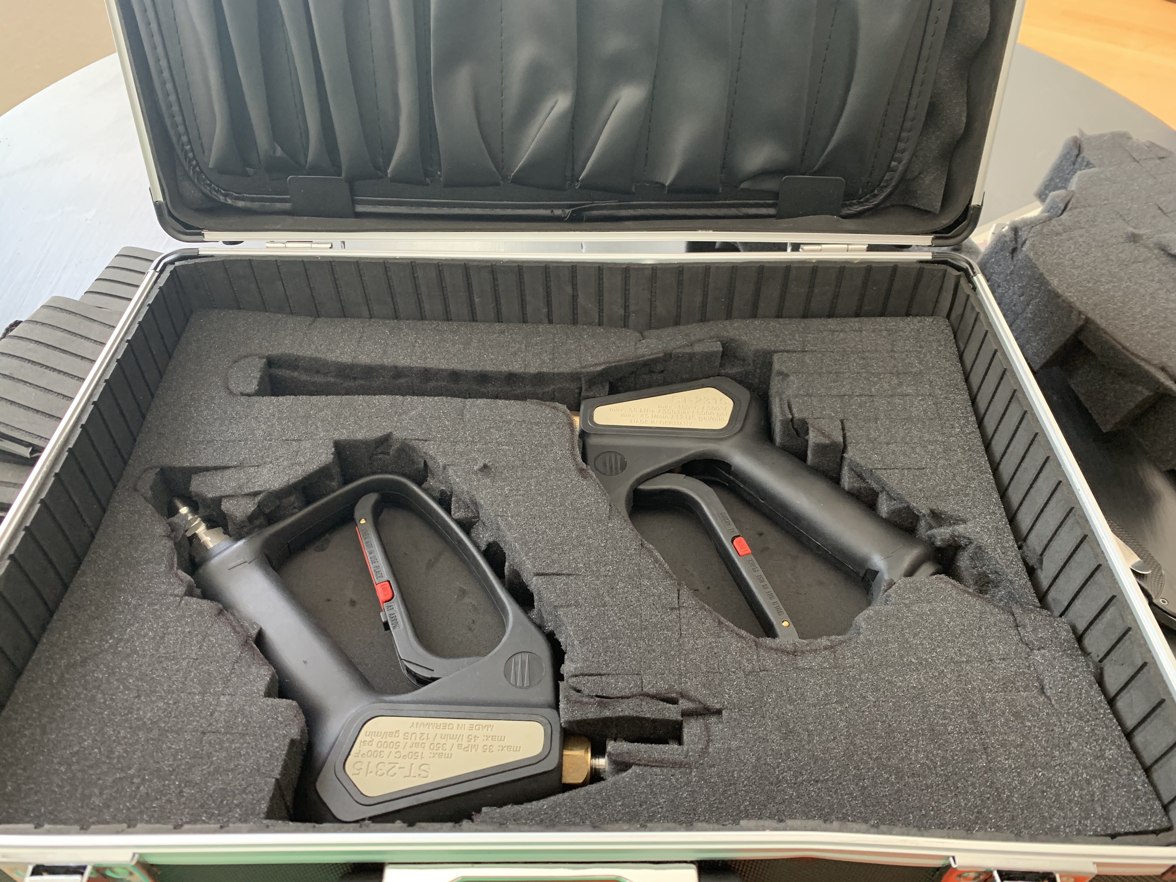

I know someone will get a kick out of this. I had to. :joy::joy::joy::joy::sunglasses::man_shrugging:t2:
Huh how are you gonna fit a yellow noodle in that box :thinking: maybe a rifle bag?
Dude I have that exact same briefcase in my truck that i hold all my loose crap in for the moment lol. I’ll snap a pic tomorrow. I took out the dividers, those pen holders, and just use the empty case. The rattling of the hardware is annoying when driving though lol. It’s in my backseat
Yellow noodle?
