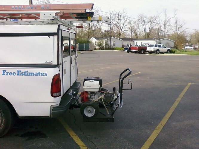

Have you ever even seen my first “truck build” back in 2005? Well, feast your eyes sucker!
His overbuilt thing doesn’t even compare, lol!
