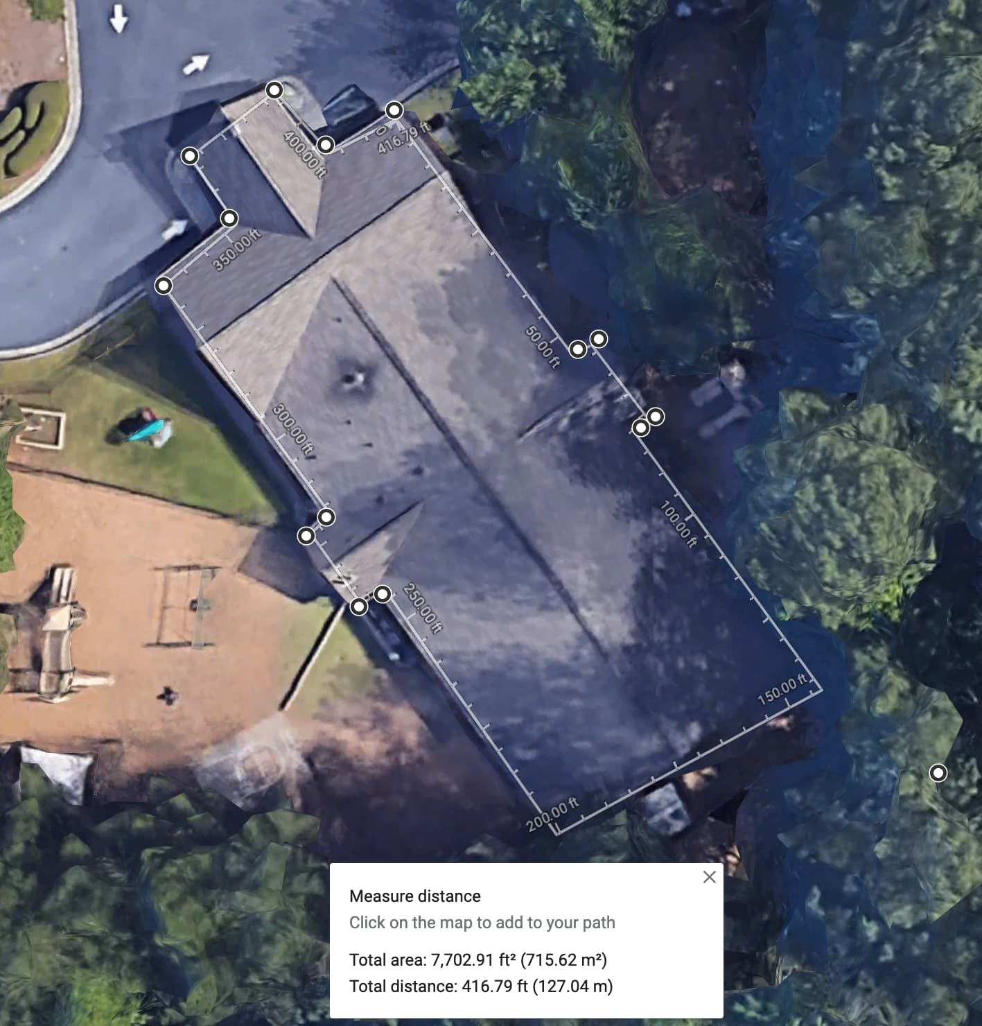

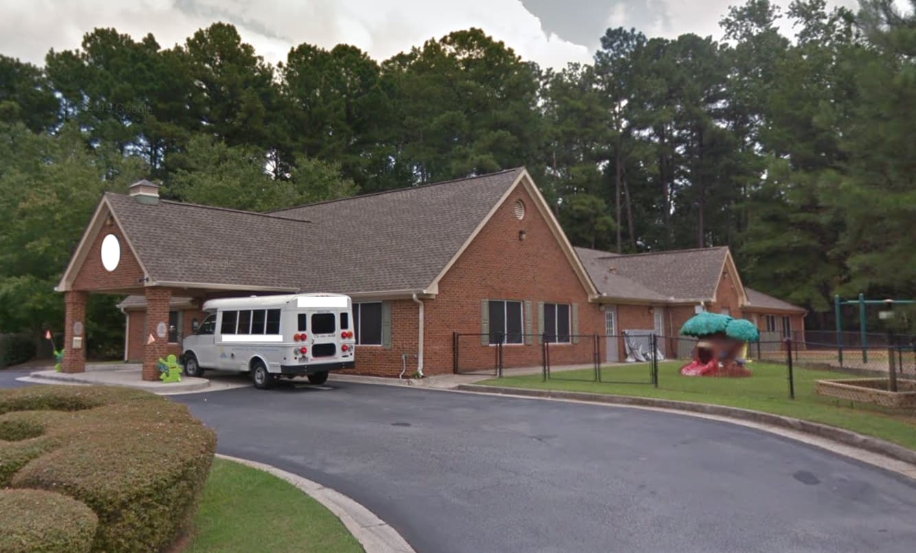

Early in my endeavor but lucked into having a contact who wants a quote for a roof wash. I’m in Metro ATL area. Wonder what kind of baseline pricing would be applicable? Honestly have no idea. Below are 2 images from Google.
Single story asphalt shingle, Needs cleaning but not nearly as badly as most homes I see nearby. GIS data states about 6500 ft² building, but that doesn’t include the drive-thru, roof overhangs, and the pitch seems significant - conservatively if this was an all-over 8/12, that’s at least an 8200 ft² roof. (Google Maps aerial measurement ranges 7400-7700 ft² depending how accurate I try to be, so it’s likely close to 9k ft² roof surface area.)

Chris, I use a per foot base in all of my roof calculations. Obviously the harder, higher, steeper, dirtier, more angles, etc, the higher that per foot price going to be. The one you have here is about as easy as they get. That whole rear area looks walkable and not very steep. Plus it has gutters and doesn’t look like much vegetation to be concerned about. You do need to find out where any gutters drain to. But you shouldn’t have a lot of runoff on that pitch roof. Because of SH price increases I’m never below .25/ft these days and usually higher.
To be safe I’d figure about 60 sq ft per gal of mix. You may get more but I always hedge to the conservative side. Since we don’t have current pics to see how dirty it is, I’m figuring about a 4% mix. With 12% SH that’s ballpark going to give you about 2.5 gals of mix per gal of SH, so you’ll use about a drum of SH plus your soap, which would give you approx 130 gals of mix. As you get more experienced those numbers will get better, but most newer guys tend to over apply somewhat. Anytime you can walk a roof, you’ll use less than shooting from gutter line and the steeper the roof the more mix you’ll use.
I’m not too far from you but not sure of Atl pricing, but I’d be in low $2000 price range. May or may not get at that price, but if you do, should make out pretty good on it. As I said, don’t get much easier than this one.

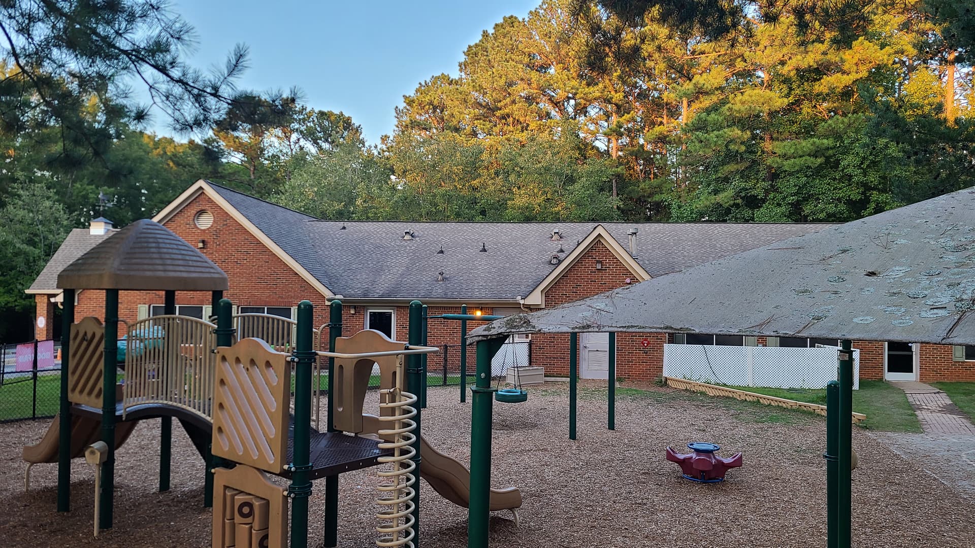

Yes, @Racer that is exactly right. I took some photos on site today, as opposed to the previous photos above from Google Maps. The roof looks to be a bit steeper than it in the previous images. (sorry I didn’t realize the one photo was blurred until looking at it now). But this is at least an accurate representation of the roof’s current dirtiness, at least on the sides I could see to photograph from the edge of the property. I have a call in to get a better look at the NE-facing slopes early this week.
Thank you very much for your estimates on chem use. Without a dedicated softwash setup, this is going to be painful with an X-jet on my 5.5GPM machine with 55-gallon drum tanks. But I have to start somewhere and can’t beat the goodwill of the church that owns this property extending me this opportunity right now. I also guessed around .25/ft so your low $2k-ish estimate makes sense to me.
I also got the chance to quote about 6800 sq. ft of concrete flatwork for the church itself, along with about a dozen awnings and a few spots of the building walls to clean from gutter leaks, and some rust and grease removal from a dumpster pad.

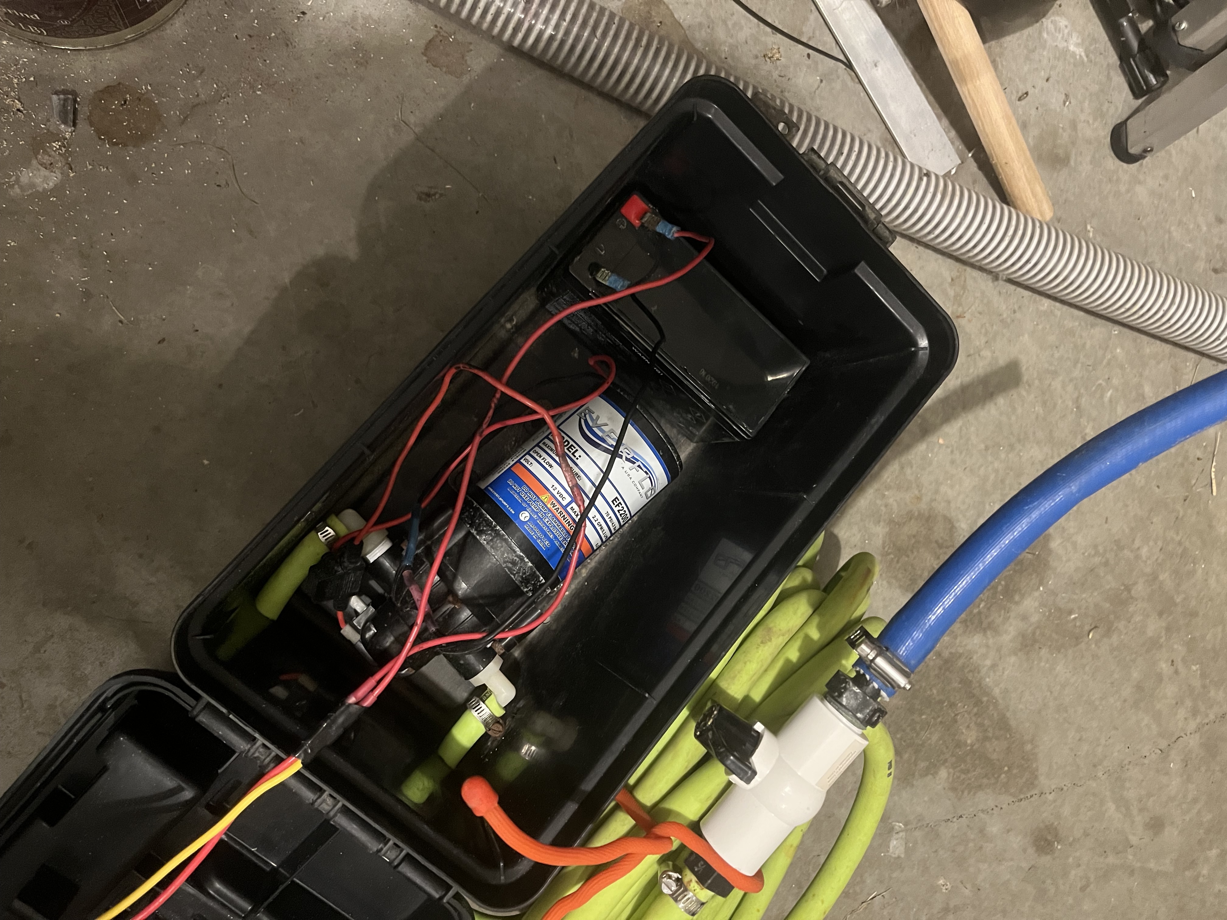

Does an xjet draw enough for a roof? You can make an inexpensive ‘pump in a box’ with a 1gpm pump, 8ah electric fence battery, waterproof switch and some Flexzilla.

That’s not very dirty, probably a strong 3% will be enough. Use the money from this to get you a 12v system. You can build a nice one for less than $700 plus a reel if needed. I’ve got nice 100gal batch mix tank I’ll sell you right if you want to come to Greenville to get.

You don’t have to ‘invest’ anything, my pump in a box cost roughly $150. It WILL do that job, just not as fast as a 6gpm unit.
I currently use it to transfer bleach out of my drum but you just install a cheap plastic Gilmore garden sprayer and go to it. Heck I used it this summer to spray 5000 sq/ft of concrete sealer, works great.
I have a 5.5gpm 12v pump. It almost puts out a whopping 2gpm at the end of the hose. The xjet through the 6.8gpm pump will shoot hot sauce twice as far with almost 4 times the volume… just have to stop and top off the bucket every 10 seconds. Snap your fingers & you’re instantly spraying clean rinse water with the inline ball valve, which is great if you are working solo since the ground guy is the most important player on a roof wash. Pick your poison.
