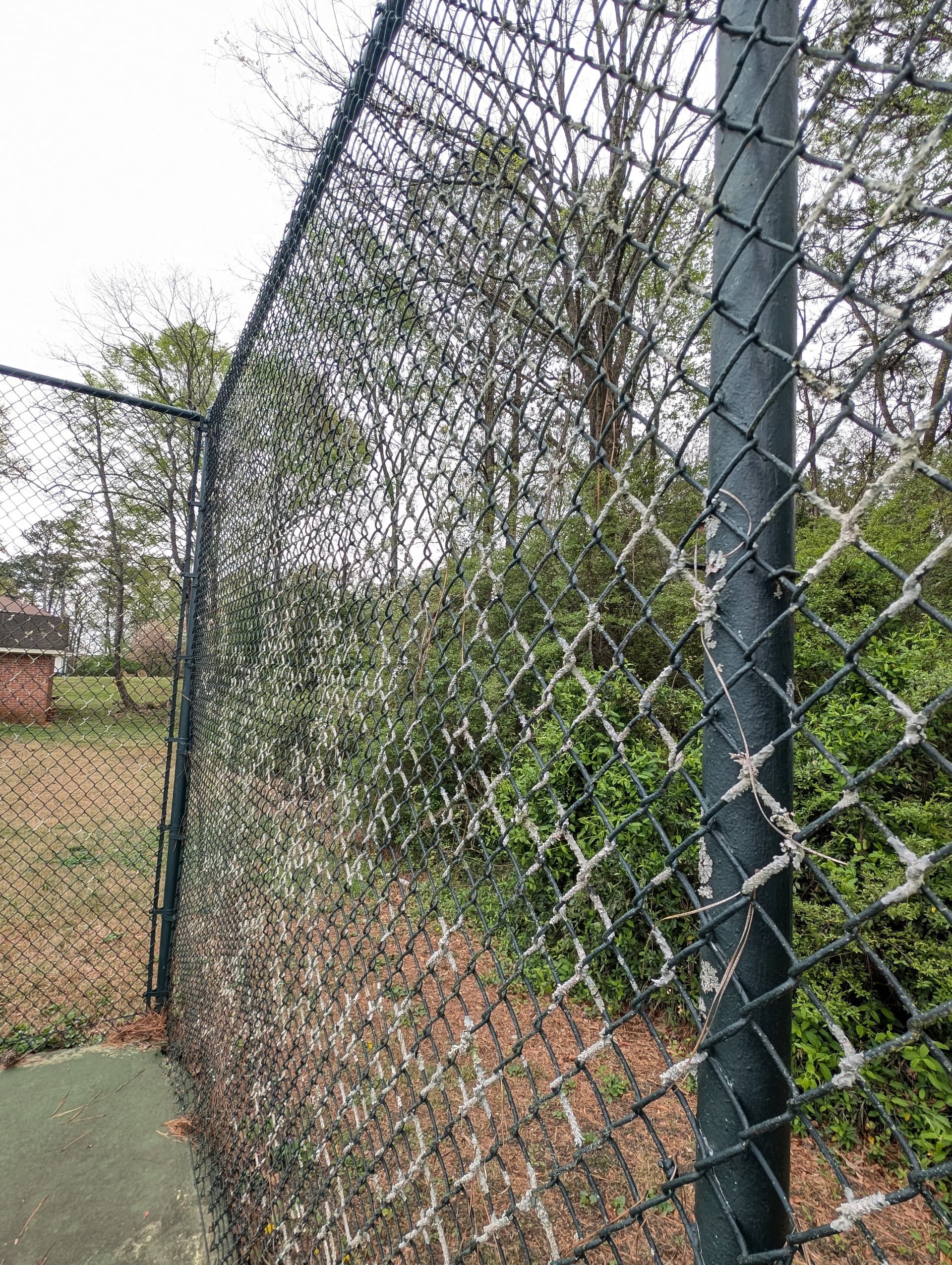

Got a call from a HOA president about removing this Lichen that is covering about 500 LF of rubber coated chain link fence around the community tennis courts.

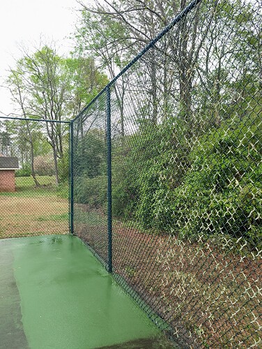

UPDATE AFTER TEST TRIP:
I wanted to give an update in case anyone else comes across something similar in the future.
I went back today to do some testing before providing the quote. Here’s what I tried and what I found out: (Sorry I was adjusting my mix on the fly with my 12v bucket sprayer so I don’t have exact ratios.)
Straight Water: - Used varying nozzles and pressures to get a baseline and using straight water would have taken a week to complete this job.
1% - 2% SH mix, surfactant, 15 min dwell: - Didn’t seem to have much more effect than straight water.
3.5% - 5% SH mix, surfactant, 15 min dwell - This seemed to be the sweet spot. I didn’t want to go this high because of grass and other shrubs around the fenceline, but I also didn’t want to be out there for a week and they don’t want to pay me to be out there for a week. I soaked everything around the test area before and after. This ratio seemed to loosen it up enough so that I could quickly spray it loose from the fence. I used 25* and 40* nozzles to test efficiency, but to my surprise, the most effective nozzle by far was my XJet nozzle. The lichen didn’t seem to care about how much pressure you hit it with but the amount of focused water that I could put out with the XJet just blasts it right off. It was also clutch for changing pattern on the fly to hit the high up spots (12’ tall fence) and then wider pattern again on lower areas. Something about the amount of water flow from the XJet made it go so much quicker.
Hot Water - Hitting it with 180* water didn’t seem to make any difference at all, except melting the coating on the fence. I didn’t figure it would help but I wanted to test everything.
Brush - Way to difficult, even after a SH soak and incredibly exhausting. Not effective in the least.
Some areas of the fence that have an extreme amount of lichen needed to be sprayed from both sides of the fence because it’s wrapped around the fencing like coating on a wire.
There are a total of (48) 10’ x 12’ sections and the really bad ones took about 30 minutes each with dwell and rinse. Luckily only about 18 sections are really really bad. That time should come down a bit with a system in place but it’s going to suck regardless.
My setup: 8gpm 3000psi Karcher Hot Water setup. I also have a 4gpm Predator for difficult to access areas but I didn’t even bother bringing it to test on this.

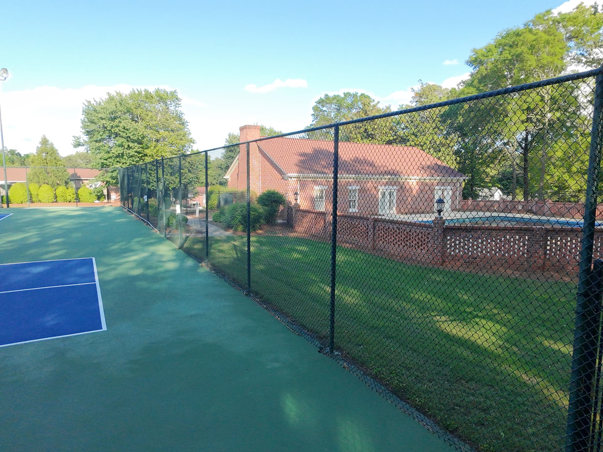

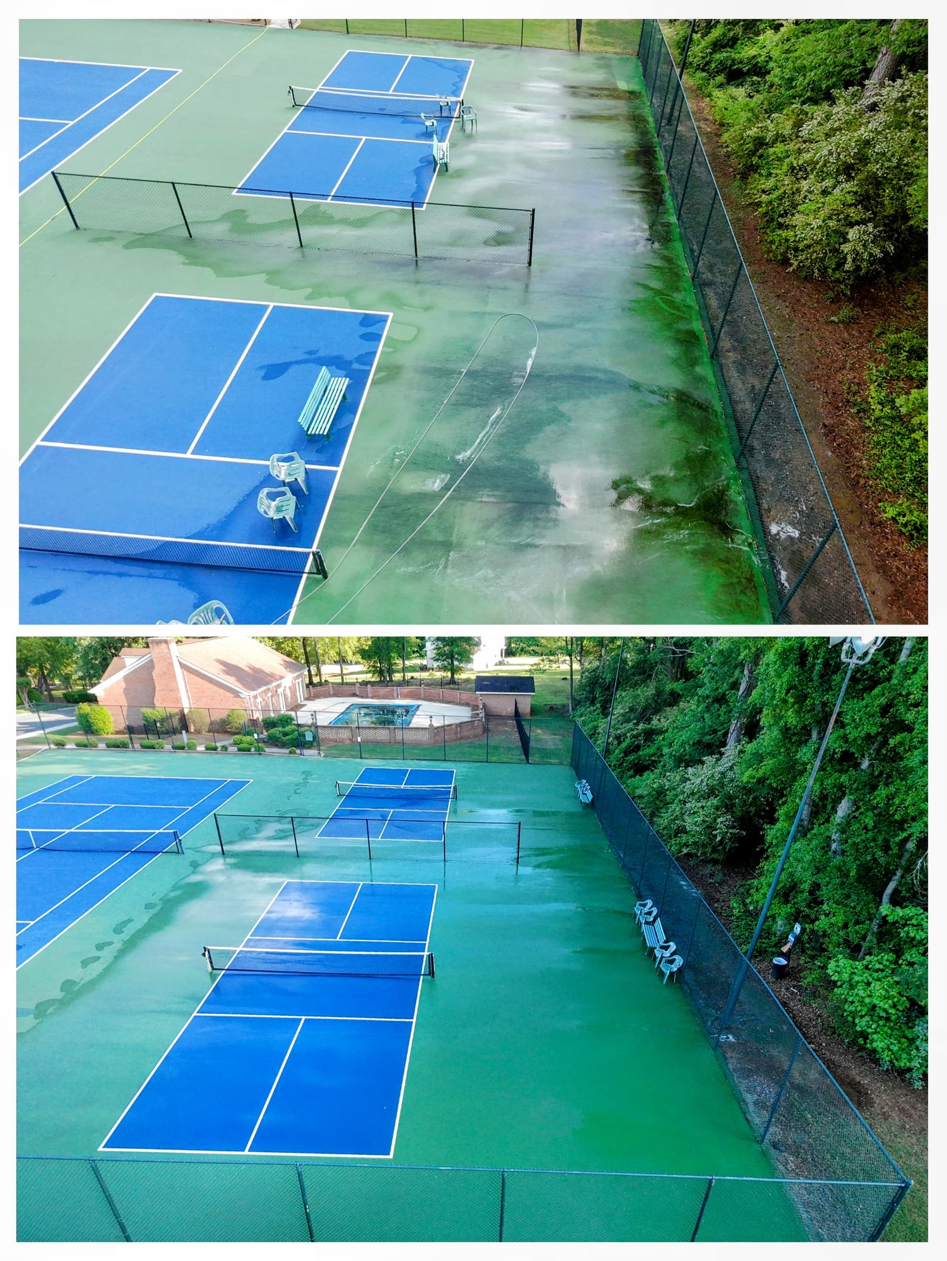

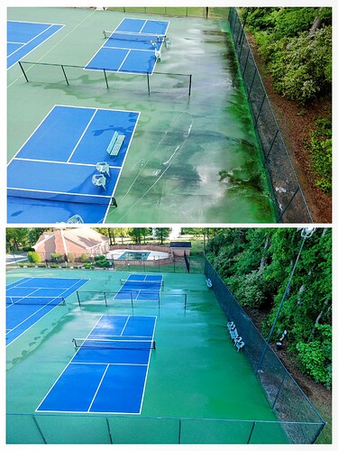

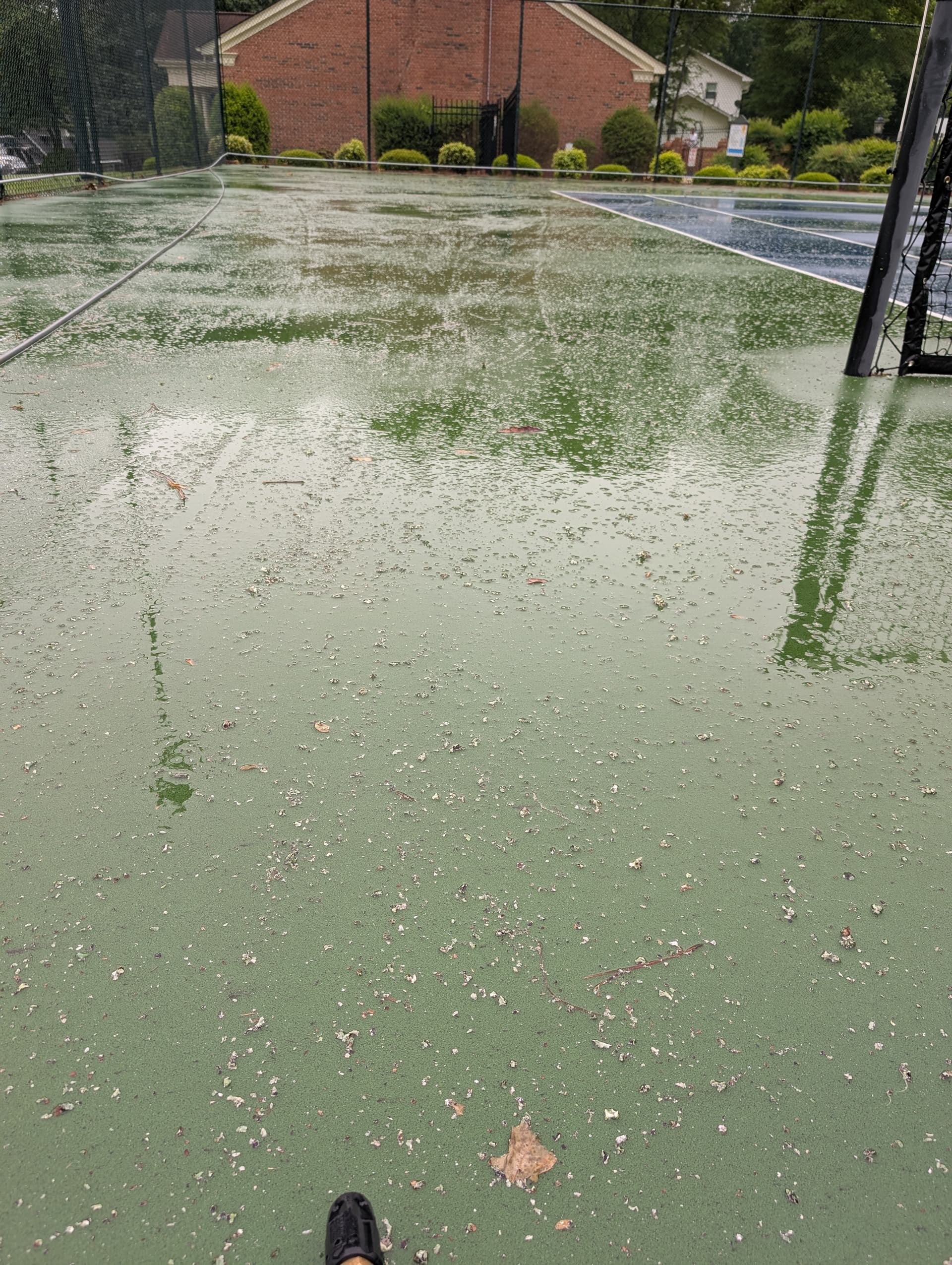

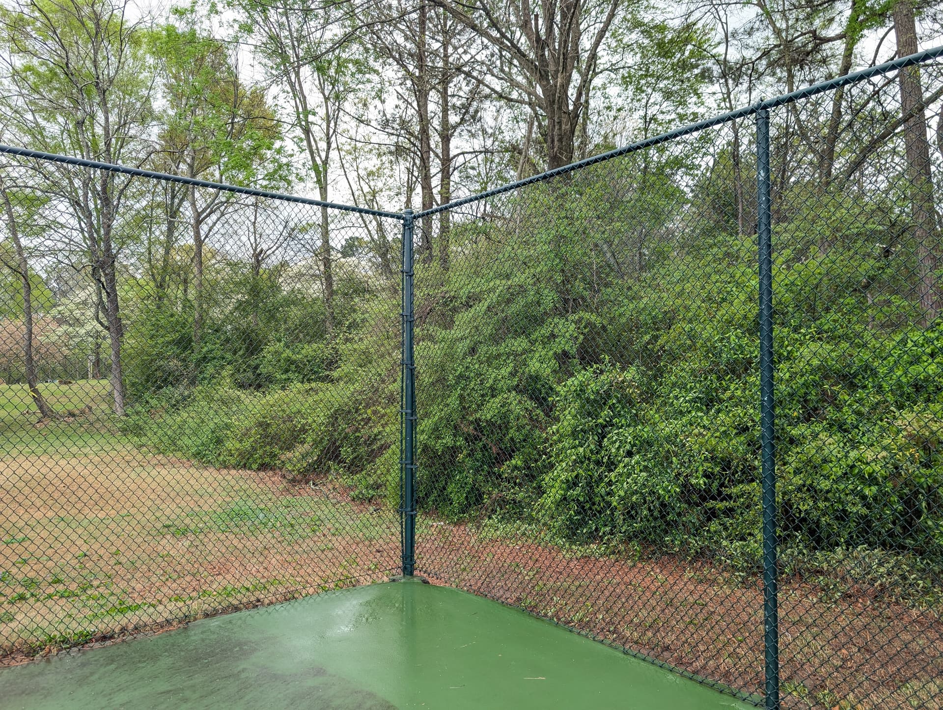

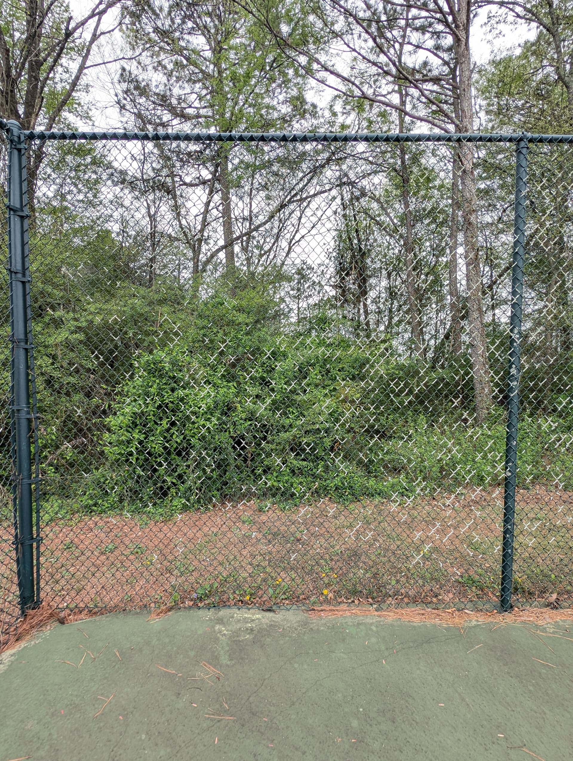

Picture of test area. (Yes I also rinsed a section of the tennis court in the area I worked so they could see how bad that area looked. One side of the court is under a tree line and it’s completely black in areas. Now they want to add a court cleaning after the fence is done :grin:)

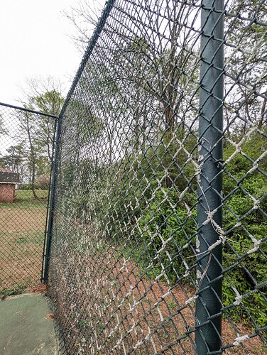

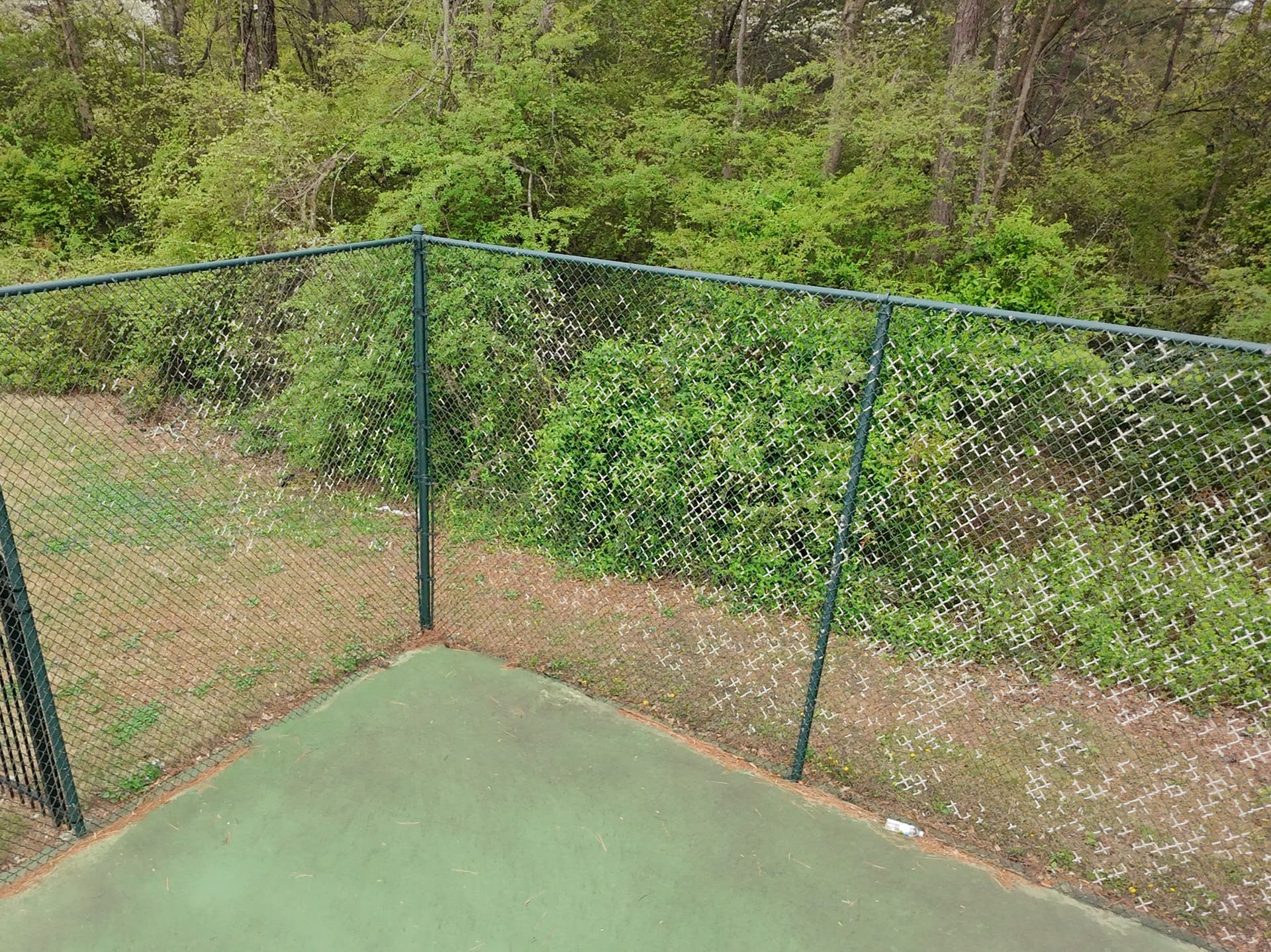

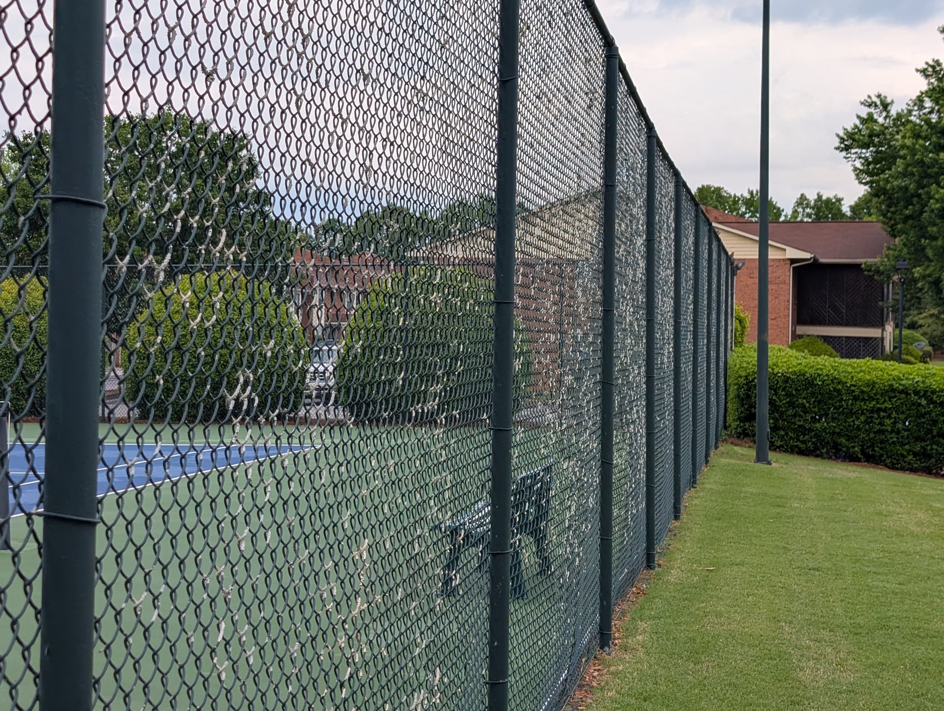

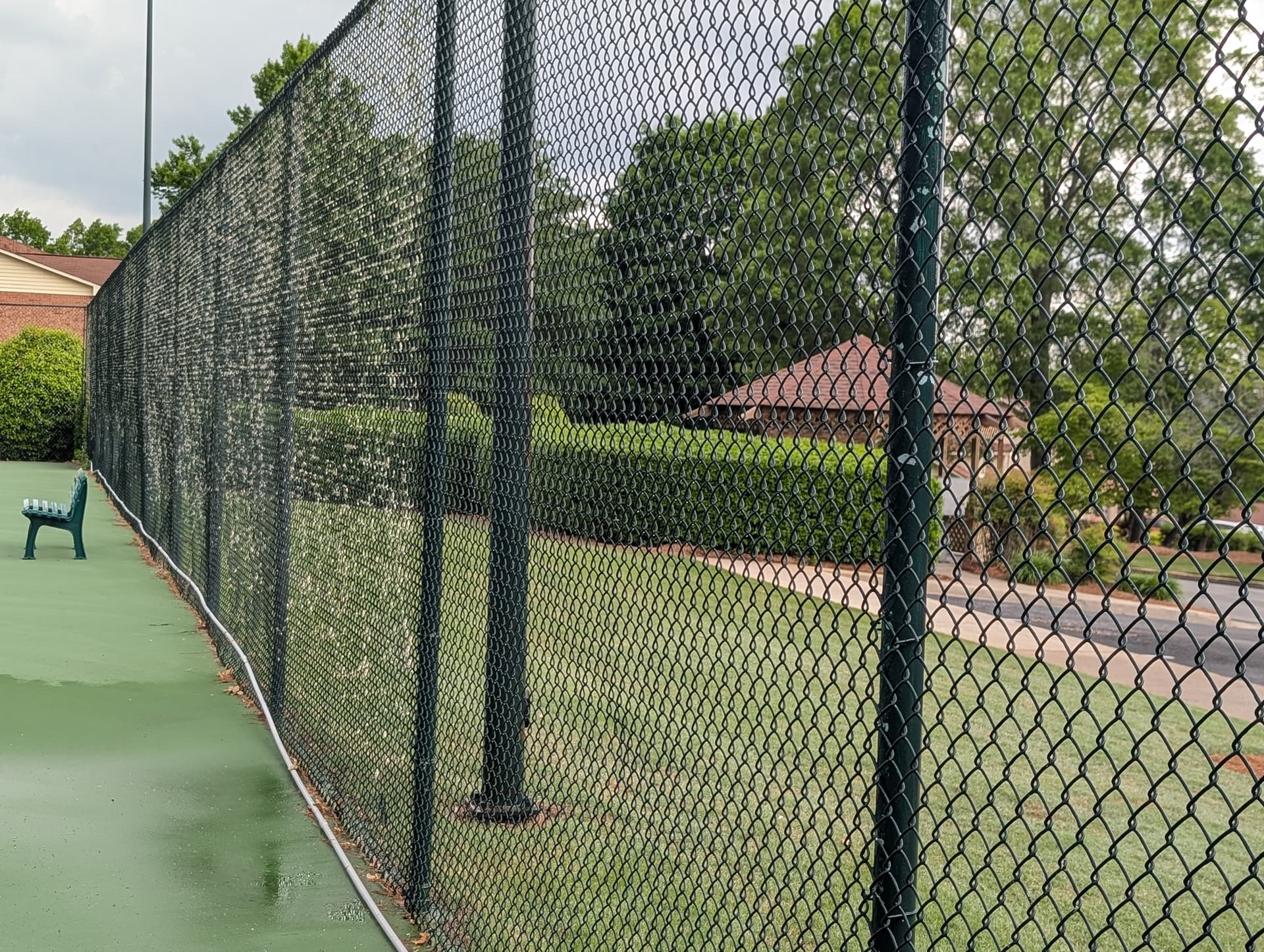

More pics of what it looked like before:

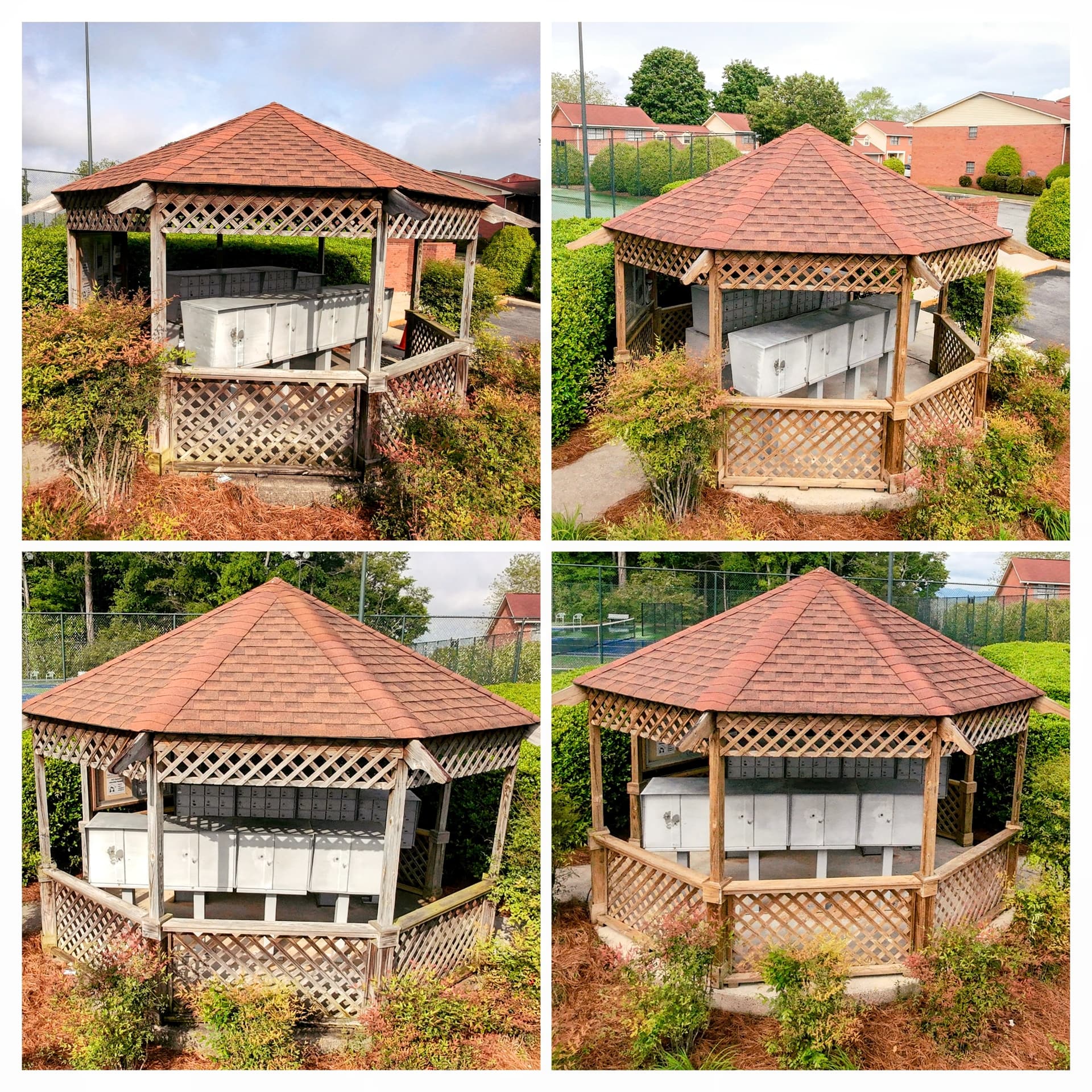

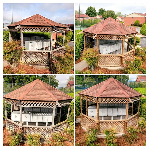

The entire job, including a mail center gazebo, and softwashing of half of the tennis court (the pickle ball side) that was covered in black organic growth from overhanging tree canopy, was a total ■■■■■ and I wish I had charged more. Another lesson learned.
First off, I was pulling water into my buffer tank from the community clubhouse and the water pressure was so poor (I didn’t flow test it beforehand) that I actually had to run a 2nd hose from the pool area running directly into my buffer tank. With both hose valves at full open, it still couldn’t keep up with my 8GPM. I was running wide open non-stop for this because of the nature of the work, so I still had to take breaks and let the buffer tank top up every hour or so.
In regards to the method I used to clean off the Lichen, I stuck to my original idea from testing and used the old XJet nozzle so that I could adjust stream as needed for the top portion of the fences, but I quickly abandoned the usage of any chemicals. Chems were a complete waste of time of time and money in this situation. I realized that the SH wasn’t actually helping. I didn’t want to waste the time to give it enough time to dwell and attempt to kill any of the growth, and since the fence is chain link, only about 5% of what I was spraying was actually sticking to the intended target. So, I just ran full bore about 6 hours the first day and about 2 hours the second day and got it all knocked off. The lichen was wrapped around all sides of the “chain” so I had to spray from both sides and both directions (at an angle) to fully get it off. Like I said, it was a ■■■■■ and took a while to perfect the technique. The amount of lichen chunks that were blown onto the courts was UNREAL. I attached a pic for reference.
The Board and the residents were super stoked on the outcome. The fence had been like this for years and they couldn’t find anyone to come out and clean it. I suspect the previous Board President was too cheap to hire a legit person to do it. The lady I dealt with was the new President and she was motivated to get ■■■■ done, thankfully.
I’ve already been called back out to quote several other projects around the property with some big projects being discussed for later this year. So, all in all, this ■■■■■■ little ■■■■■ of a job is looking to be a good long term relationship.

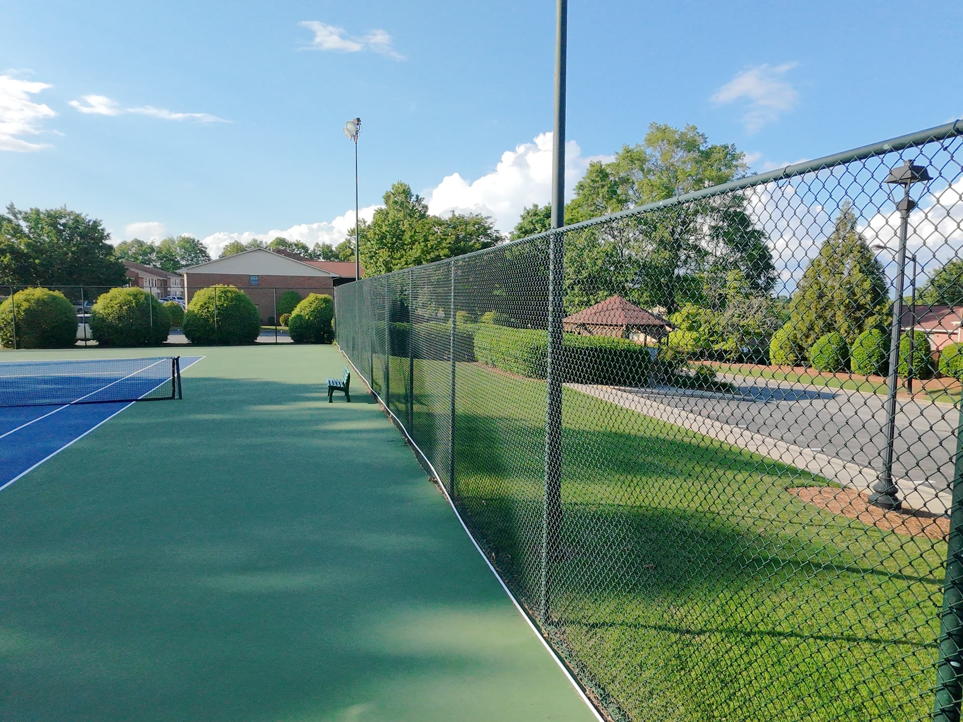

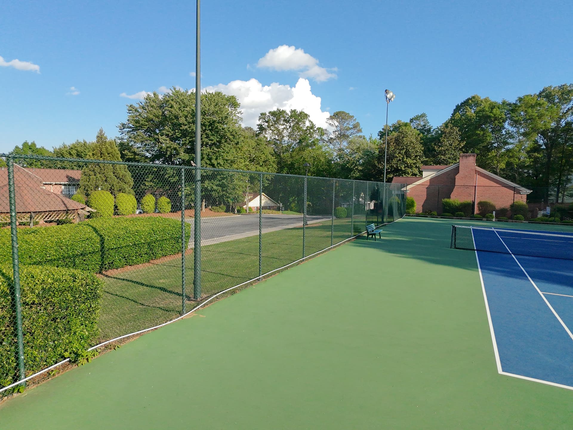

Here are a couple of pics of the finished product. I took a ton of drone videos and pictures but again I haven’t had time to put together the before / after video yet.
