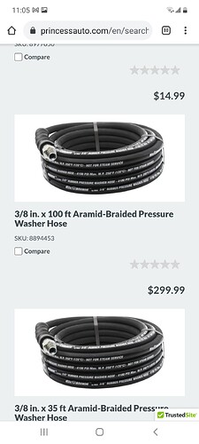

Supplier has these back in stock now:
My 1-wire burst today so now I am running 200’ of Kevlar hose, it’s so much nicer.

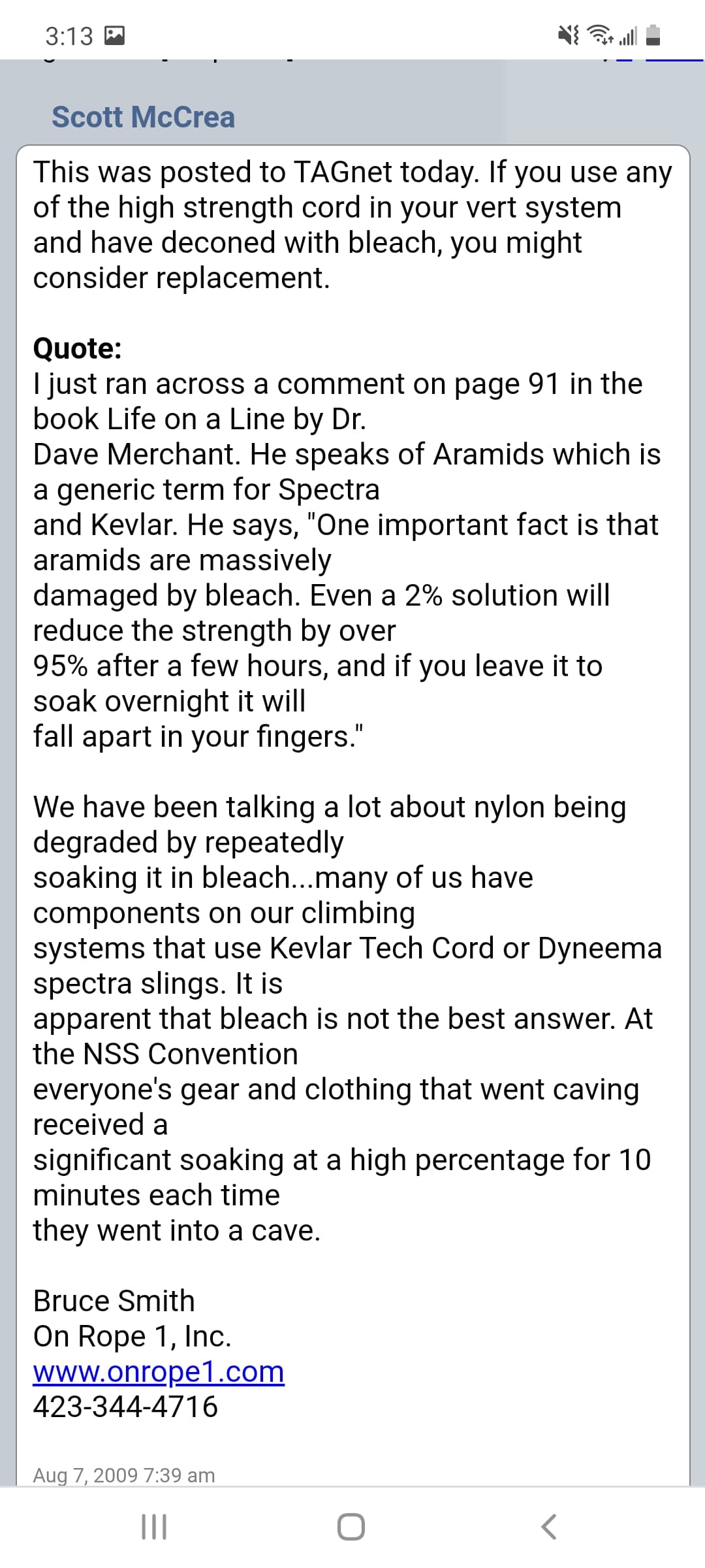

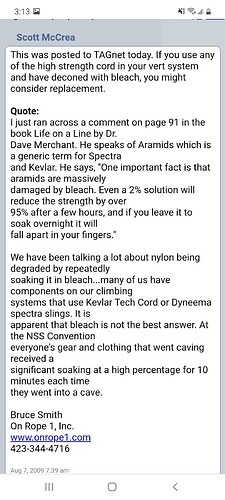

Okay, as many of you may know I don’t downstream anymore I use my diy xjet, so chems in hose isn’t an issue for me personally. However, with my experience in carbon fiber poles, I do remember that cf is bleach resistant but Kevlar is not. (Some WFP use Kevlar in the base section to insulate against electricity)
Now, having said that, steel wire is susceptible to bleach as well and it rusts, which Kevlar doesn’t.
So, I don’t know how the hose is constructed, perhaps the Kevlar is between layers of rubber??? Does it react the same as steel wire to bleach?
I don’t know, but I can tell you that my steel wire hose burst today because of rusting, and my Kevlar hose is still going strong.
