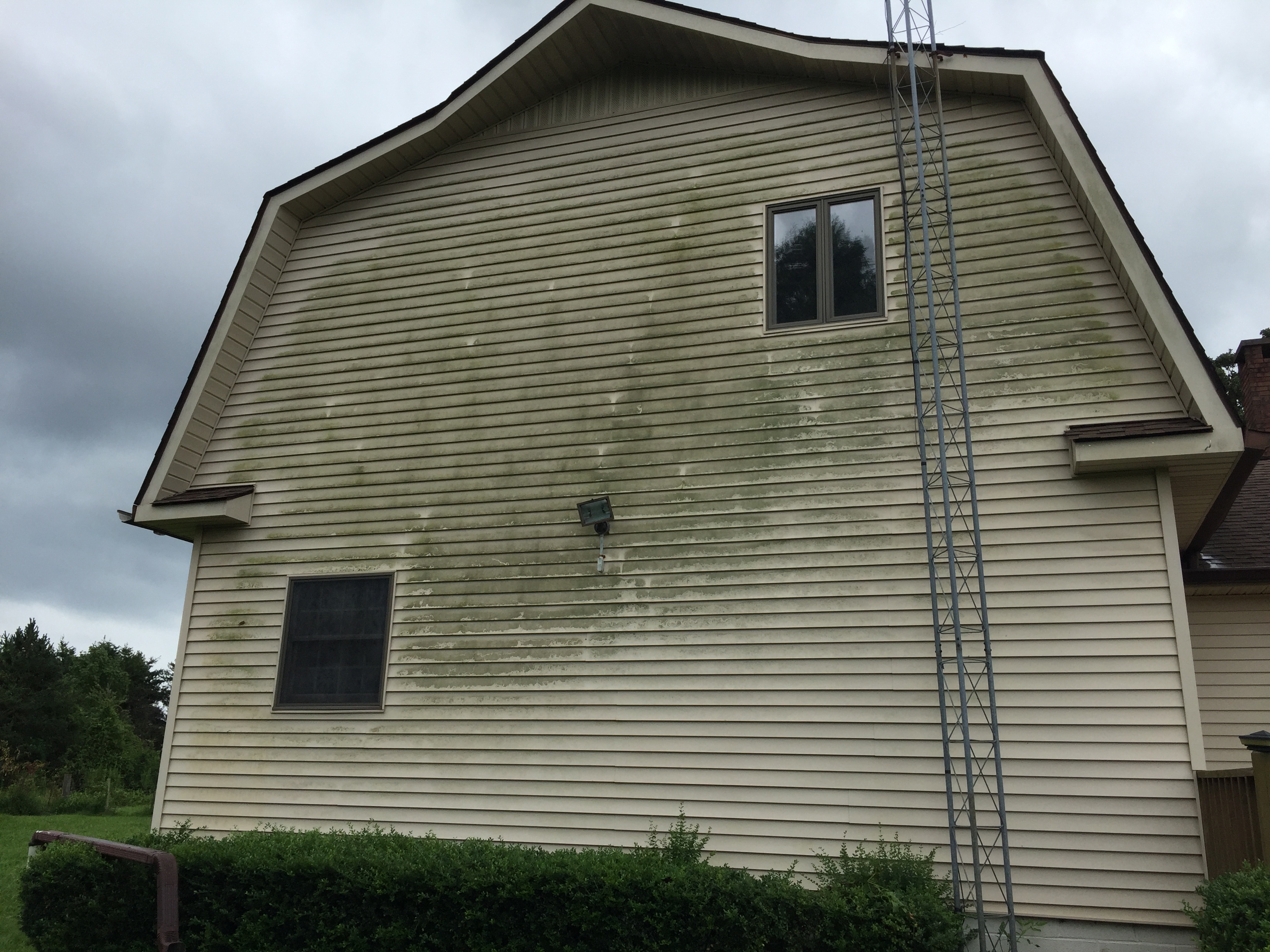

Yeah for sure, definetly need more practice. But I feel like I can finally start practicing cause now it’s starting to work, I ran five gallons of liquid chlorine 10.8 (usually have 12.5 SH) and I used 21 ounces of snotmenade and it literally tore threw the dirt.
My only problem now is that I was spraying to straight up and I guess water got stuck in behind the vinyl and bled out as it dried. See picture below. I was told to stand back more and to not hit under the vinyl or go against the vinyl. I had to go back and wash this off but in the end… It was done man! My first real successful house wash I would say. Definetly could have gone faster but I’m not worried about speed right now. My pricing needs to change I charged three townhouses that were connected 240$ each for house wash and exterior window cleaning with screen cleaning and a driveway wash off (just sprayed the dirt to the street nothing special)

Seeing this article, this may have been part of your problem. Do you have hard water up there.
http://www.powerwash.com/articles/hard-water-silent-pickpocket.html?utm_source=PowerWash.com&utm_campaign=776fb933be-EMAIL_CAMPAIGN_2018_05_18&utm_medium=email&utm_term=0_704325067b-776fb933be-175900549&ct=t()&goal=0_704325067b-776fb933be-175900549&mc_cid=776fb933be&mc_eid=1e0cf95c98
Yeah we have some hard water but I test the water before I use it. I have a waterfed pole system that came with one so I’m always checking. This house had fantastic water. I think your right though I went back and hit the spot that had dried with just water and all of that stuff came off. I need to stand back and hit at a more straight angle and then make sure to wash again if need be, those streaks are from holes in the vinyl that get rid of water I’m fairly sure. The soap was the reason racer thank you, it wasn’t clinging to the surface allowing the mix to do its job… Now it sticks right to it.
