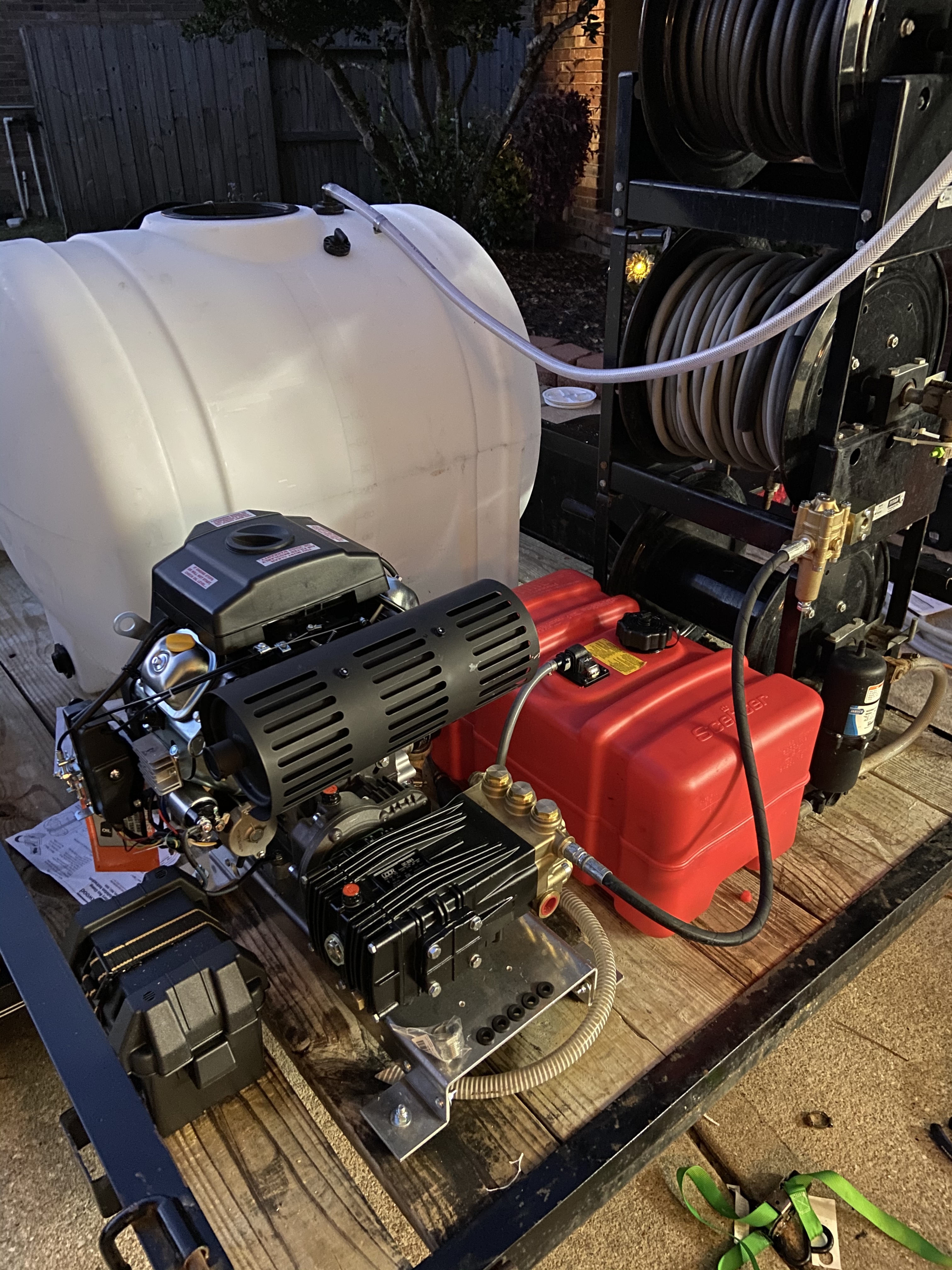

I’m building a gear drive 8 gpm, 3,000 psi Predator. It will be my first build. Hopefully it’s straight forward.
@Clean_Blue it’s all just nuts and bolts, you’ll be alright.
Wow, I can’t believe how compact and clean that looks. A lot less clunky than a belt drive.
Can’t go wrong with a geardrive.
I feel really stupid asking this, but if I wanted the water feed line switched to the other side, is it just a matter of swapping the plug?
Yes you are correct, the two ports on top of the manifold are your high pressure outlets and the two on the bottom are the both for supply/suction. Left or right your choice
Perfect, thanks.
@dcbrock not a stupid question at all, most of the well known pumps are of a symmetrical design, meaning plug up one end and use the other and vice versa.
