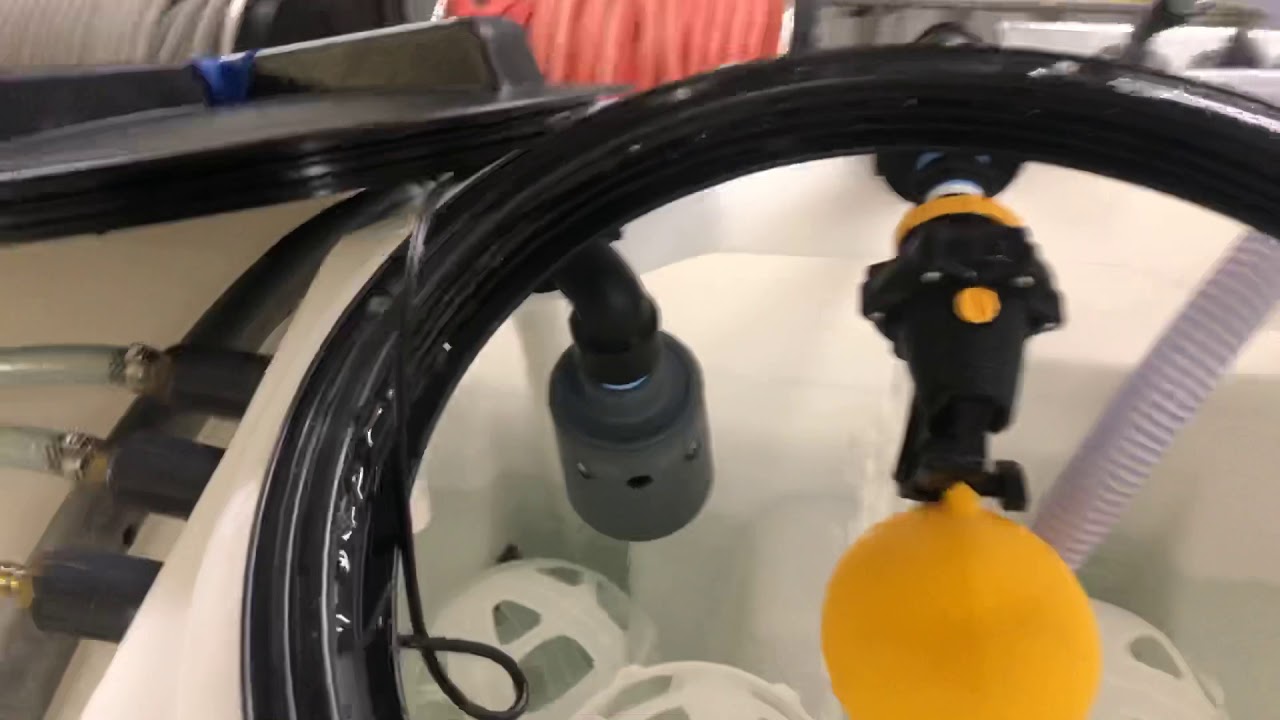

I’ve had this one in my cart for a while, it’s gone up $10 since, but it allows much more flow. Less restrictive.
Here’s a video explaining the difference between Hudson and the Jobe and a link where you can buy it
Jobe Valves J-TPV20DLT Black Topaz Valve with Detach Long Tail, 3/4", Yellow https://www.amazon.com/dp/B007OV5QRK/ref=cm_sw_r_cp_api_glt_fabc_F7WGF2CVYEHQHB747QHC?_encoding=UTF8&psc=1
This looks awesome comparatively but I’m kind of surprised it’s never been mentioned as an alternative to the Hudson float valve. Would be good to hear from someone who has used it in their tanks.
I used to use one until it got clogged up. Since then, nothing. Unless you’re running in an enclosed truck or trailer, who cares if it over flows?
I saw it mentioned on Facebook. There is a revolt against the Hudson growing slowly. I don’t like their flow either. This new style is said to have the best flow and allow your tank to fill higher.

I use this float because it allows my 55 gallon vertical tank fill a little higher.
When I used to operate a hydroblaster, we used Jobe valves in our tanks. We ran off of a hydrant usually because the machine uses 50 gallons per minute. The Jobe valve easily shuts off a high pressure hydrant running at full open. They are rugged as heck. But much more expensive than a Hudson.
Looks like a really similar design so I’d say flow is the same obviously less durable but my biggest issue is someone said the bolts aren’t stainless and were rusting… I guess not the end of the world for an 8th of the price but still
Oh, its definitely less durable. But I do 99% residential and basically all of them are on wells so I dont worry about to much incoming water pressure. I installed my first one at the beginning of last season and its been great. I changed from the hudson float valves because of so many solids in our water, it kept clogging the internal filter. Yes i could have just removed the filter, but i figured there was a better way.
