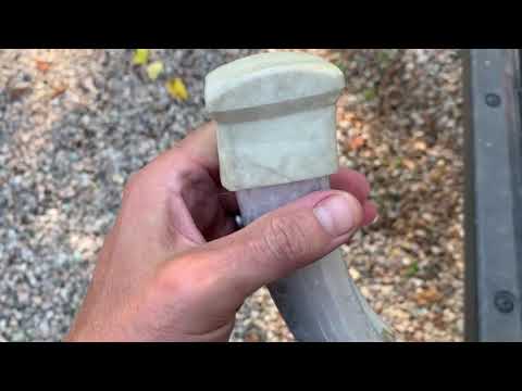

I put “ladder balls” on those standoffs, they help a lot.
We use tennis balls

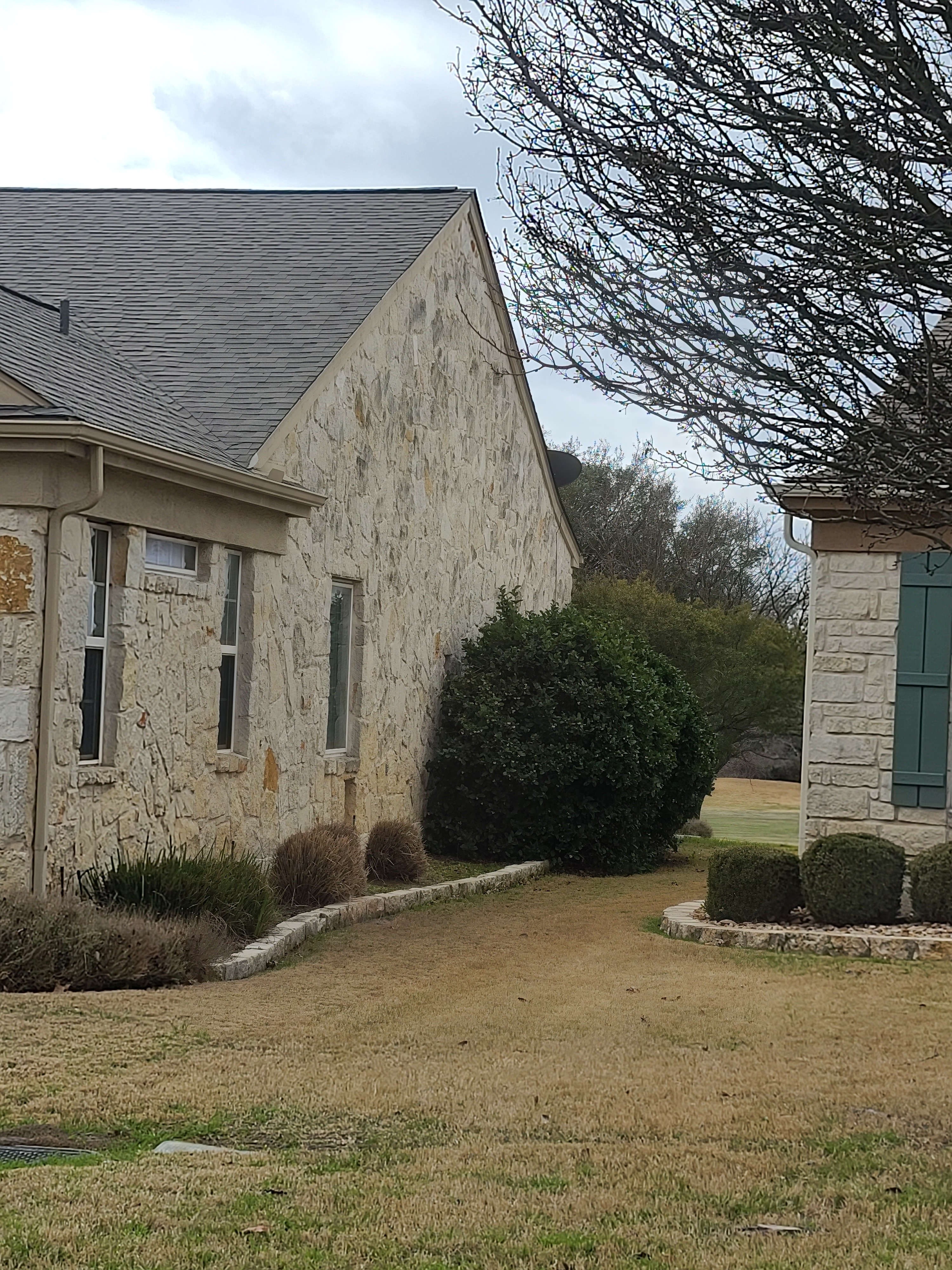

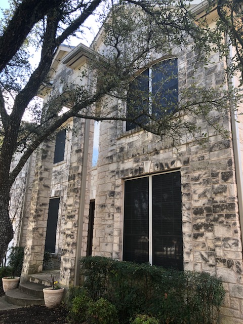

Hello all, I could use similar advice on plant protection with SH.
I just received request for these two homes. I’m planning on multiple coats of 50/50 SH (or hotter) with plants just below.
@TexasPressureWashing do you think gypsum or plant wash would be good for this? Put it down before, after, and between costs?
@DJPWS how about your sodium thiosulfate?
Or @Bigbendwashpros how about agent clean neutralizer?
On the front of that bad one, I’d hit with the plant wash and cover those, but where you really need to be concerned is where it runs down the wall into the ground. I’d saturate the ground pretty good with the plant wash for about a foot or so out from wall.
Thanks Racer. I’m concerned about the runoff too. Gonna need to shimmy my way behind the big hedge on the side to get some plant wash down.
I agree with racer
Agree with Rick. He’s who I call when I run into something research doesn’t make clear. @Racer thanks again for your mentoring.
Concur with @Racer, soak the soil.
The sides don’t look too bad. Heck strong HW mix may get most of it. Make sure you carry a good spray guy with you and don’t bid it cheap just in case you have to buy a bush or 2.
What is this spray gun you speak of?
