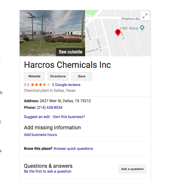

I pay $285 every two weeks for 110 gallons delivered. You can pick up 55 gallons at a time for under $2/gallon
