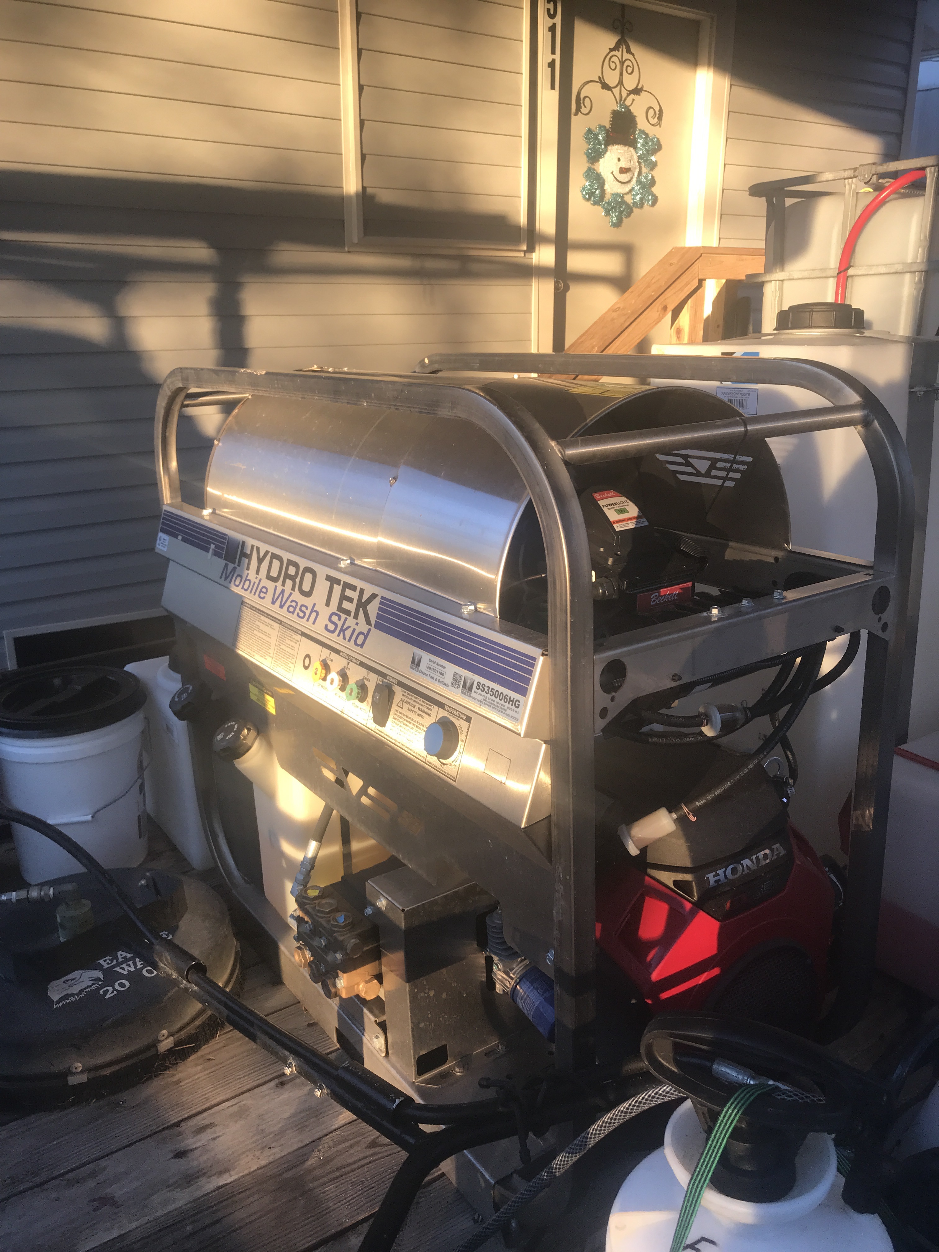

I’m loving my hydrotek. It gets hot fast. I’m sold on them. Mine is 5.5 gpm but it has a 546000 btu rating. I’ve had landas and they’re great but I’ll put hydrotek up against any of them for the dollar value
They will but I just can’t justify the extra cost if I can get a machine to perform close to it even if it doesn’t last as long. Maybe in a couple years when I feel like dropping 15k on a single machine but I don’t finance anything for my business and that’s just going to dig a little too deep into my savings than I would feel comfortable doing right now. I’d rather save the extra and put that towards marketing.
That makes me feel better. The 5.5’s are supposed to get even hotter than the 8’s but I’m so spoiled with the extra volume that I’m miserable using anything less.
If we don’t build another trailer this summer I’ll probably upgrade this one to an 8 gpm just like it. I got mine from Shaun at the power wash store in Nashville and have been extremely pleased with their customer service. My 8 gpm cold water unit has me spoiled to. I have a k7 unloader on my hydrotek and love it so much I’m going to put one on my water dragon
She’s a beauty!! Love the SS frame

Thanks. Me to. Even though it is a 12 volt system it was worth it for the smaller footprint. I just make sure my battery stays hot. I’ve never had a stainless unit before but I like it
