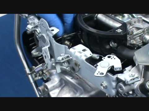

ill try to take a pic of the linkage of my 690 later for you. theres a vid on youtibe on how to set the carb gov. Maybe try it.

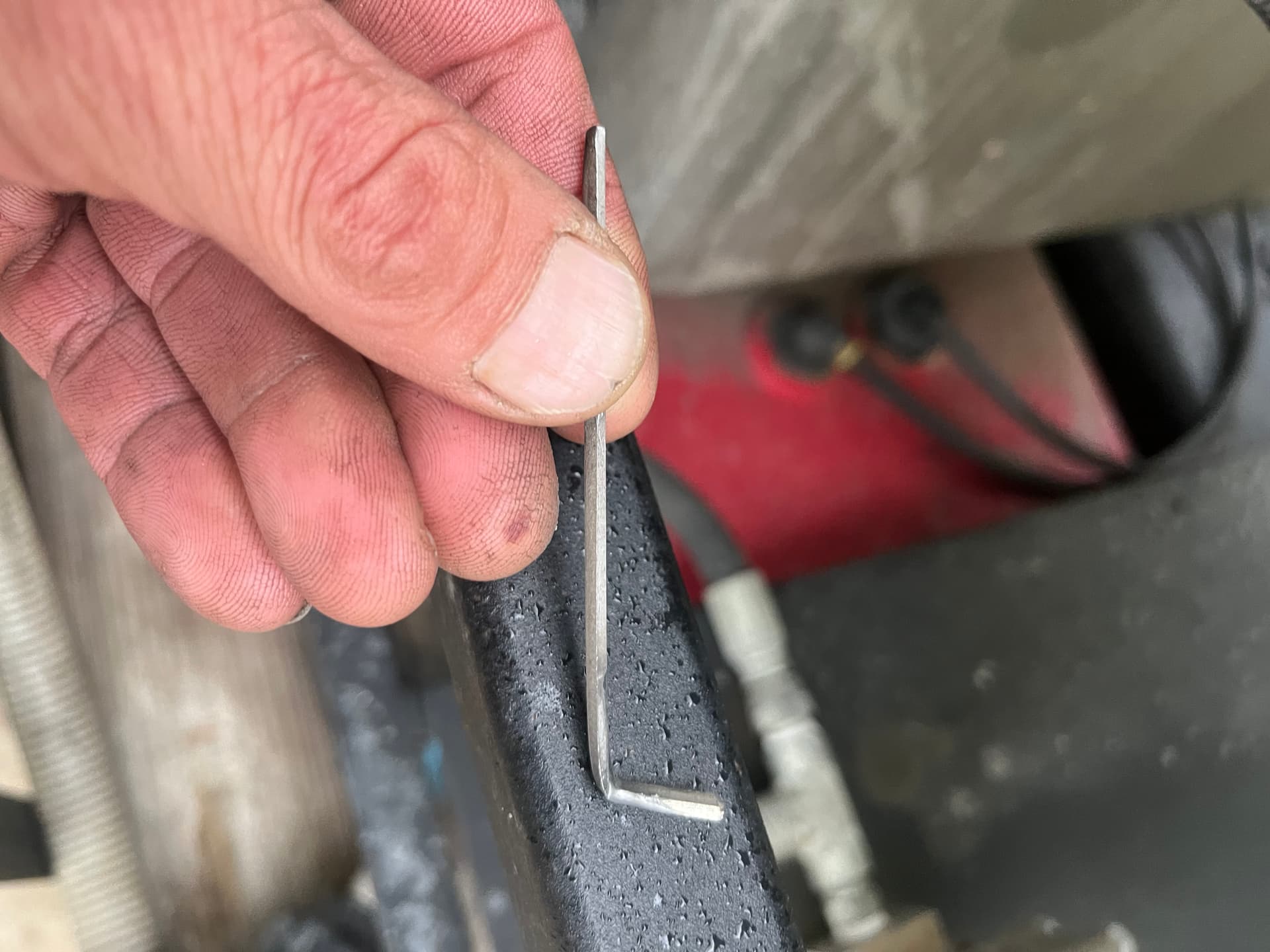

Update - I pulled a diagram off the web for the linkage and checked that all springs and cables are properly attached where they should be. All springs are in good shape and everything appears to move as it should. This picture shows the flat piece I was talking about - it was stuck into the throttle control level with the long side just resting on a cable holder not really doing anything - lever still moved freely. I took it out and it seems to be a forged aluminum piece that looks to have been broken on both ends as they are rough and uneven but I can not find where it came from -
I just spent ten minutes looking all over my machine and I didn’t see anything that even resembles that piece. Maybe a tool they use at the factory for assembly and they left it in yours? That’s my best guess.
never seen that either. Iooks like Allen key
In my retail days I don’t recall seeing any squared linkage rods like what you have pictured…they were all round. I agree with the others in stating that it looks like an allen key of sorts - a poor condition one btw.
Not an allen by any means. Just a forged aluminum flat piece of metal - after an exhaustive research appears to have nothing to do with the engine but strange it ended up in one on the holes of the throttle lever but again was just sitting there not doing anything. Didnt restrict movement of lever, just there.
